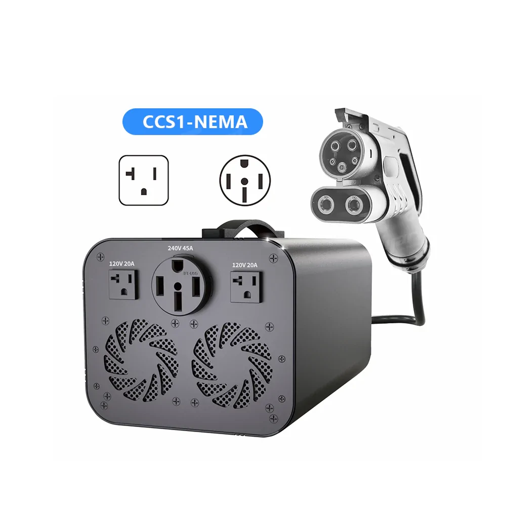

Would something like this work on my 2023 R1S? It's rated at 10KW. What's the max I can draw from the R1S? It says the input voltage is within the 290–450V range.
Rivian Tips for using Rivian as power bank for storm {filename}
The Rivian doesn't (yet?) support backfeeding power out of the charge port, so this won't do anything. The only output is via the 120v outlets and the 12v cigarette port.
As @beatle said, until Rivian gives us an option to export power from the charge port this won't do anything for you, but would you mind posting the link to that? It's exactly what I want when Rivian does turn that function on. I don't need V2H, but V2L would be huge for me...

Here it is. It's expensive compared to a generator but silent so that's a plus.
https://tlyard.com/products/10kw-v2...s-nema-standard-tlyard?variant=57550938407293
Thanks, but yikes - That's way more than the $499 I was thinking it might be! As I was looking for it I found some other options that I'll go back and find and post here. I don't need the 220v output so I can probably go with something smaller (and less expensive). My use case is camping and tailgating 10-12 times a year. I currently use a Bluetti AC180 (1800W) to get me through the 1500W limitation of the R1S. We still have to wait for Rivian to give us an option to have the juice through the charging port go the other direction. Hopefully that will come out with the R2 release...
