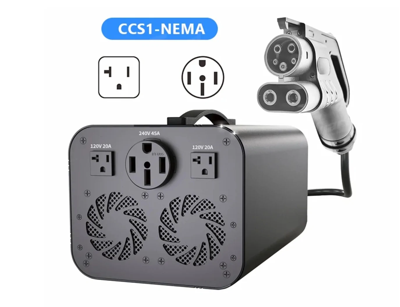

I'm wondering what you have used this for. The website says
"The 14-50 outlet provides pure 240V (no neutral) and is not compatible with RVs or systems requiring split-phase 120V/240V power." That seems to me to imply you could not use it in a V2H scenario, since all the 120v circuits in a house require split-phase.
I have not used it myself. Apparently you need to add this box (https://tlyard.com/products/tlyard-v2h-power-converter-for-tesla-powershare) to create split-phase 240VAC so it's even more expensive. I was hoping that the solution would be closer to the cost of a similar output generator, about $1000. Anyway, hopefully there will be more options for devices like this as more EVs allow V2H/V2L ability.

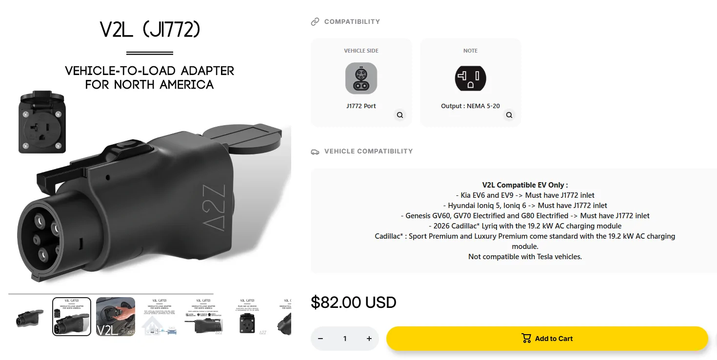

A2Z (whose products I really like and trust) has a V2L Adapter:
Rivian R1T R1S Tips for using Rivian as power bank for storm 1771096109895-y6
Obviously not currently compatible, but it says it goes up to 20A which would allow up to 2,200W. For $82 it would be one of my first purchases as soon as Rivian allows it with my Gen1.
The one thing that scares me about all of these options on our R1S is how far anything in the J1772 port on the Rivian will stick out when it's plugged in. I'm not too concerned when I'm camping, but when tailgating at a football game we get people walking between the cars all of the time. It would take only one person who's not paying attention to walk into that "lever" that's sticking out and snap something off. At least with the R2 it would be near the tailgate...
2200 W isn't much of a step up from the 1500 W the vehicle already provides. Hardly seems worth it unless you have a very specific need.

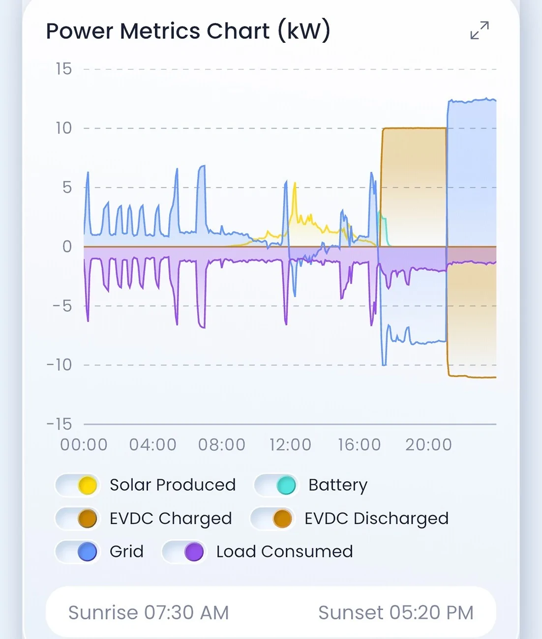

I know most of you have seen True_Dad's video, but would folks like another video of a gen1 R1T and SigEnergy? I'm not generally a video making person, but can give it a go?
I'm on net metered time of day billing with my utility, have high tariffs 5-9pm weekdays, and cheap nights and weekends. The charger is set to not charge outside of nights and weekends. It automatically wakes up and charges when the Riv's plugged in and below target start of charge and it is cheap power time. I could have it plugged in all the time and do "peak shaving", but it's awkward being always plugged in. So instead a couple times a month I'll plug the Riv in at 5pm, toggle the SigEnergy system to peak shaving with a max ~10kW discharge rate, and let it run the meter back for four hours. Then it auto switches over to fill the Rivian back up when 9pm rolls around. In the morning I unplug it and go back to a normal routine, charging as needed. I end up with net 0kWh used in the expensive 5-9pm period and only charge the car during the cheap time. This is giving a pretty good monthly savings.
I've just got the small SigEnergy battery with it really intended during an outage to just keep the SigEnergy stack alive long enough for me to plug in the Rivian and get it discharging. This works out similar to having a generator to plug in and turn on. The generator's just R1T shaped.
The system hasn't seen a summer yet, but given how the solar (modest ~9kW system) is performing on clear, short winter days, it seems like between it and the Rivian's max battery we could run our house indefinitely during the summer "off grid", including powering our little Chevy Bolt.
The only thing in a home that I can think of that will run on 240V with no neutral is a well pump. Well pump motors only have L1, L2 and ground, no neutral.
