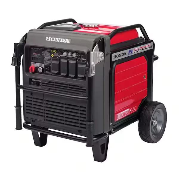

Unless it’s a really dinky generator it’s probably less dinky than the Rivian inverter output. If it’s something like a Honda 2000 it will run part load for 40+ hours on a 5 gallon gas can. Fill a couple with some ethanol free gas and rotate them out once a year and you have a simple, reliable power source without draining charge from the vehicle.
Yeah, I bought such a battery before I got my Rivian. It worked okay, but the constant racket it made was annoying. Being an adventure vehicle, the Rivian knows to keep quiet and not disturb anybody 🙂
