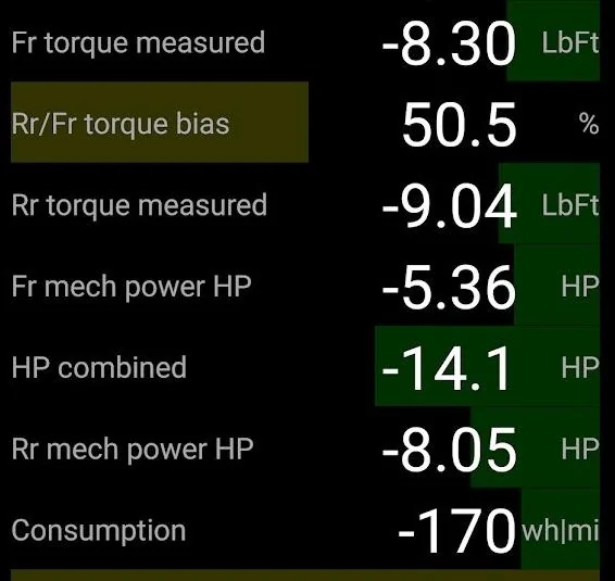

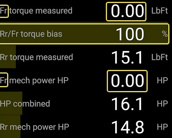

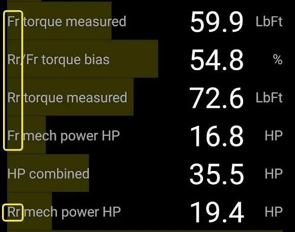

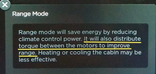

On my 2017 Model X, I have 'range mode' that biases the rear over the front and I use it for road trips. Not sure what is going on with the Rivan, but I do not seem to have excess tire wear on front vs rear.
Note that any acceleration and the front immediately "kicks in."
Testing using ScanMyTesla software connected to canbus.
With range mode
Regen uses both still.
I think this is the key point and this is how it works on dual motor Rivian. They actually developed from scratch a connect/disconnect module that can do this very efficiently (~ like in Model X).
Unfortunately, in conserve mode on 4 motors Rivian will permanently disconnect
the rear motors, and all acceleration and regen will be handled by the front wheels.
You need to manually switch to another mode to re-engage the rear motors.
And this is what causes more wear on front tires...
