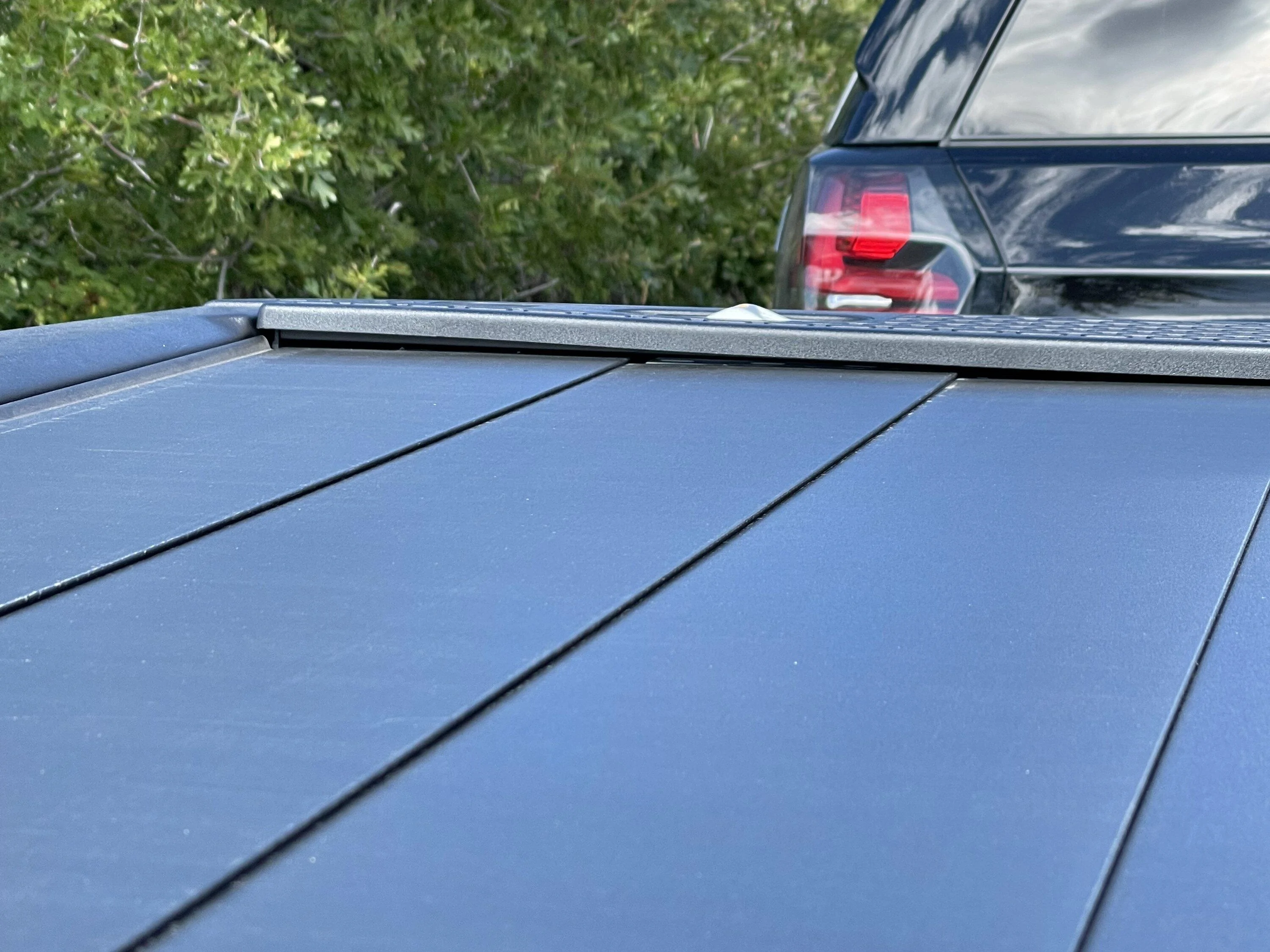

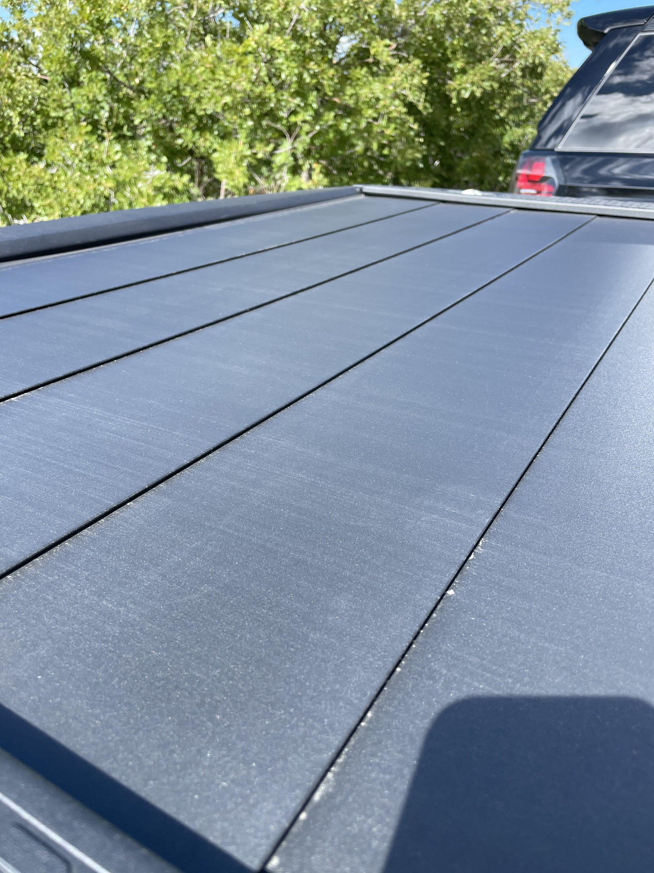

Here are some photos of my tonneau. 109xx VIN. There is a slight overlap on the panels. I don't know how to tell if I have one or two motors. Haven't had any issues yet although it doesn't always sound great when retracting. But I probably have less than a dozen cycles on it.
Rivian R1T R1S Tonneau cover issues tempImagetUp7vM
Rivian R1T R1S Tonneau cover issues tempImagerWoXut
