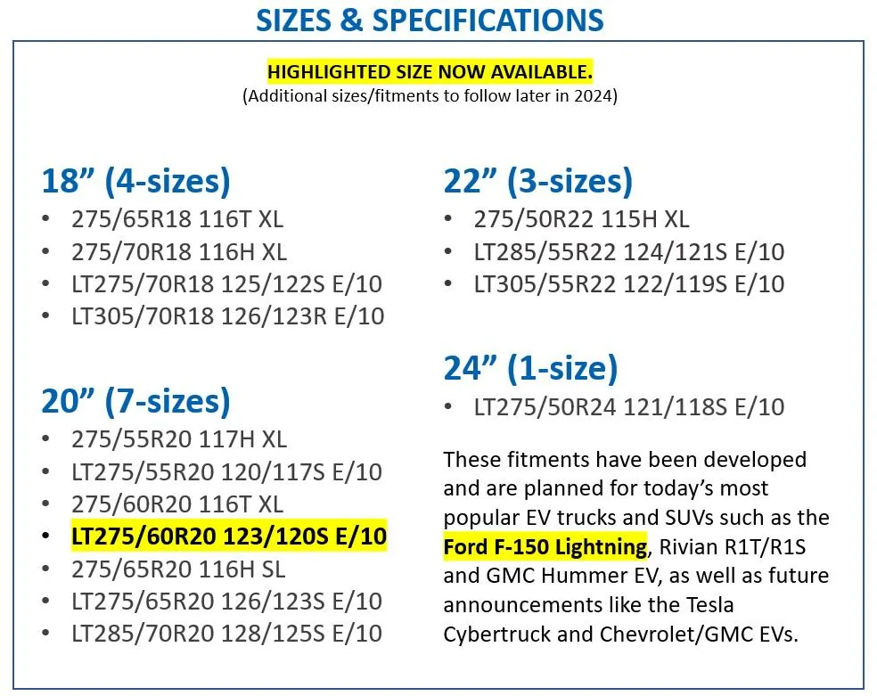

Looks like the Toyo website has the 275/60/20 LT at 53 lbs. Hope they do a non-LT version as well.
https://www.toyotires.com/open-country-at3-ev
Nice to finally see some specs. Too bad it's only S-rated, would've preferred a T or H speed rating. But 53 lbs is pretty light for an LT E-load tire. The 275/65/20 will be heavier, but hopefully this means it won't be over 60 lbs like some of the popular brands. Really hoping they come out with the 275/65 before I need to replace my tires...which is likely going to be late spring/early summer.
2,016
2,697
There will be a 275/65R20 116H SL and a 126/123S E/10.
Rivian R1T R1S Toyo Open Country A/T EV tires new release open-country-at-iii-sizes-preview
