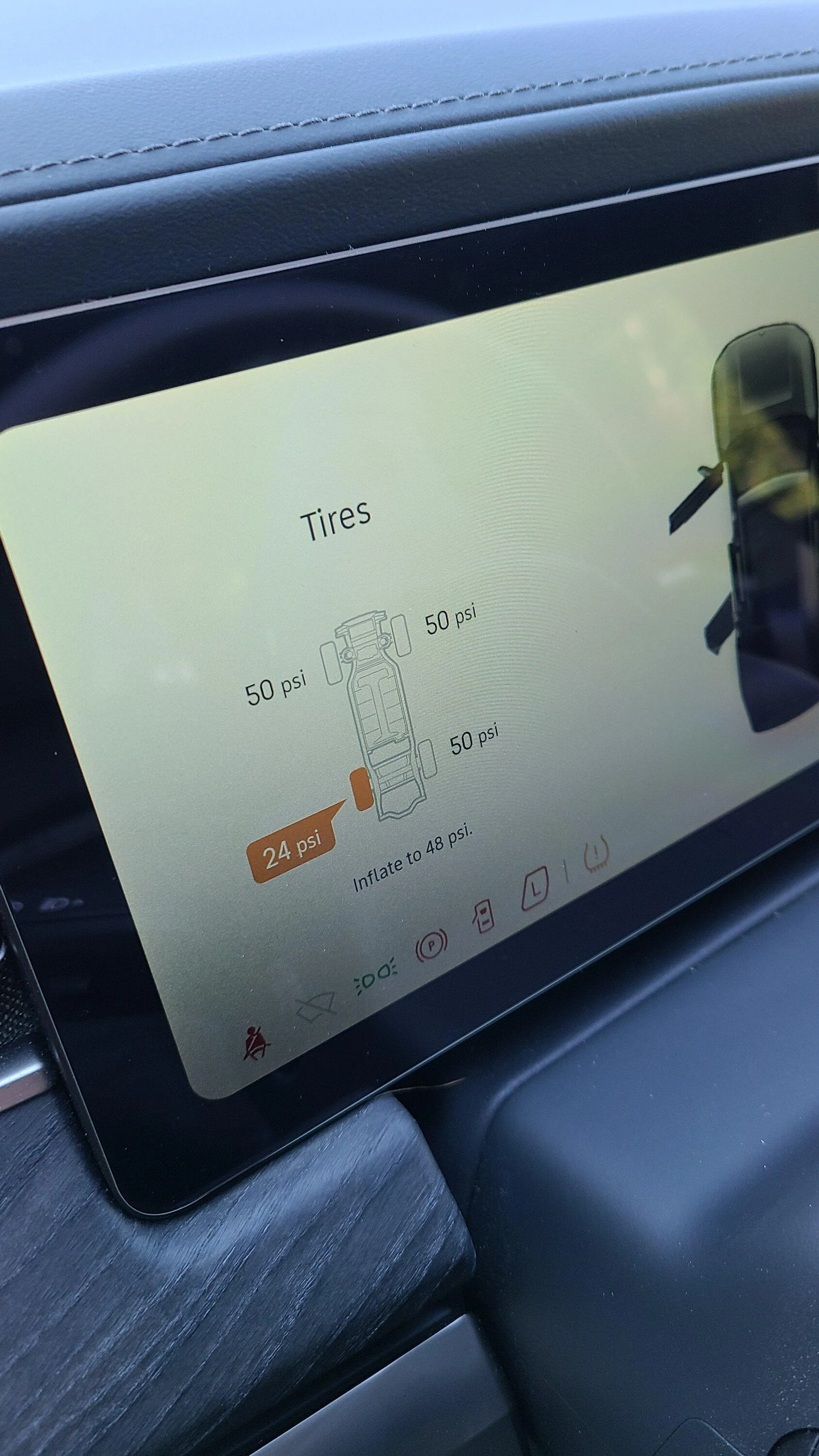

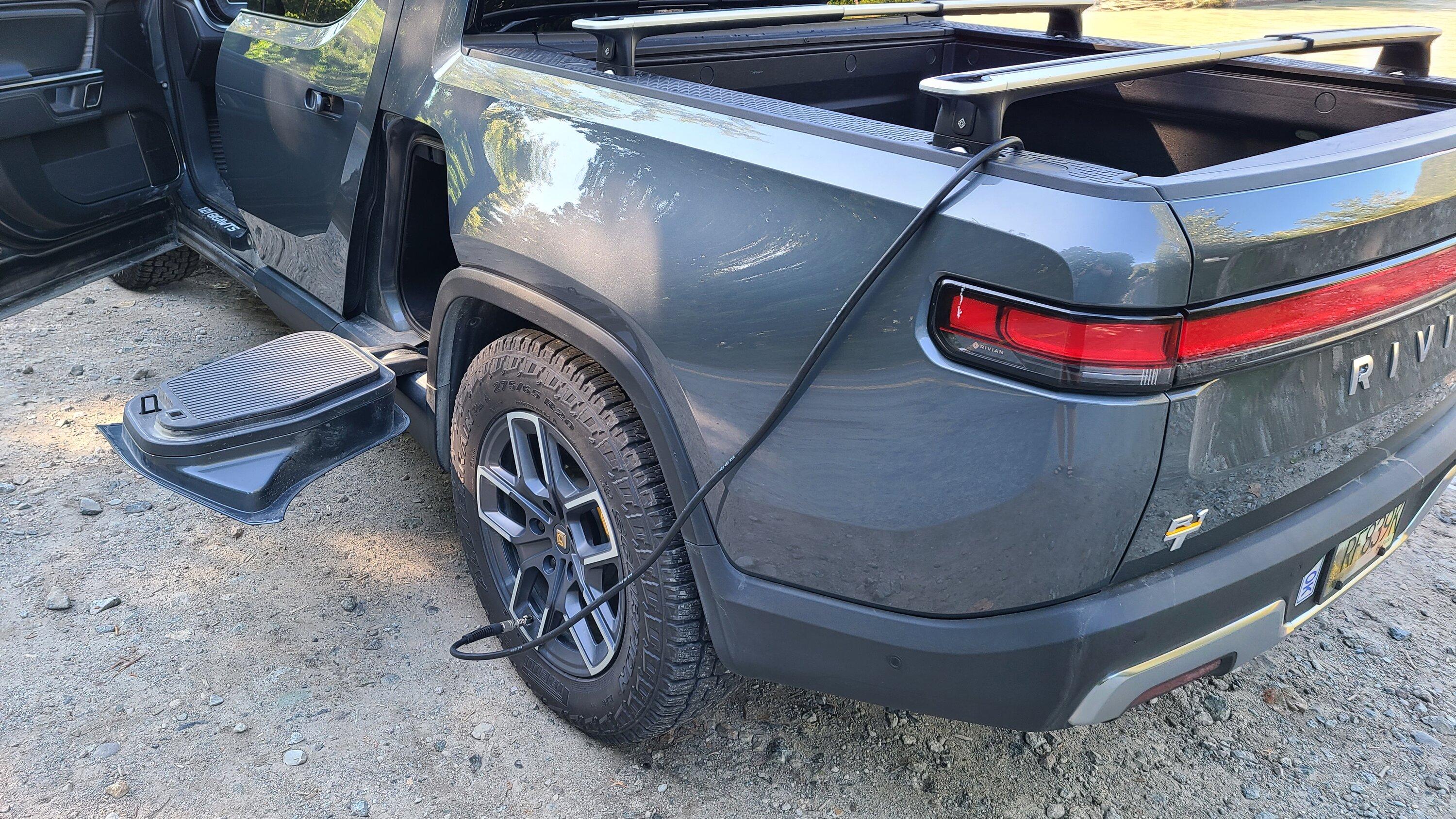

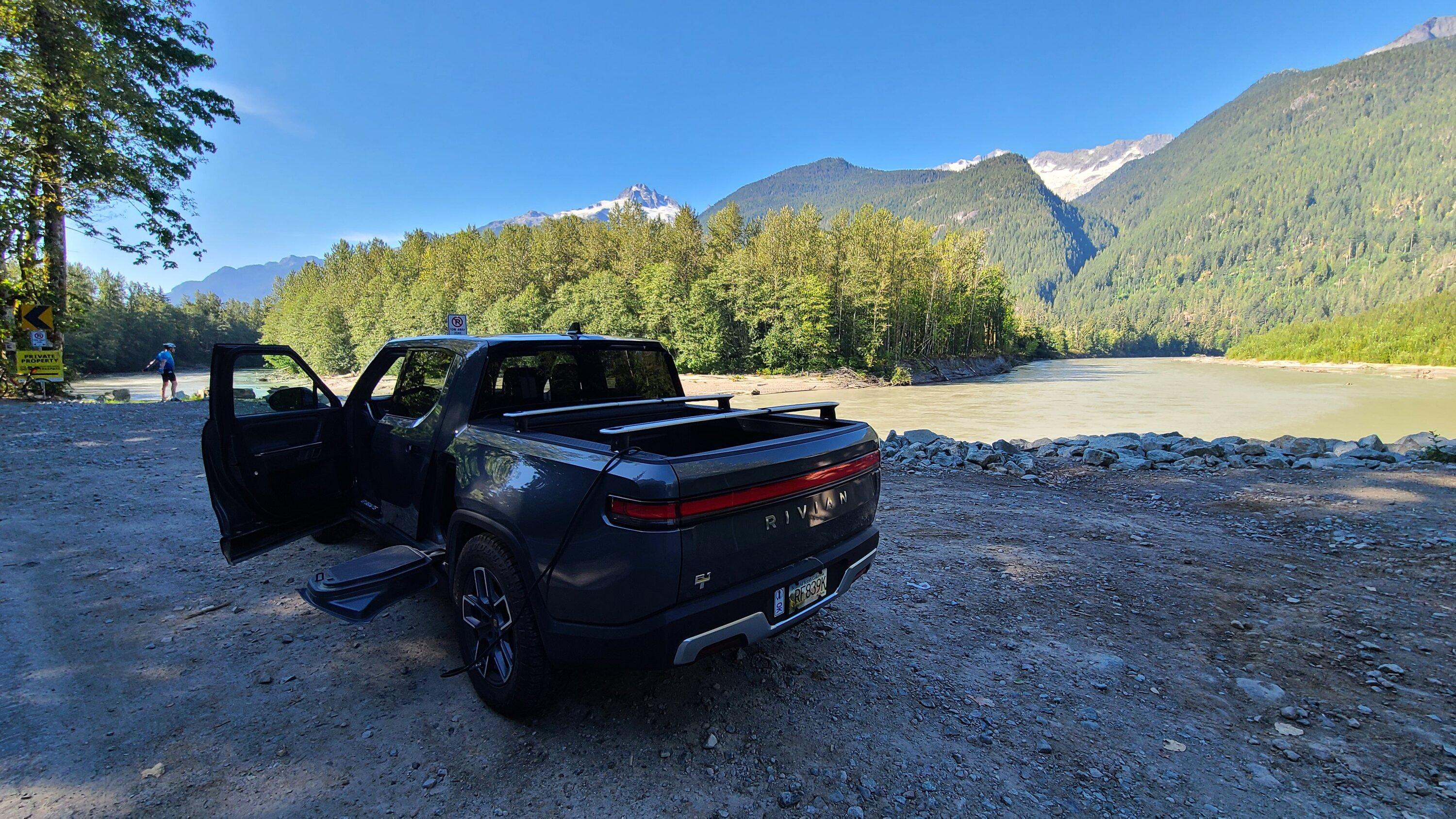

I'm wondering if the vehicle forgets which ID to listen to occasionally and only picks them up after driving a while. When I let air out for my off-roading stuff, it knew about three of the four tires being low but stopped reporting anything about tire pressure that whole day until I aired back up.
I had gone for a drive this weekend through Squamish and wasn't intending to do any off-roading, but was t an area to turn around on pavement, so went literally 2 seconds down a logging road to turn around. Immediately got a tpms warning light and was watching my pressure drop 1psi every 10ish seconds.
I decided not to gum up my tire with the fix a flat in favor of popping by a Canadian tire 20kms away and plugging it.
Conclusion is the tpms will stop sending data to the truck after a few minutes, so you can still watch them inflate in real time etc after stopping briefly. That same shut off delay is present when the truck starts moving again for restart, usually around 1-2 minutes after driving starts.
Either weight, tires, or shite luck, I've now had 3 punctures on the AT Scorpions in 9,500 km's. Might swap to Flaken next round.
PS
Not the worst spot to have to stop to inflate a tire.
Edit* had to stop 4 times to re inflate on the way to Canadian Tire. The built in air compressor was probably one of the best additions to the Rivian Swiss army knife.
