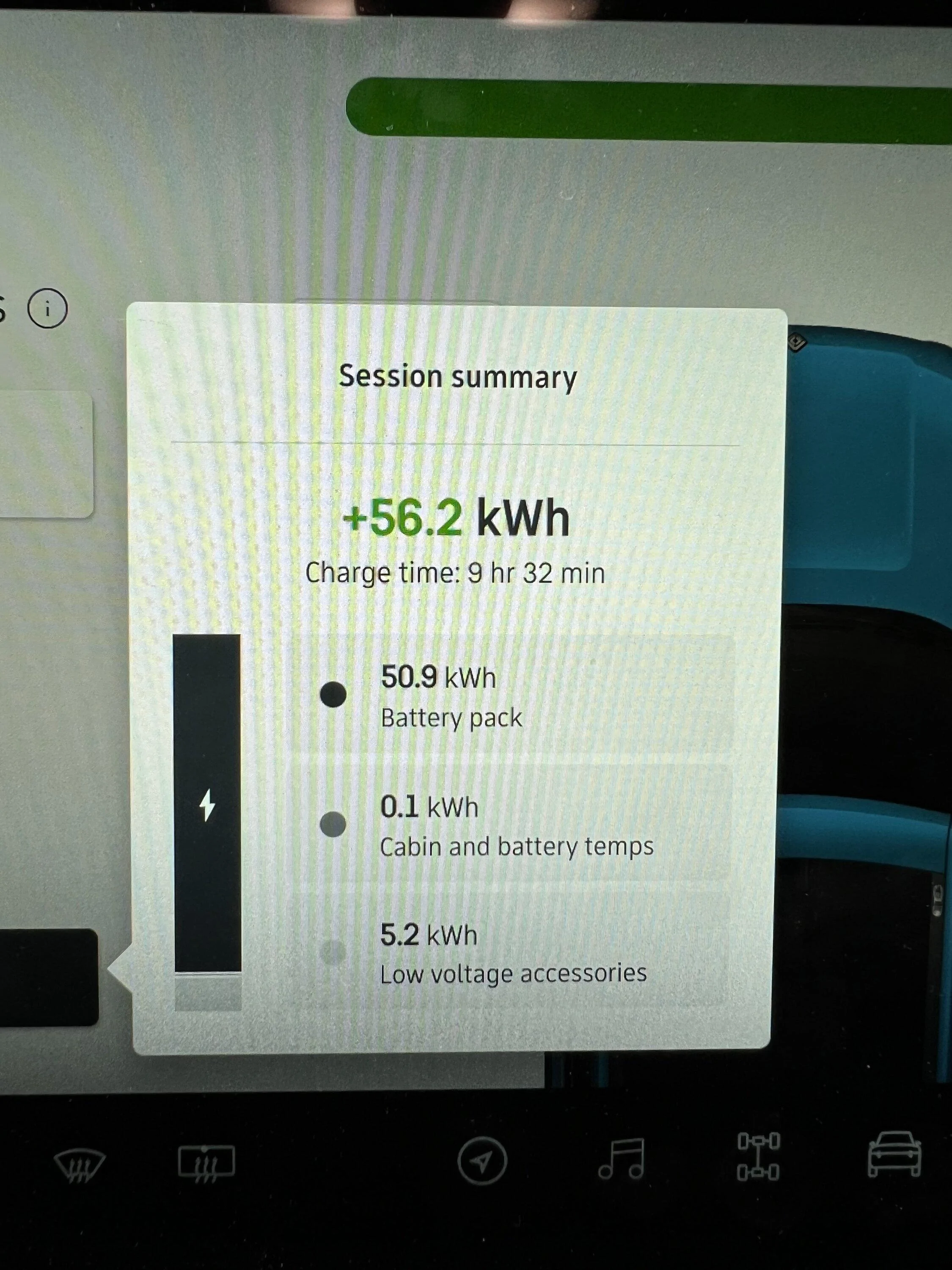

The new software shows some more details about completed charging sessions!
Rivian R1T R1S True Level 1/2 Charging Efficiency 5568D9D0-4E70-4FFE-8753-DE38E6200809
Left it on overnight on a Public Level 2 EVSE. It is a busy parking lot in an area that doesn't see many Rivians, and there were 405 gear guard videos from the night. But as you can see, average draw for "low voltage accessories" (e.g., the computer and cameras) is over 500W. Over this duration, that represented ballpark 10% of what was delivered by the charger.

Cool details, thanks for sharing! The cabin/battery temp seems reasonable... what was the ambient temp like? The accessory usage seems a bit excessive. When charging what's providing that power? Is it the EVSE directly or does the power have to flow through the battery first?

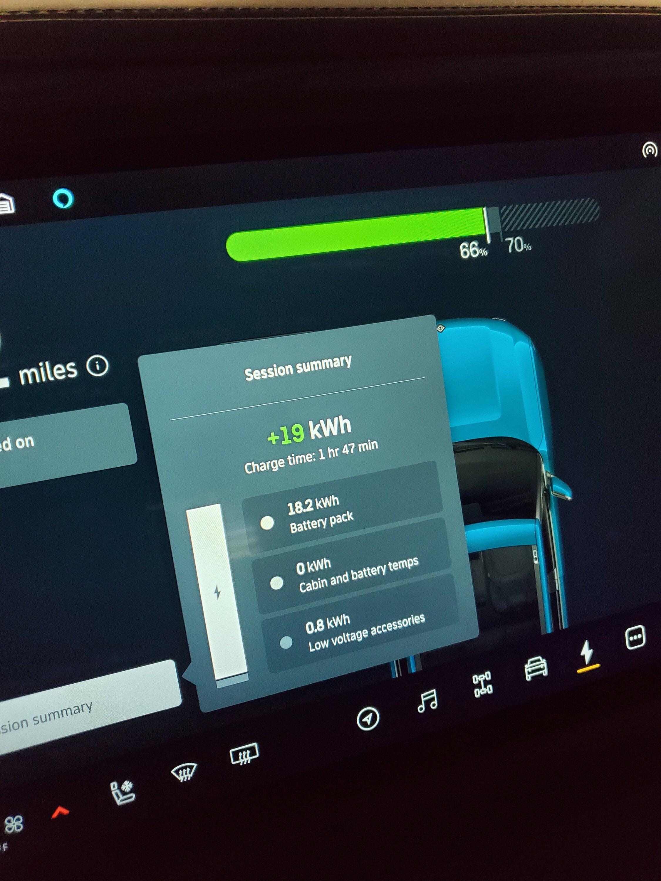

For comparison, overnight at home, garage kept, gear guard off at home:
The accessories include gear guard, and as I mentioned, we were parked in a busy public lot and captured 405 videos. Averaging a bit over 500W isn't too surprising to me in that environment.
I don't know for sure about the architecture, but I suspect there is a single DC converter from the high voltage system to the low voltage system. So if there are loads on the low voltage system, the converter will place a load on the high voltage bus to tend the 12V batteries. So my best guess would be 240VAC goes to the high voltage charger, and on the charger is loaded with the high voltage batteries and the low voltage converter. The power wouldn't flow "into" the high voltage pack then back out to the converter though -- both the pack and low voltage converter would be parallel loads on the charger (unless the low voltage system was drawing more than the charger was providing, in which case the high voltage pack and the charger would both be parallel sources to the load).
