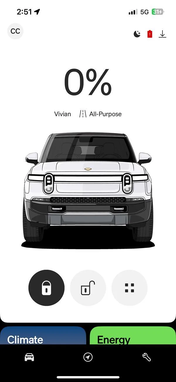

I think I’ve been hit by the phantom drain. We parked 2 electric cars side by side on June 18. The MB is down to 62% from 100% and the R1S is 0, from 100%. They are near the airport and we won’t be back until September but does this brick mean long term damage? We left it last summer and it was fine-this year a different story. We are in another country or I would simply have it charged.

Looks like Mercedes got something right with the battery drain. 62% MB vs 0% Rivian. We need a sticky for best practices for long term parking. I hope OP gets through this unscathed.

Mini update: I called Rivian, spoke with a representative and I was advised, after the rep confirmed and called me back, that once its dead it wont matter if i wait a month. i was suspicious and asked for written confirmation-its allegedly in my "ticket". I still plan on going for the day, they can pick it up and take it to the shop. Fingers crossed. My take away from all of this is that i should have made alternative arrangements for this car as it appears it can't be left unattended for 2+ months. If i still have it next year I will need a "plan B".

^ "plan B" if you have the Rivian next year is to park it somewhere safe then physically disconnect the 12 volt battery. Once you have done that, you will probably see about 1% drain per month on the traction battery. Leave it at 60%, SOC, when you return in two months and reconnect the 12V batt(s) it will be at 58% state of charge.
