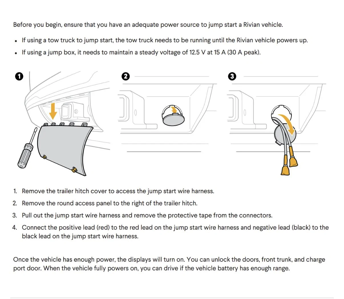

stupid question but I just tried to open the charge door remotely however the app stays on “waking”. Is there a manual way to open the charge door? Otherwise I will get the flatbed.

That seems like a lot of loss for 40 days. Even at 2% a day you should have some battery left. Do whatever you have to to get it plugged in, even if it is with a 120V extension cord. It's not too late, but it will be once the 12V dies.

Sorry Op, although your 12 volt batt(s) may be shot at this point, the big/expensive propulsion battery will be fine as it has low voltage cutoff protection via the BMS which protects it from over-discharge damage.
At least you're close to the Brooklyn Service Center so flatbed charges from Jamaica will be minimal.
