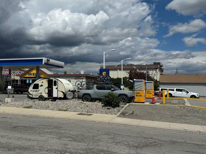

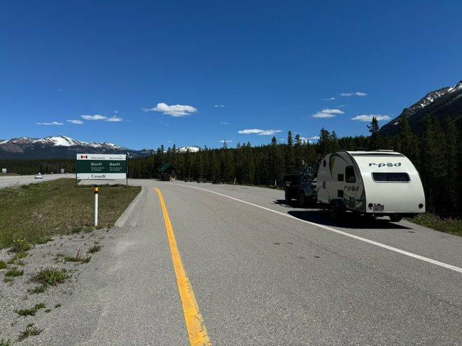

Back to our experience traveling to Banff. Throughout the 3200 miles we traveled, we only came across 3 Supercharger sites. There were countless other DCFC that made the trip possible. Often times we had 3 or 4 choices of DCFC sites and brands within a mile of where we stopped to fast charge. Within the Banff, Glacier, Jasper, Kootenay, Yoho National Parks area there are more than 12 DCFC sites listed on PlugShare (non Supercharger). Within the same area there are only 3 Superchargers available for non-Tesla. And not one of them would have made a trip to the Columbia Icefields possible with our Rivian. We encountered another Rivian family in Canmore at a PetroCanada that had also made the same assessment having come down from Jasper. They chose to embark on their 2500 mile trip to Jasper & Banff without ordering a NACS adapter (they had just gotten their R1S 7 months ago) and realized half way through their trip they were totally fine without. The numbers don’t support the hype.
Rivian R1T R1S Unsuccessful using a2z adapter at Tesla supercharging station 3E02%21114441&authkey=%21AP7MM21tI8dA0lI&width=660
Plus how many Tesla sites support trailers? Not one of the Supercharger sites we saw would have permitted charging with a trailer without blocking at least half of the Superchargers. They wouldn’t have been practical even if they supported non-Tesla. Countless pull through sites and sites that allowed head in parking while still hitched up. Only a couple we tight.
Our non subjective experience at pull through:
Rivian R1T R1S Unsuccessful using a2z adapter at Tesla supercharging station 3E02%21114417&authkey=%21AEyUZhgbAG5tlps&width=660
The overall point is, while they do open up some routes for easier travel with a EV, there’s not nearly as many Superchargers available for Rivian or other EVs as the hype would lead you to believe.
