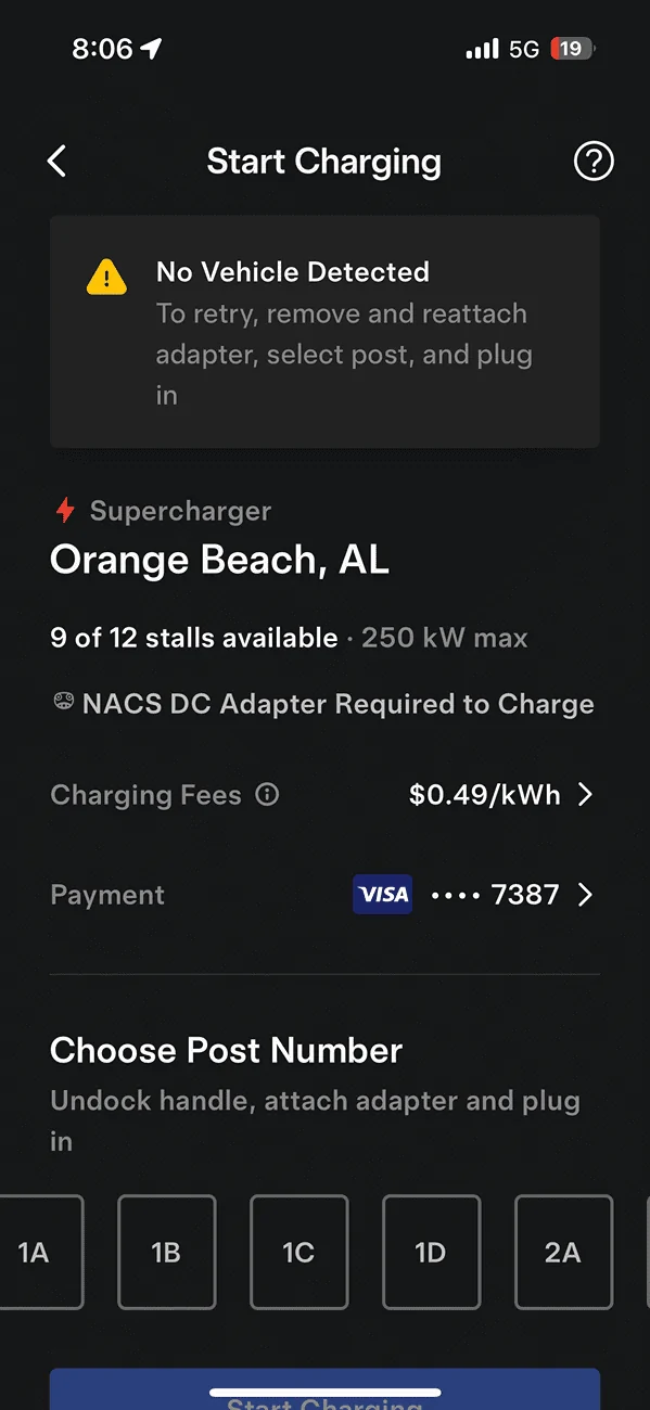

I have that as well and that is working fine. The supercharger typhoon is not working.
which chargers? Not all superchargers are open to non teslas
Tesla superchargers and indicating at the navigation that I can use with an adapter

it also would pop up no vehicle detected as an error message.
This error means that A2Z hasn't "mated" with the tesla supercharger plug correctly. I used some dry lubricant to help break in the adapter. You may think it's locked or inserted correctly, but it is not. I had the same reaction the first time I tried it. The lock switch seems to need a breakin. Once it's broken it you shouldn't feel much resistance. The A2Z also take a couple of times before the fit with the tesla plug is optimal. As others have noted, the A2Z is only for tesla superchargers, need a separate adapter for destination chargers.

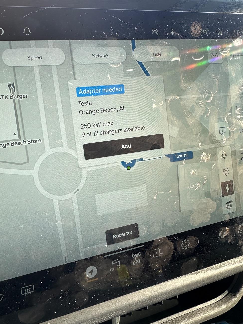

Make sure it shows as “Adapter needed” compatible charger of 250kW. The icon is lit up in the Rivian App and not grayed out.
I had gotten the same issue/error because I went to a station that was not 250kW which won’t work.

Can you double check to see if the Tesla charger you used supports Rivians?
Find Us, Tesla look for map, or Rivian navigation should tell you if the charger you used supports NACS charging for Rivians.
