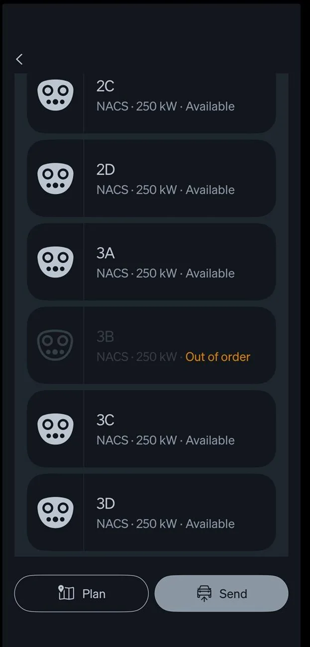

The Rivian app is showing station 3B is out of order at the Orange Beach, AL site. So don’t use that one

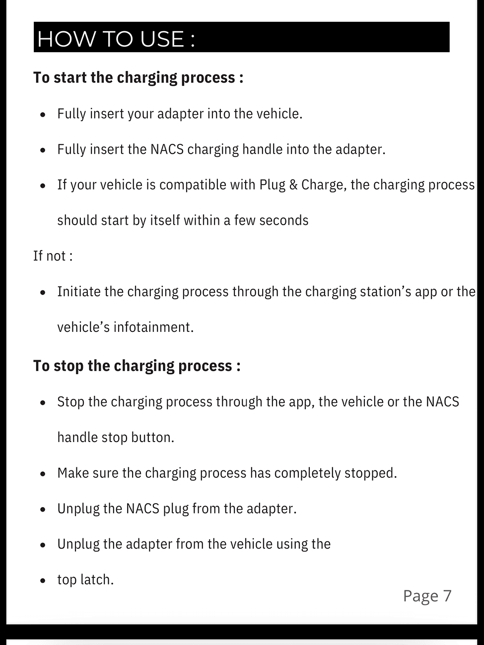

Yep, connect, lock, put in Rivian calling them now
The Typhoon Pro instructions have you putting just the adapter in the Rivian and then initiating the charge (if using the Tesla app) or plugging in the charger (if paying Rivian). It sounds like you have the steps out of order.
And please don't get frustrated with our replies (you're getting a lot of help) - we're all just trying to help you.

I would have messed this up if I did not read the directions just before use. These are the directions for the new version Typhoon Pro adapter. I haven’t needed to use the older Typhoon version yet. On the old version, there is a lock on the bottom of the adapter you have to slide to lock the Supercharger to the adapter. The top latch is to lock the adapter to the Rivian

If original Typhoon adapter, once plug is fully inserted and locked, the slider switch should fully cover “LOCK” imprinted on the body of switch. You can also verify by observing the wear marks on the plug. Is the wear line flush with adapter? Or you can try and pull the two apart. The adapter will not lock if plug isn’t fully inserted and switch not fully engaged. If plug is not fully inserted then the notch in the plug isn’t lined up with the locking tab, which would impede slider to go fully in the locked position (and "LOCK" would only be partially covered). Insert plug with one quick forceful motion, to overcome friction, and ensure best chance of full insertion.
Typhoon Pro instructions call for insertion of adapter first, to make insertion of NACS plug easier. Original Typhoon can be used same way.

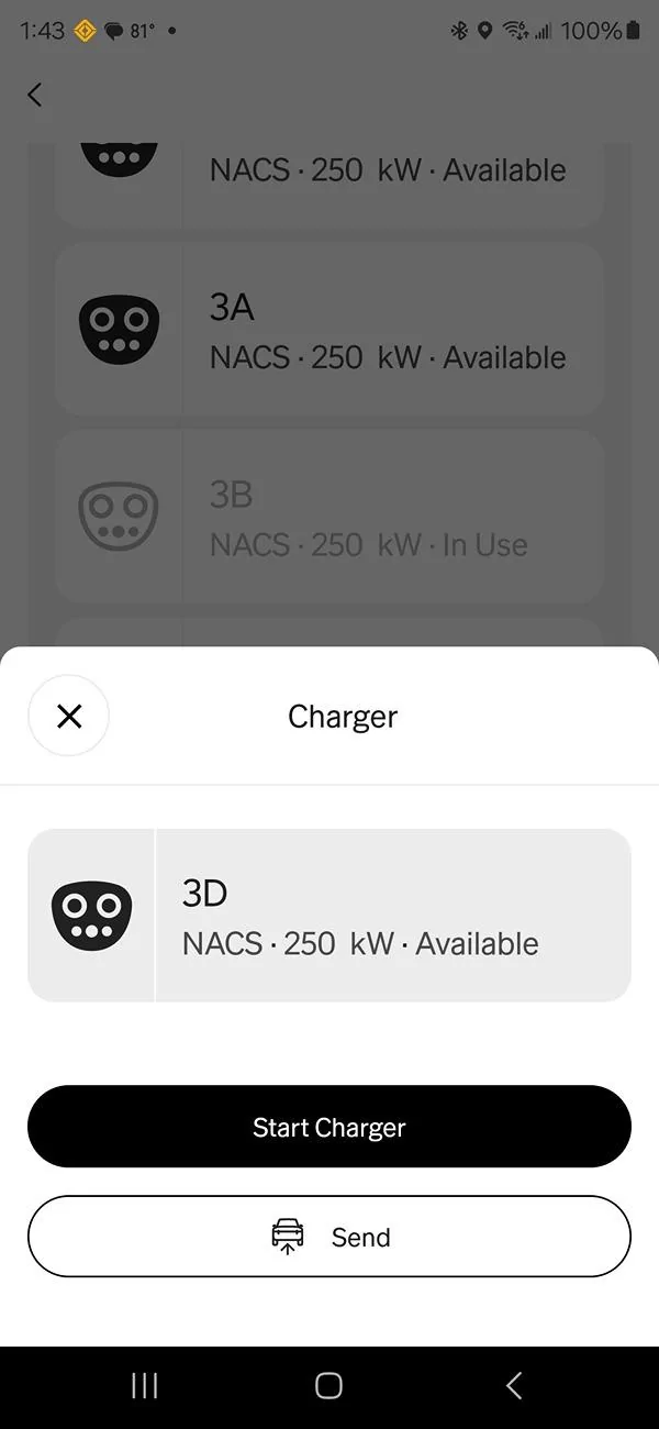

I just got my A2Z Typhoon Pro adapter and may have had the same or similar issue. The first time, it timed out because I needed to update my credit card on file with Rivian through the mobile app. Subsequent attempts would time out after a minute or 3.
Finally, I pulled up the charging station in the Rivian mobile app (while I was connected). My station showed as "in use" but when I selected it, there was START CHARGER BUTTON. That worked, but was not the plug-n-play experience I was expecting.

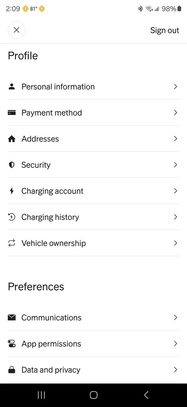

Just a sanity check, but you have a cc saved on your Rivian account?
