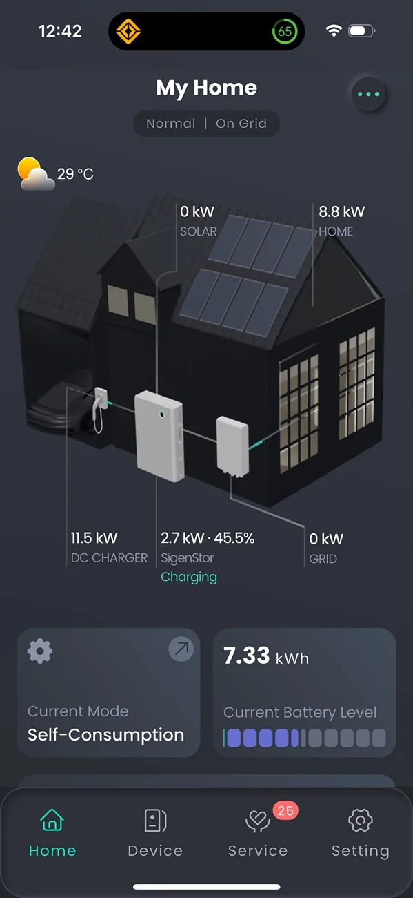

A member in the discord community has a full setup with his Rivian and gets 11kw output max discharging
