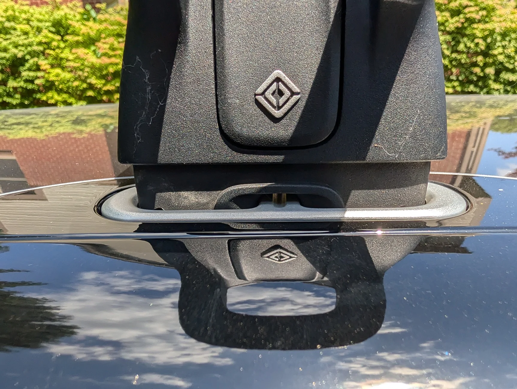

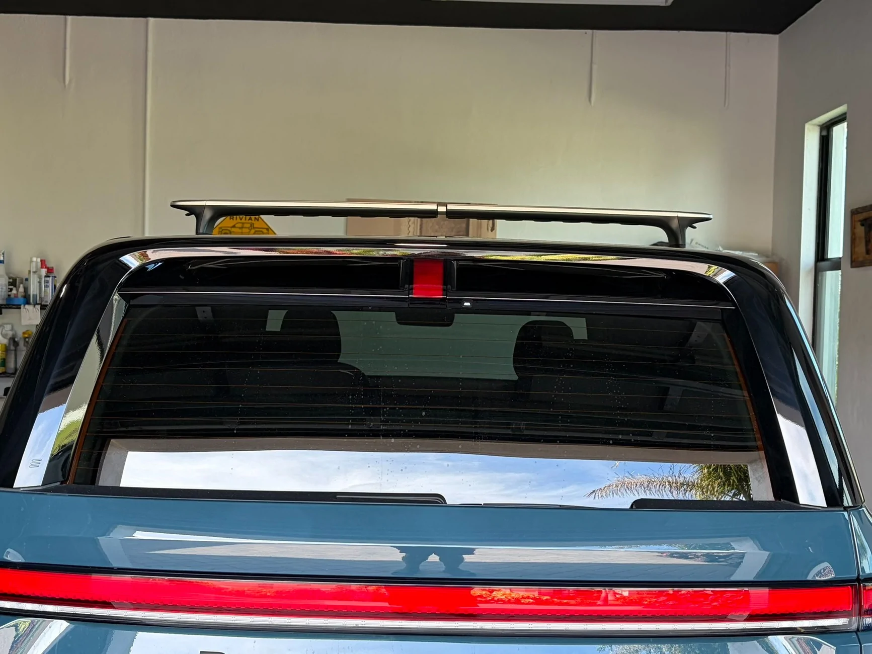

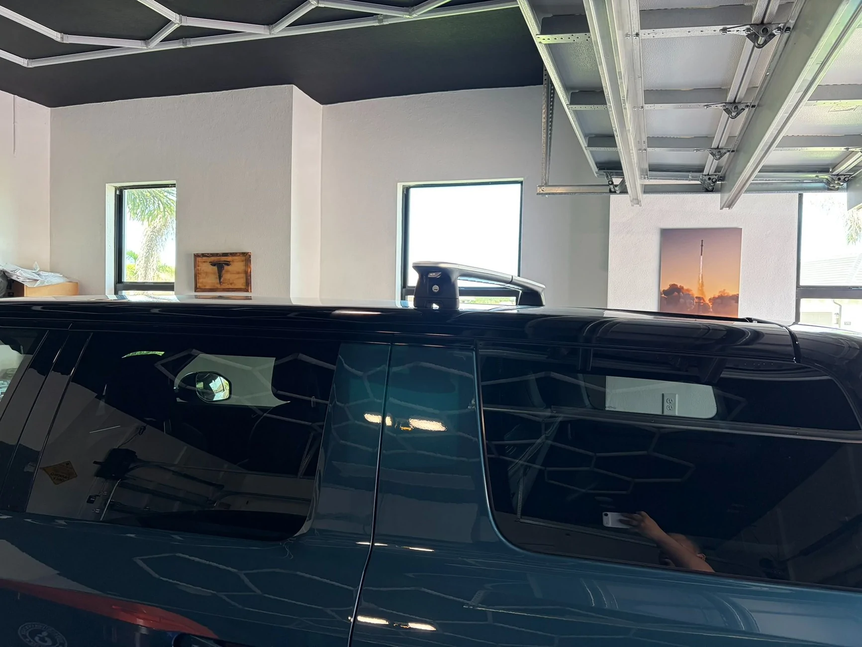

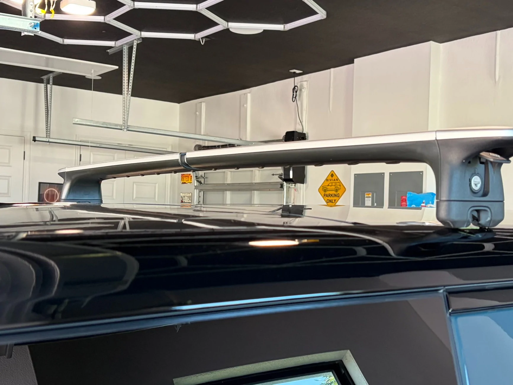

For this wondering, what/how/why the R1 cross bars don’t work on R2. Below are pictures, R1 bars are just a tad bit too long. They do not collapse enough to fit R2 narrower body. The locking mechanism is slightly different. I do think, that then locks were changed since the bars couldn’t fit. I do wish there was just one cross bar solution for all Rivian vehicles but I get it!!

I seriously doubt that is it. No one went "hahaha, if we make the R2 mount points slightly narrower we'll sell more accessories! Let's do that!"
That is not how engineering something as complex as a vehicle works.
More likely, the requirements for the R2 -- for a whole bunch of reasons (cost, efficiency, handling, whatever) -- resulted in a design that was a certain width to optimally balance as many concerns as possible. Once they got that width, they weren't going to let something as relatively trivial as the size of an existing accessory derail/change it.
Especially considering that, if I had to guess, less than 10% of R2 owners are ever going to care about carrying anything on the roof. And probably a small % of those people were R1 owners and had existing crossbars. The people on this forum are outliers/power users.
Such a tiny population of the potential customer base is not a reason to change what is otherwise your optimal design.
I would guess that at some point they will design universal crossbars.

Yes of course. But how long do you keep compatibility? Is it better to break compatibility now, when there are only a few hundred thousand R1 on the road, or to break it 10 years from now when there are a million R2 on the road? Or do you intend that they should be stuck with their non-prescient design decisions made 10 years ago when the R1 was being designed and R3X wasn't even a glimmer in RJ's eyes yet? The cross bars aren't standardized, there's no third-party manufacturer making equipment for these, etc. There's not much compatibility to break right now. But if Rivian *does* want to develop a third party accessory market now is the time to make changes to accommodate that market.
There are at least two fundamental changes that may have contributed to this incompatibility. First is the width of the R2, and the fact that the R1 bars don't collapse that much. Could they have designed R2 bars that expand enough to fit the R1? Possibly, but that still obsoletes the R1 bars. Then we get to the second change, which is the power to the crossbars. Now this didn't make it to production (although widely shown in the prototypes), but doing this clearly has some implications for the crossbar mounting points because you need to allow for the power connectors and wire routing. And it's something they never anticipated 10 years ago. If they ever intend to implement this in the future (which they do), they need different mounting points. So why not make the change now when it's still relatively easy to do, rather than in the future when there will be a much larger installed base?
Then there are the manufacturing issues. Rivian has clearly spent a lot of time and effort to reduce the costs of manufacturing. Even a seemingly small change like reducing the mounting point a fraction of an inch can have large consequences in manufacturing. For example, those of you who have 3D printers know that if a part is a little too large in one dimension then you just can't make it on your printer, and you will need a bigger/more capable/more expensive printer. The same is true for any manufacturing process. Perhaps if they reduce the size just a smidge they can use a different-sized standard stock material (e.g. sheet metal) rather than a custom size stock or a larger size with significantly more wasted material. I don't know if that was a motivator here, but it's certainly possible and again this would be the time to make the change.
Bottom line we're never going to know all the factors that went into this decision, but there are many perfectly valid business reasons and engineering reasons for doing something like this. Making up a story like "planned obsolescence" is a little patronizing and is the least likely answer because Rivian has not demonstrated a pattern of doing things like this as a money grab. That would actually be a lot of extra work for them with very little real payoff, and they have a lot of more important things to do than to redesign the crossbars. The number of parts and processes shared between the R1T/R1S/RCV/R2 demonstrates that they are taking great effort towards manufacturing efficiency, so that's what you can assume unless demonstrated otherwise.
