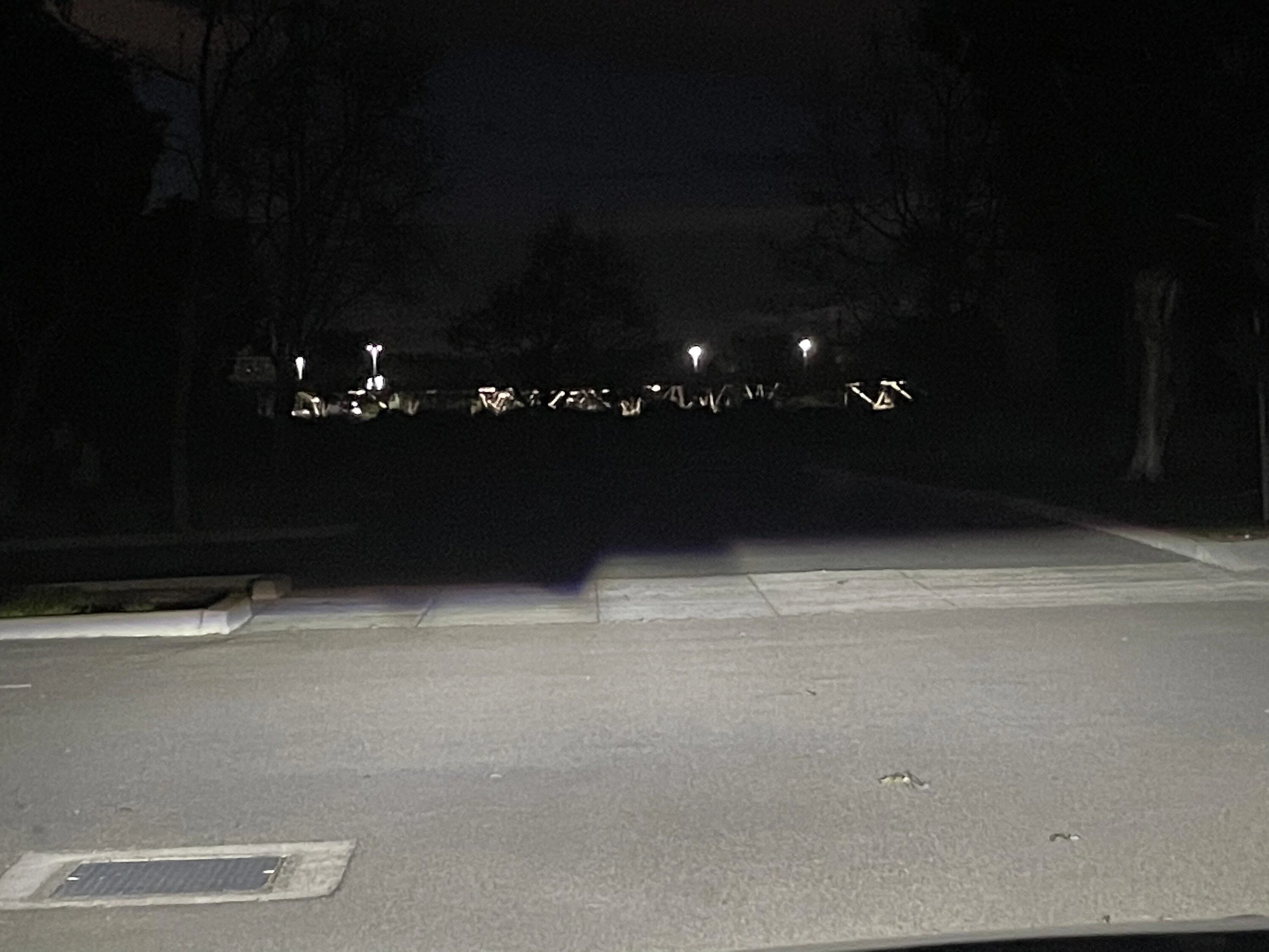

I apologize if this has been brought up before, but I searched the forums and couldn’t find anything.
Anyone else have a wacky sharp pattern caused by their headlights? I’ve added pictures, but iPhones suck at night time photos.I know normally this isn’t an issue, but I have OCD. Not like many people saying “oh I like to do this, I have ocd, hahaha.” No, I have a clinically diagnosed condition in which I will get anxiety of things don’t line up. These headlights, and their pattern, has made it so I can’t drive at night without the high beams on. Just curious if this is normal or is something out of alignment on mine.
Rivian R1T R1S Wacky headlight pattern? 56474193-2560-447C-A0CD-CC6FE16BA67A

That’s normal so you don’t blind oncoming drivers to your left and illuminates more of the right side of the road.
You could attempt to lower (tilt) your right headlamp assembly, using the adjustment screws under your hood if you want to attempt to line them up.

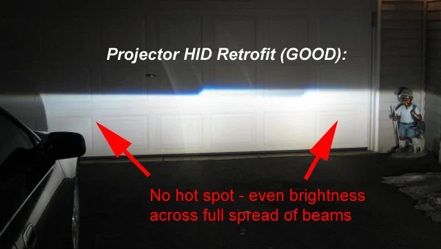

Rivian R1T R1S Wacky headlight pattern? 471154d1343012951-hid-light-setup-nohotspot
This is how a nice pair of projectors will line up. Your right headlight looks a touch too high (or left headlight a touch too low)
You will have the step down, to give better illumination on the right side of the road and not blind everyone driving against you.

Exactly how it's supposed to be, and all modern vehicles are set like this so you don't blind oncoming drivers.

Pretty sure this has come up multiple times. This beam pattern isn’t unique to Rivian. Welcome to circa 2010, and earlier if you are familiar with European cars. By design it is meant to light up the road (ahead and to the right) with diminished risk of blinding traffic heading the opposite direction. I have OCD also but I know enough to accept things when they are done for good reason. Don’t be another Ken. Got too many in here already.

You should notice that the little notches line up with the lane lines. Reduces the amount of lane line glare for oncoming traffic. Maybe that knowledge will help your "OCD".
