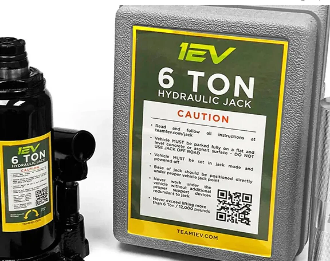

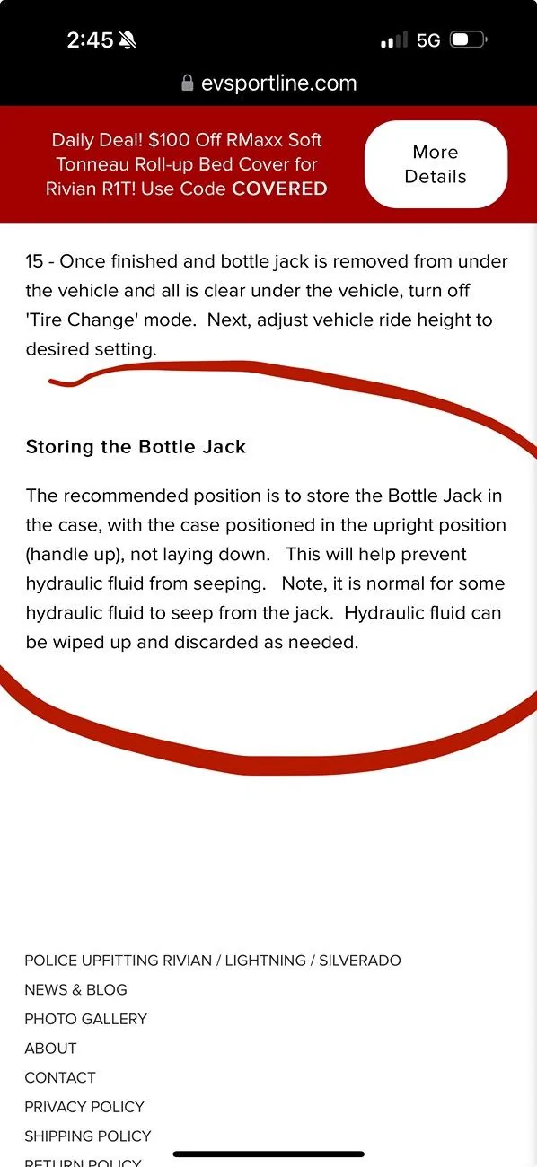

1. if storing it flat leads to failure, it would seem like a good idea to print it and include it in the instructions. How many people scan a QR code on a jack to read the instructions online when they are included printed in the product. This is a CYA situation so you can modify the instructions after you've shipped the product to customers.
2. It clearly states "recommended" and not required. As a Rivian specific jack it can't be stored how you recommend in the R1T spare compartment like I'm sure 99% of R1T buyers are storing it. Even if "recommended" was printed on the box most R1T customers are going to lay it down when it doesn't fit standing up.

I appreciate EV Sportline offering to replace it and even offer a gift card for the tire change service. However, it's not about the money. I'd much rather @EV Sportline send an email blast to those who ordered the jack with something like "hey, make sure you didn't store the jack in your R1T spare tire comportment as it could leak and fail." And add that detail as part of the printed instructions for go-forward customers and use "required" vs "recomended."
My entire goal here is to alert anyone who bought this Jack and is storing it in their spare tire compartment as my assumption is that is where most R1Ts have it stored. This is emergency gear you never check until you need it. My goal wasn't to bash EV Sportline. That said, I do have a problem with how this jack is marketed which is as a "Rivian specific bottle jack kit." While I'm sure EV Sportline would disagree, there is nothing that makes it Rivian specific other than the included jack puck. You cant follow Rivian's tire change process (max height / tire change mode) and you cant store it where Rivian's store their jacks and tires. As such, there is nothing unique about it over say a generic jack from harbor freight at 1/5 the price (which I'd add also doesn't call out needing to store it upright and in ~1.5 years I'll check and I bet it still works)

Guess I am missing on here where it says it is specific to Rivian. And more oddly enough if you READ the item description "Compatible with original Gen 1 R1T / R1S, and new Gen 2 R1T / R1S". Sounds like a run of the mill bottle jack.
At the end of the day you didn't read, big ole letters saying CAUTION and then says read the instructions. I recommend checking out JOCKO WILLINK; Extreme Ownership.
