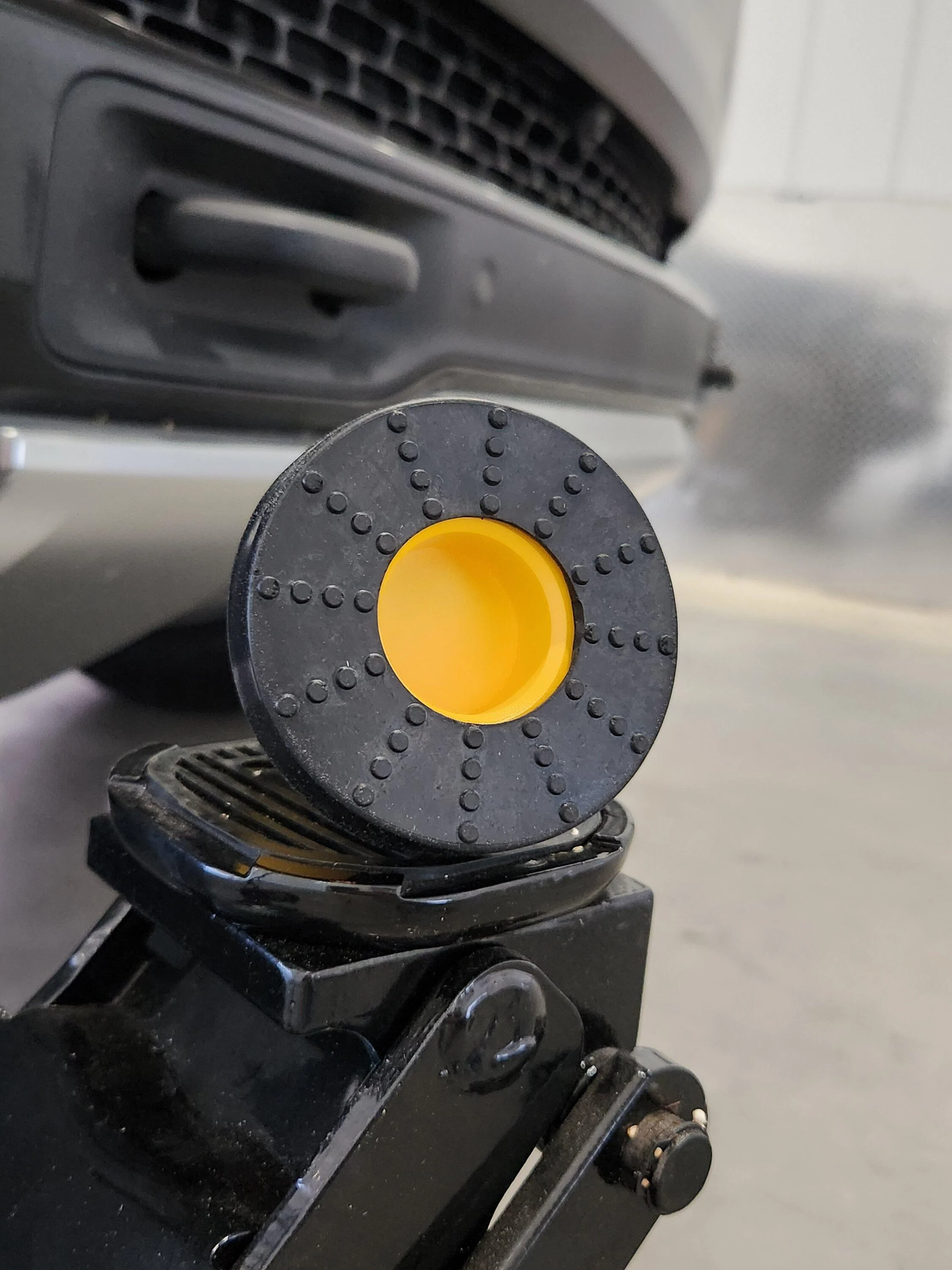

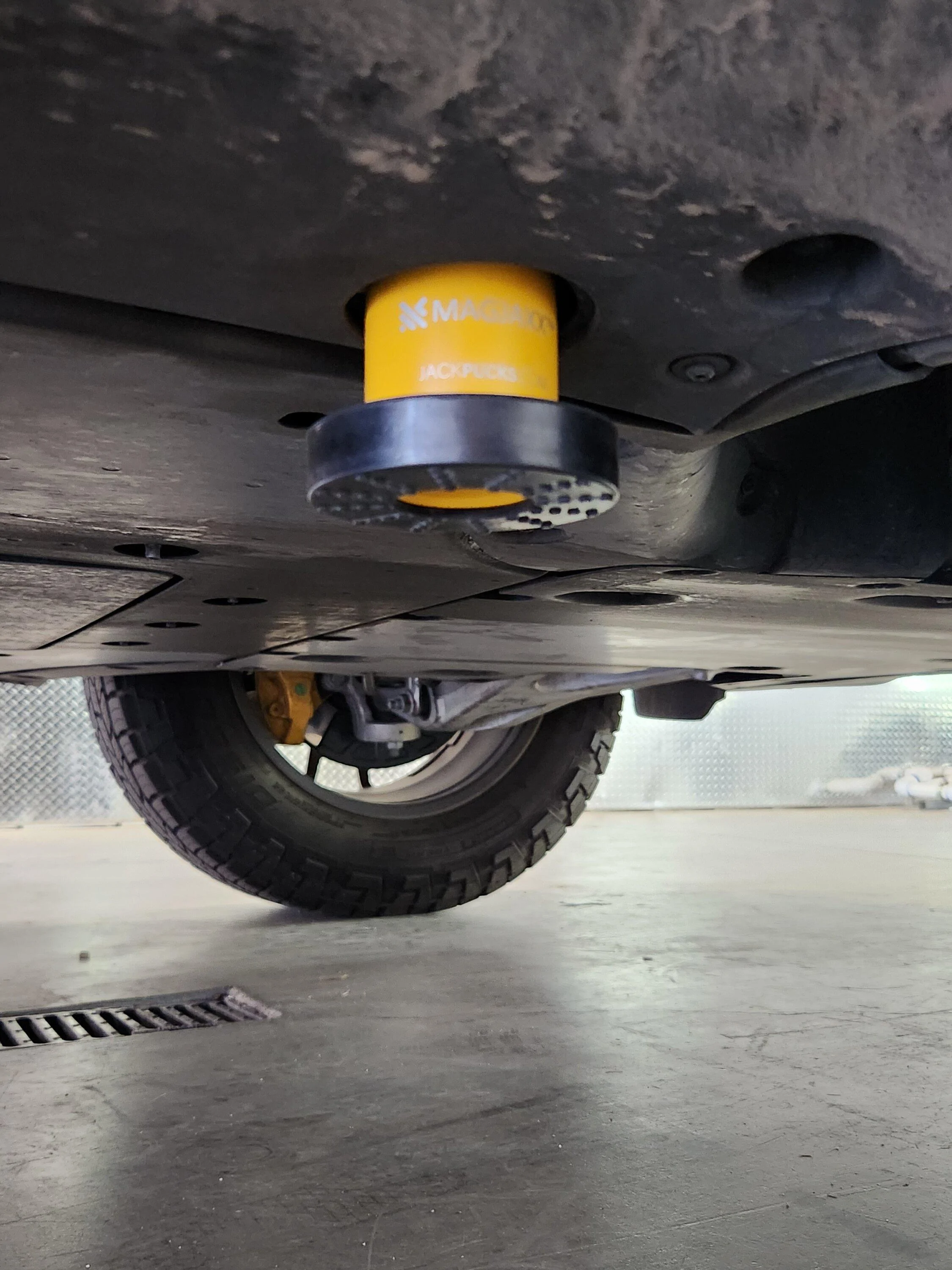

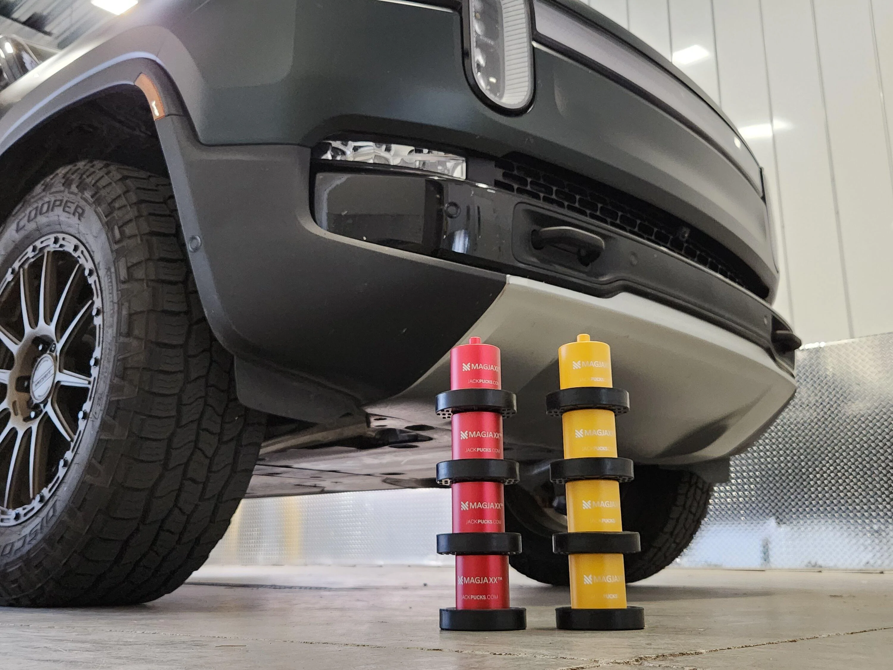

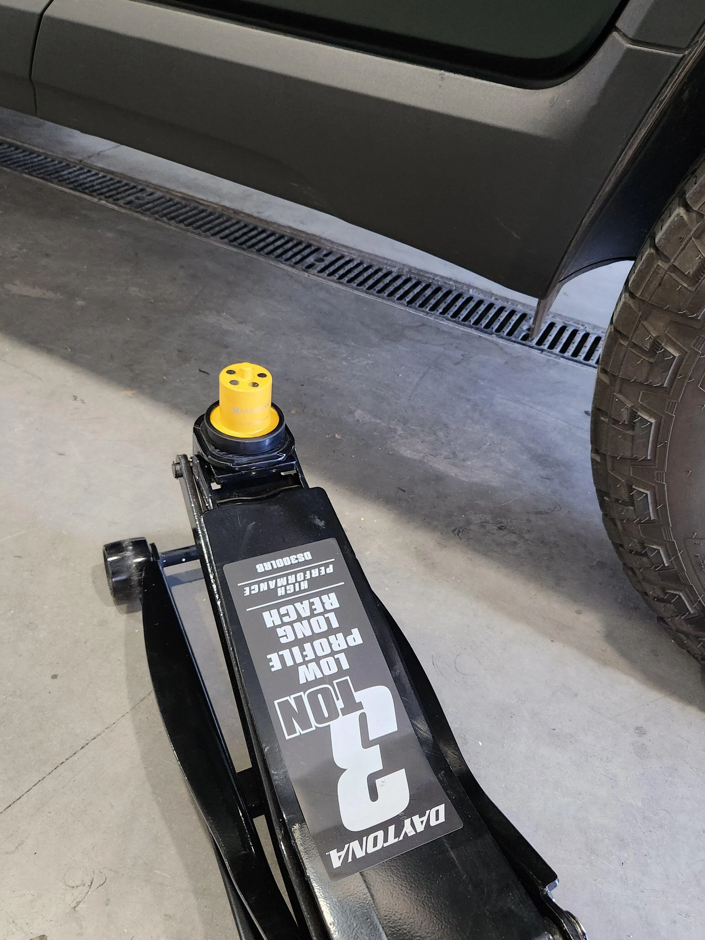

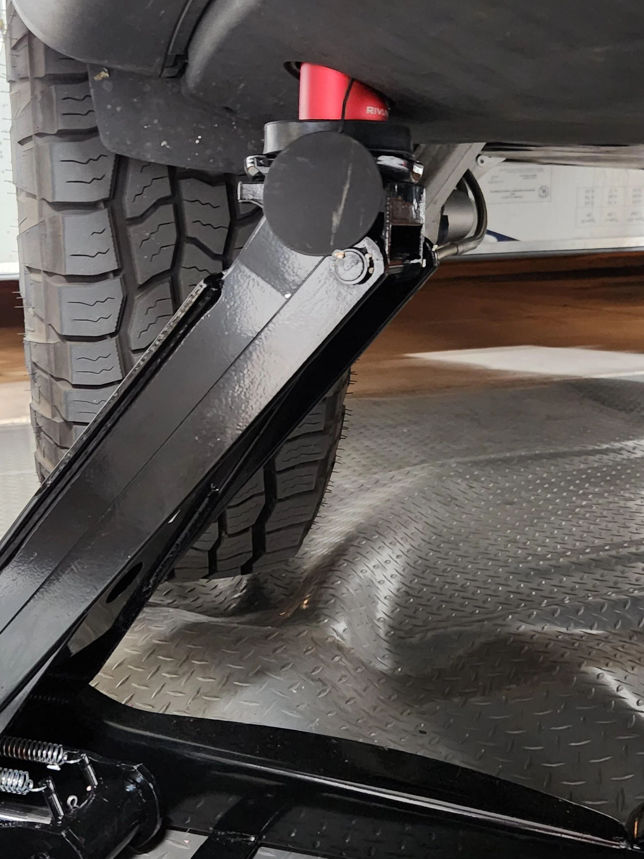

Here's a more price sensitive option that comes recommended by other forum members and I just picked up for myself: Daytona™ Long Reach Low Profile Heavy Duty Car Jack (harborfreight.com)
This is the jack I personally use (have 2), because it has 24"+ of lift height, which you need to get the rear wheels off the ground, due to more suspension droop with Jack Pucks. Don't get anything less. The other option is what another poster said is the Badlands 3T Off Road Jack Badlands 3T Off Road Jack w/29" of Lift Both of these floor jacks readily lifts the R1 off the ground.
Some use Jack Stands, which I will use on occassion (shown below), which is a 4T flat top, which works great with our Grip Tech rubber cap.
Pictures below of our 5-Magnetic Jack Pucks in Rivian Yellow using the Daytona Long Reach Low Profile 24"+ 3T Jack. You need the additional lift for the rear (said it again).
Rivian R1T R1S What jack should I use for tire rotations? 20231007_082209

FYI: The "regular reach" version of the Daytona jack mentioned a few times is essentially a copy of a $1000+ Snap-On unit. So much so that Snap-On sued Daytona, claiming the jacks “are substantially identical in shape and appearance”.
There are some minor build quality differences but It's a great jack regardless. The long reach version just makes it more versatile. I use it to reach the front or rear subframe on my low cars, which can't easily be done with the regular version.

I feel like this is a dumb question, but I just can't figure it out.
How do you get the jack stand under the vehicle when the puck is your only lift point?
My auto maintenance education came with a rule of ALWAYS use a jack stand. So I'm inherently skeptical of changing a tire from the jack itself, even though I logically know that's what most people do.

It's a reasonable question. I use two HF floor jacks and lift from right front and left rear, to a point high enough to place the jack stands in the other locations.
Sgt Beavis
Rick
Sep 28, 2021
79
2,124
4,541
Overpaid Computer Nerd
I respect a man that likes extreme risks....
