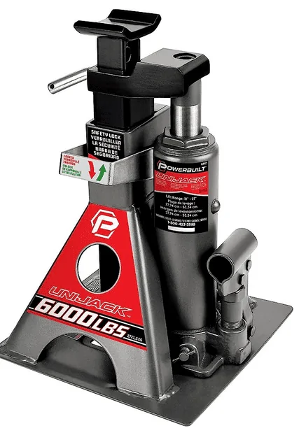

I'm surprised nobody has mentioned this yet. I haven't used it yet but others have mentioned it on the forum and it seems like a good solution at a good price unless someone can say why it would not work?
Powerbuilt 3 Ton, Bottle Jack and Jack Stands
It could work. But look at the cradle at the top of the jackstand. It's not a good interface for any of the puck adapters out there now. You'd need to either modify it or add/make an adapter so the lifting surface is a better interface to the bottom of the puck.

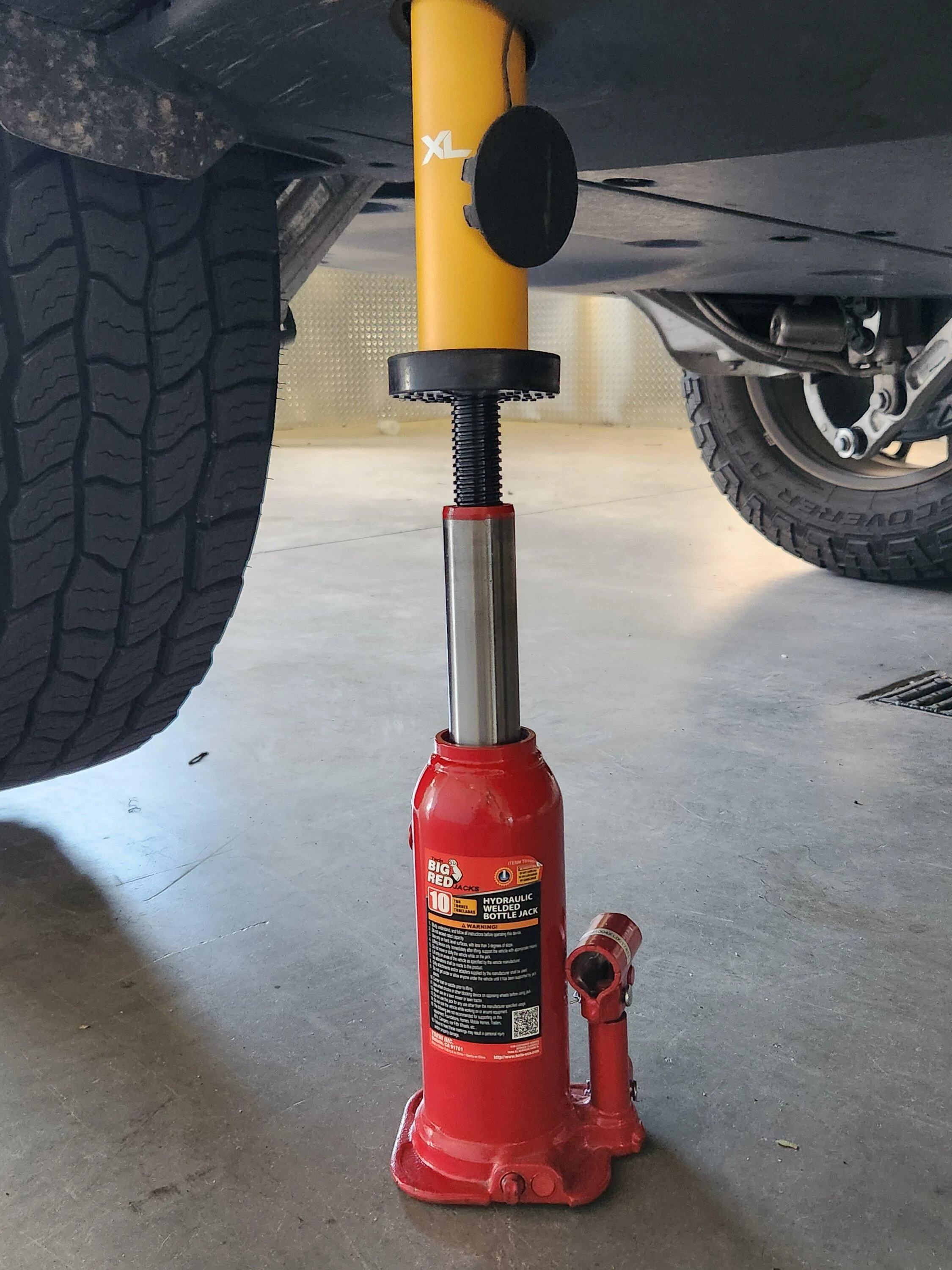

I take what jackpucks.com (forum sponsor) on their site has a rough guide/clue. They recommend a Torin Big Red 10-ton bottle jack (‎17.63" max lift). If you get a jack that has equal or more lifting height, you'll be fine. The HF Badland is more than adequate (and possibly overkill for most users).
Using the Big Red, you must stack two pucks for the rear.
I believe others have said that with the jack puck you need a total of 24" lift for the rear and the 34" tire configurations.
There are members that used this jack that has a 21" lift on a piece of 3/4" plywood with the 33" tire configurations and they could do it.
However there are also members that did it without the plywood on the 34" tire configurations and it would not lift high enough on the REAR.
So 21" lift, combined with a jack puck is likely the bare minimum to lift the rear and it still may require a piece of plywood under the jack.
I bought the jack I mention in this post and also the 3ton Aluminum Pittsburgh you mentioned (which is like $185 cheaper than the badlands right now) .
I am not concerned about their ability to do what I need as I have 33" tires and I can always stack a puck if necessary.

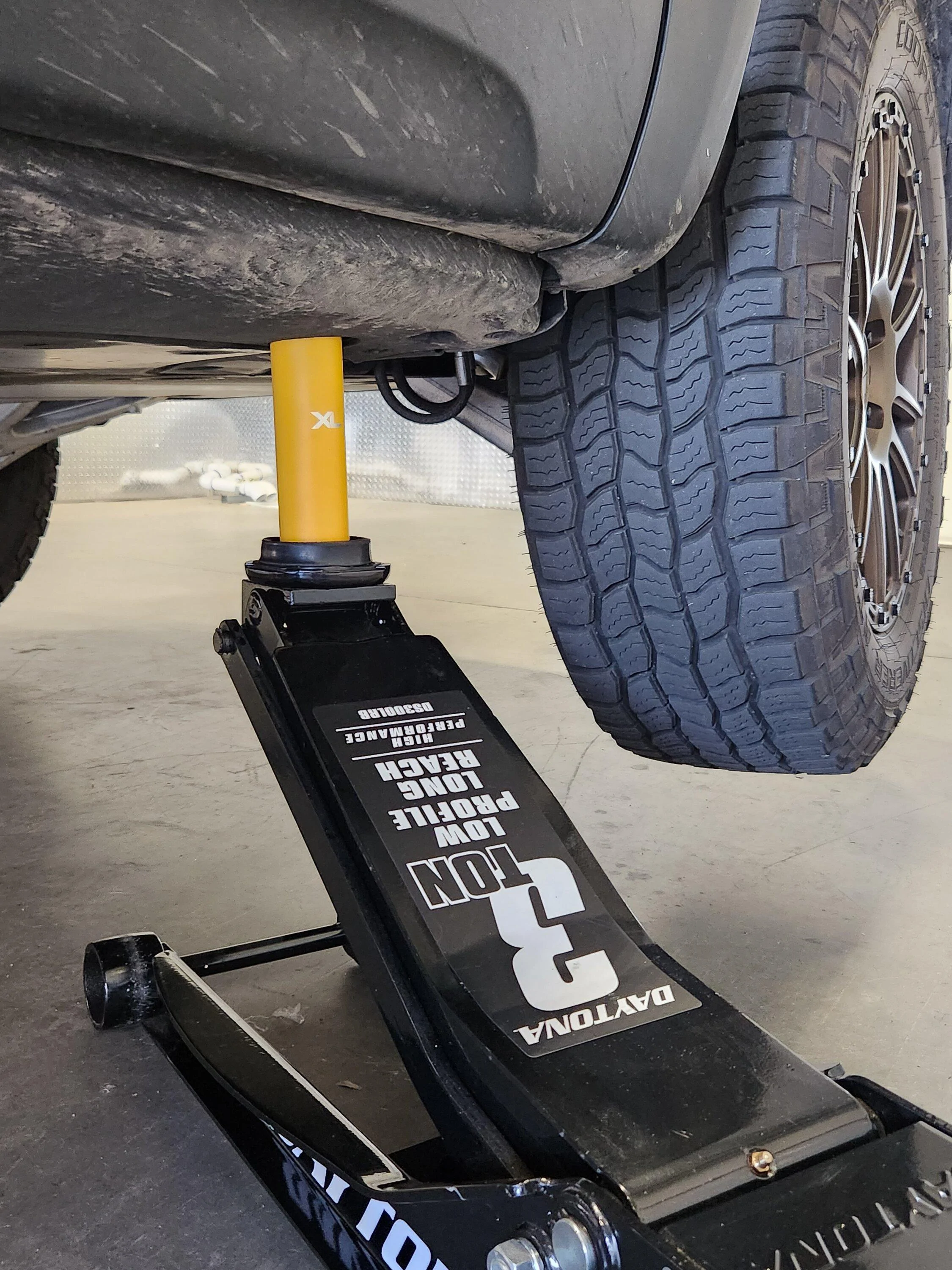

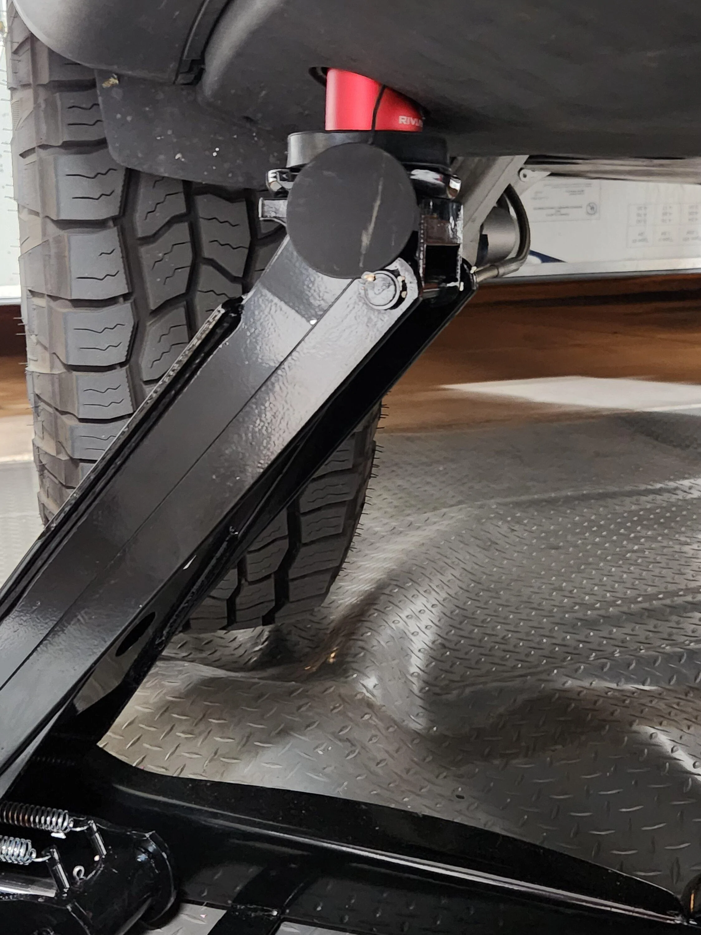

If you are purchasing a floor jack, get either of these (I use the Daytona 24" Lift):
Daytona Low Profile 24" Lift (You need 21"-ish to get the rears off the ground)
HF Dayton Floor Jack 24" Lift LINK
Rivian R1T R1S What jack should I use for tire rotations? 20231007_082209
Rivian R1T R1S What jack should I use for tire rotations? 20230523_202009

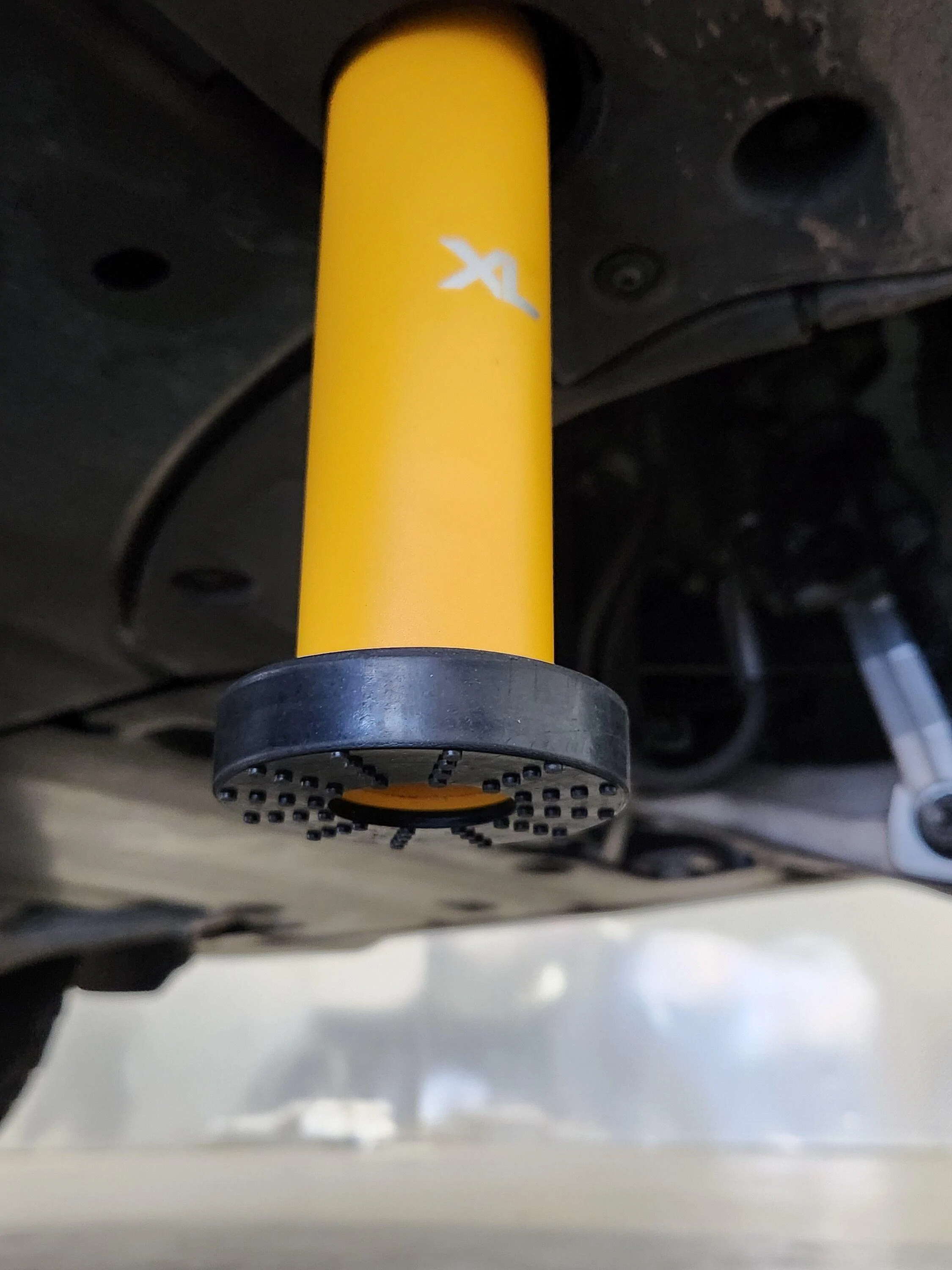

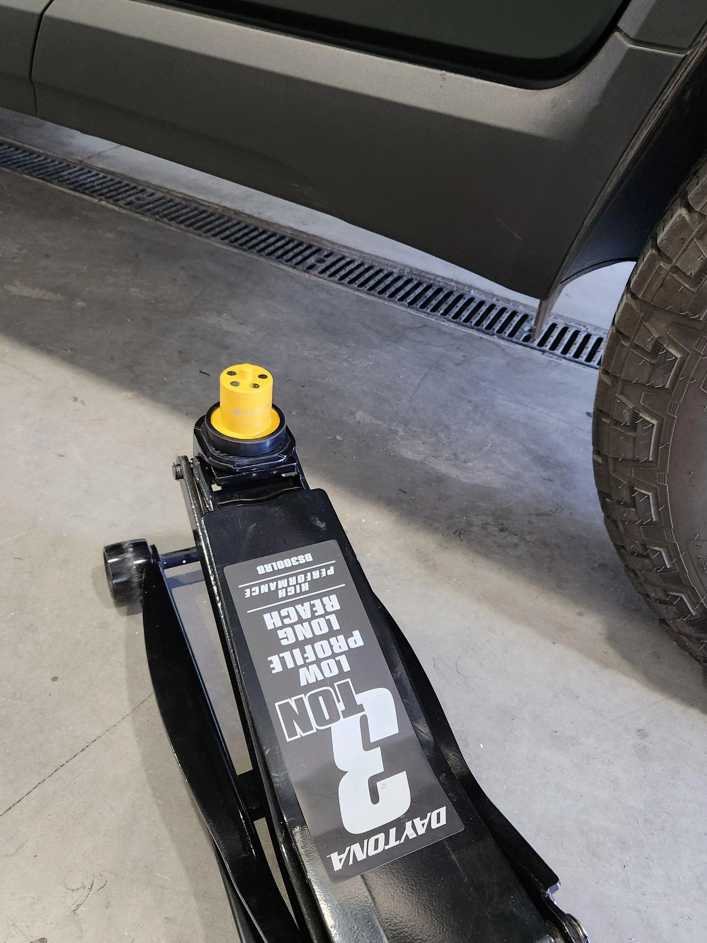

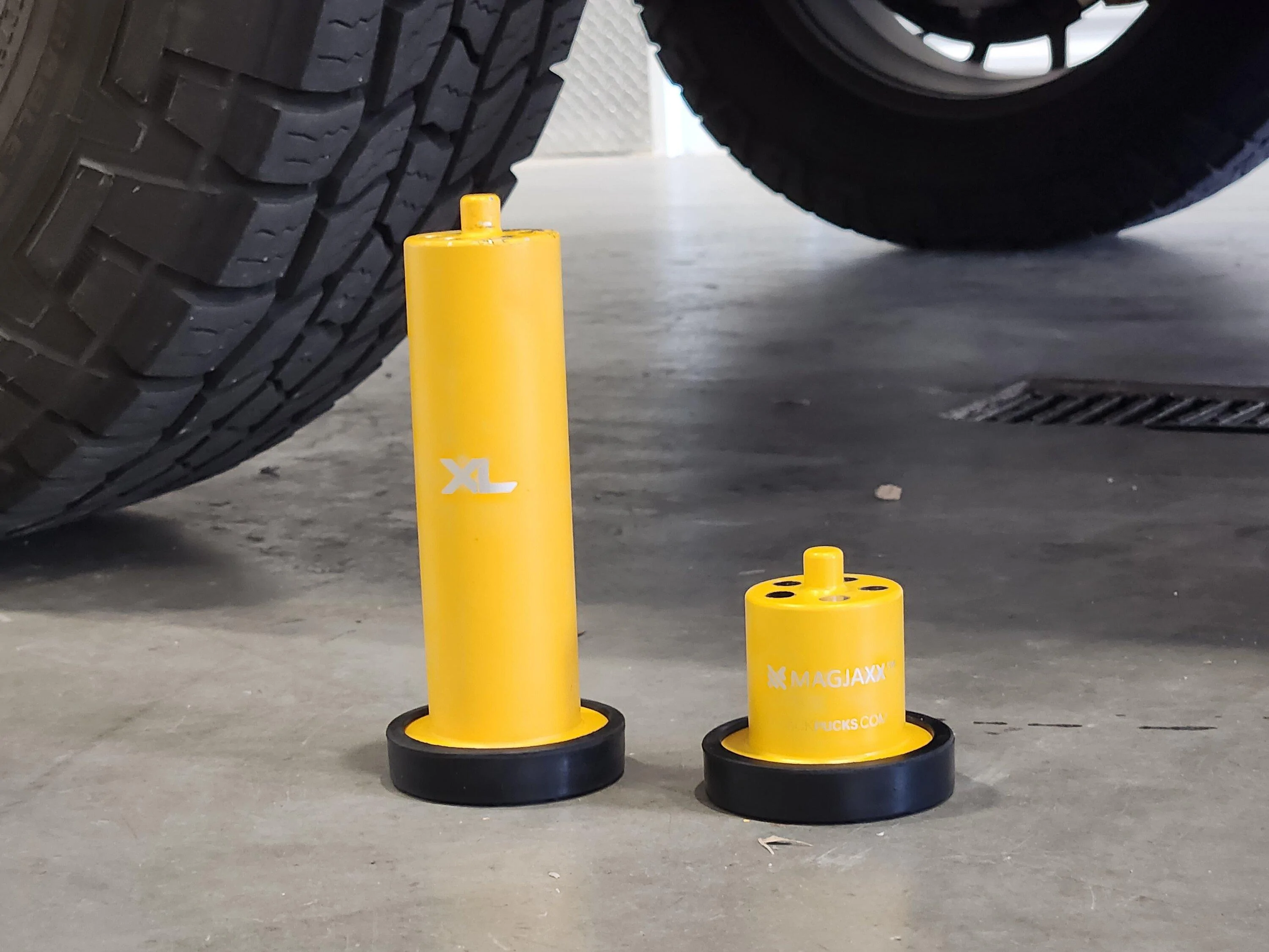

If all anyone desires is a single puck, then our new XL (shipping the end of next week) is more than 2x the height of our standard pucks. Off-roaders, overlanders and people who wanted to do a road-side repair (even rear) asked that I would make one for them, so I did. Works great for a road side tire plug (nail, screw, etc.), so the wheel never has to come off the vehicle.
It is also magnetically coupled and has more than enough lift with either the Torin Big Red 10T or most floor jacks that have 19" of lift.
Rivian R1T R1S What jack should I use for tire rotations? 20231007_081403
Rivian R1T R1S What jack should I use for tire rotations? 20231007_084504
Rivian R1T R1S What jack should I use for tire rotations? 20231007_084053
Rivian R1T R1S What jack should I use for tire rotations? 20231007_083914
XL High Lift Magnetic Jack Puck Pre-Order Link (Mid-Dec. Delivery)
5-Star Rated Magnetic Jack Puck Kit Purchase Link

  • Six (6) NdFeB high energy rare earth magnets locks the XL puck right into place on your chassis. We were first with magnets and we have more magnetic energy than anyone, full stop.
  • Multiple Lift Design: You can use a floor jack, bottle jack with integrated port (10T Big Red recommended), or a post style commercial lift.
  • Grip Tech Tactile Engineered Rubber Caps with 56 high traction points, practically eliminates slippage.
  • Rivian Owner Designed: 100% designed by a Rivan R1T owner (Mar. 2022 delivery), so you're supporting a local just like you.
  • 5-Star Customer Support with 1000's of Rivian Magnetic Jack Puck Kits sold!
  • 6"+ Plus of Lift
