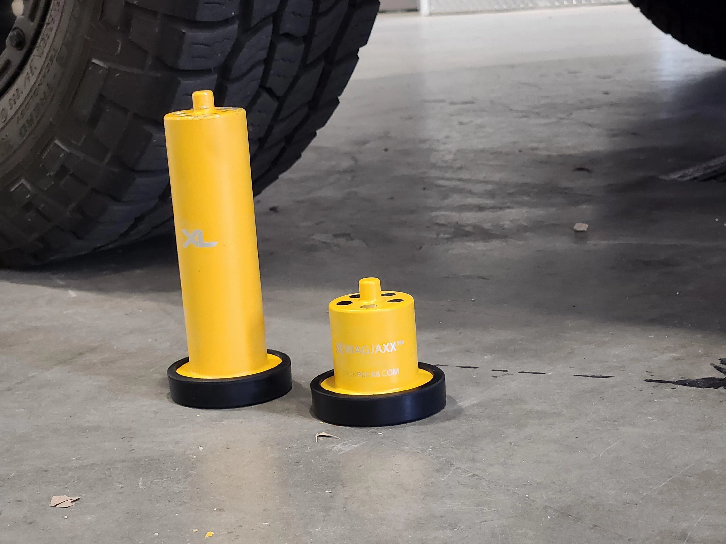

;).....I then use the floor jacks in the other locations with my beautiful Rivian Yellow Magnetic Jack Pucks ;)

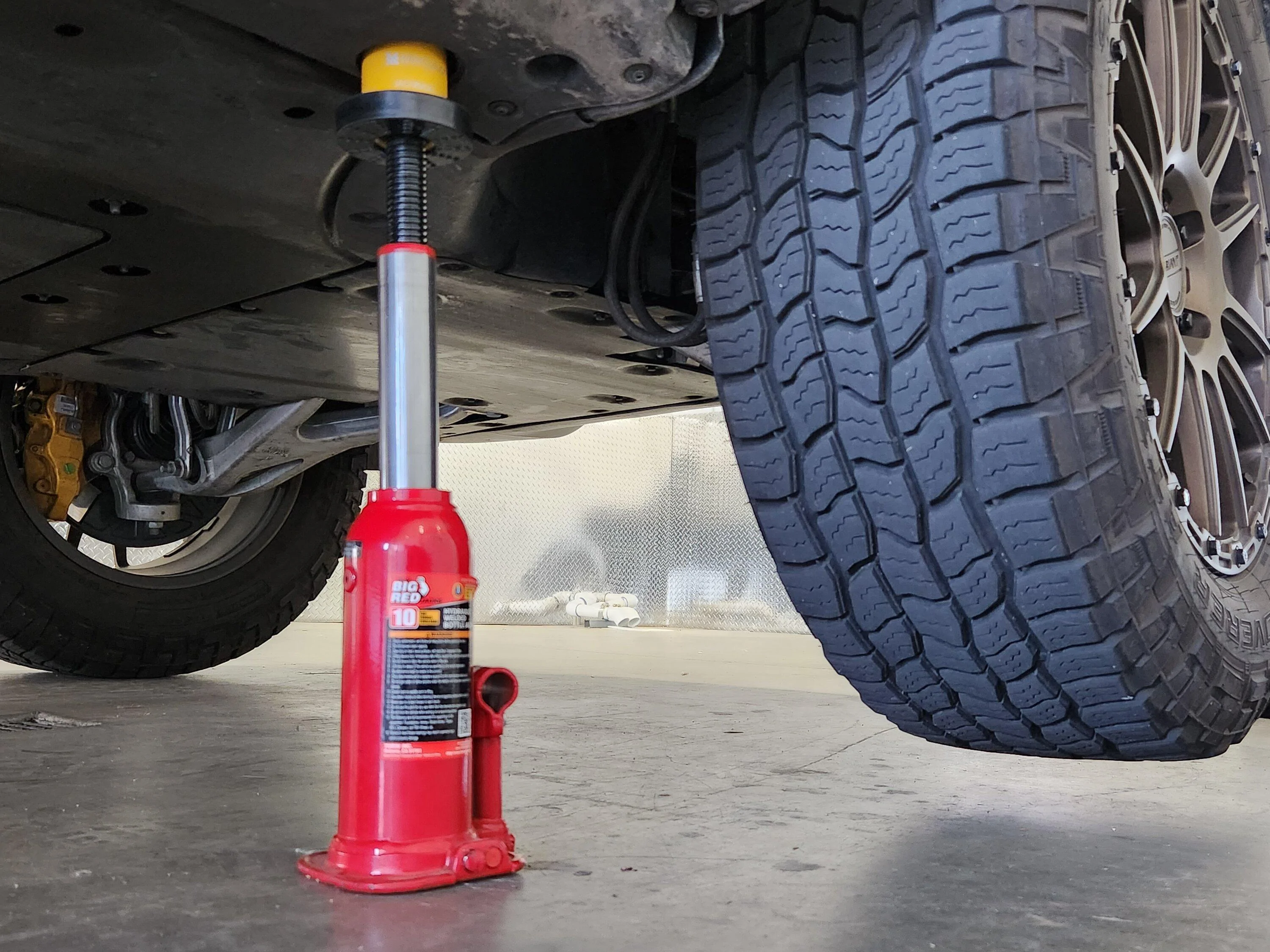

Bottle Jack Tire Change (even more no risk-it, no biscuit)

I have Bottle Jacks in the other two locations already in place for support.....

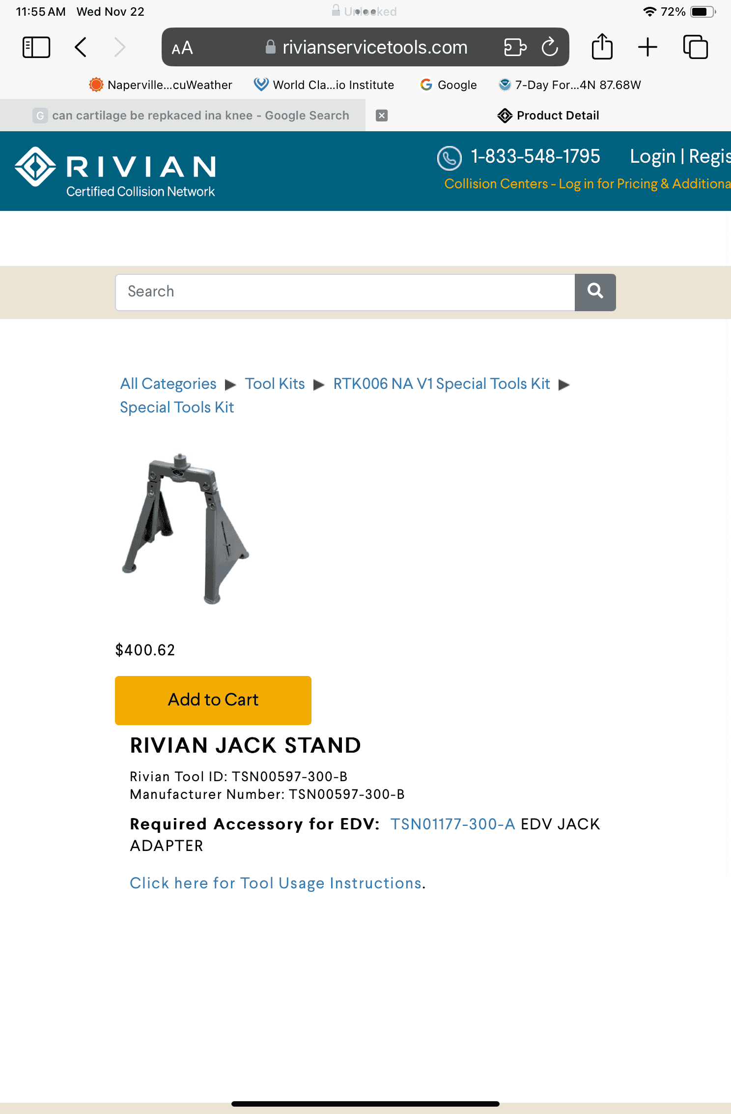

Just had mobile service out and to lift one side of the truck at rear they use the jack stand with a 3t jack to raise and position the stand and then just the jack with the height extension at the front. We learned if you have running boards you will need at least one additional puck to get needed clearance at the jack stand location

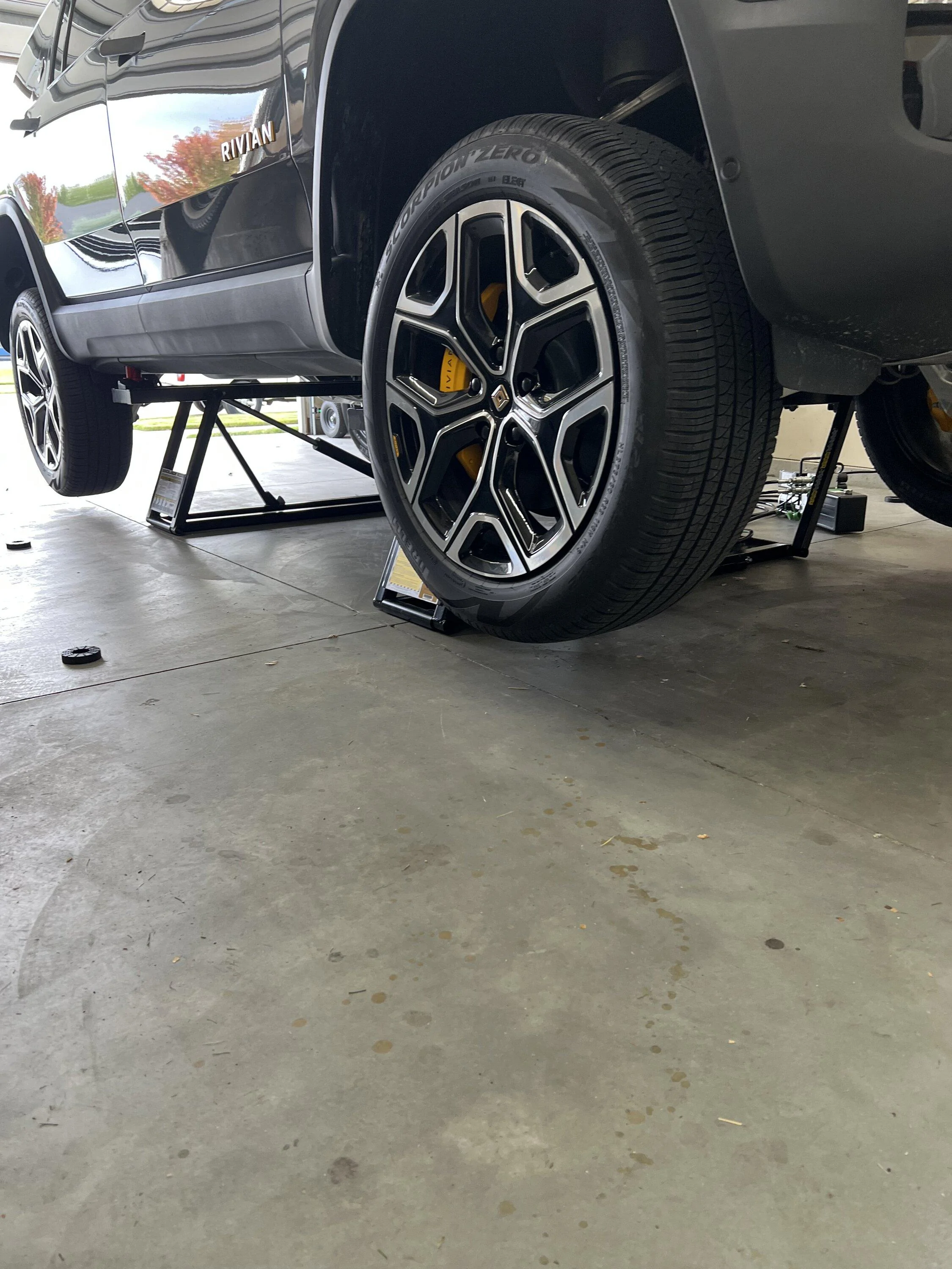

This is what I use. Works great. Rated for just enough to do the job. Prefer to do it myself cause then I know it’s done correctly. I’ve just seen tire people mess up to much stuff. Can also drink beer while doing it and not have to worry about getting a dui if I had a rotation at a tire store

Rivian uses this expensive take apart jack stand that it raised into position by a 3 t jack and the you set the pins into the height holes n the stand legs and remove the jack from under the stand

Someone had asked if anyone had used a jack stand, because most jack stands didn't have a flat top to put a puck on, so I sourced some. * My standard change is two floor jacks and two bottle, jacks, but I wanted to test the jack stand method, which I used the procedure below.
1. I use the two floor jacks to lift the entire R1 off the ground (wheels still on, lugs loosened). 2. I then place the jack stands in the two open positions (not secured to chassis yet, but close) with jack pucks in place.
3. I slowly lower the vehicle until support from jack stands is there
4. Option A: Leave floor jacks in place (as support) and rotate the tires.
Option B: Replace floor jack with bottle jacks and pucks (as support) and rotate.
Can you provide a link to this?
It's made by Rennstand. Where it is different from other other offerings is that this one has the puck adapter built-in. Cost more than a jack. Might as well buy a second jack. However, this is less likely to drop unintentionally.
