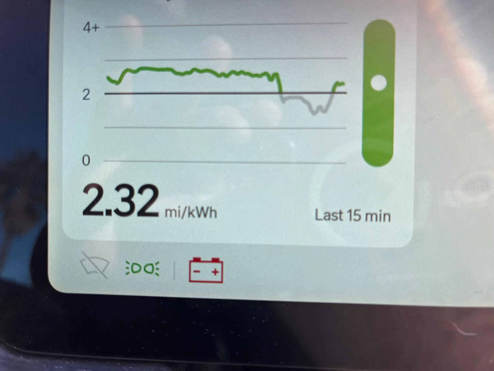

Update:
I kept the R1S plugged in for a week while we were out of town. I still had 5 days until the mobile service arrived, but needed to go a mile to my gym. "Thermocouple Error Warning!" on the dash shows up. I head out anyway. First stop sign and both axles start severe shuddering when reducing speed from 5 mph. What??? Same for each of the following stops. Extremely freaky and scary. They feel like the regen on both axles were cycling from hard stop to release several times per second. The R1S was not safe to drive. I was hoping that the error and shuddering were related to the 12v battery. I didn't want to take a chance on the freeway and had Rivian tow it to El Segundo on Tuesday. They arranged for an Enterprise rental car.
Communication from Rivian was non-existent and I found out that you can't call the specific Service Center; you have to call the Emergency Service number to get a live person. The Emergency Service people couldn't even talk to El Segundo. The Chat Box is a waste of time.
The R1S was ready on Saturday as noted in the App. They replaced the 12v battery. I requested a lithium-ion but they said it wouldn't work in a Gen1 (? not so, per the Ohmm web video). So I guess this lead battery will last 24 months.
The shuddering couldn't be replicated but the Service center did a Rear Drive Unit General Diagnostic, Firmware Update, and RIDE Programming and Calibration for "Goodwill provided in the interest of customer".
No more shuddering, no more errors.

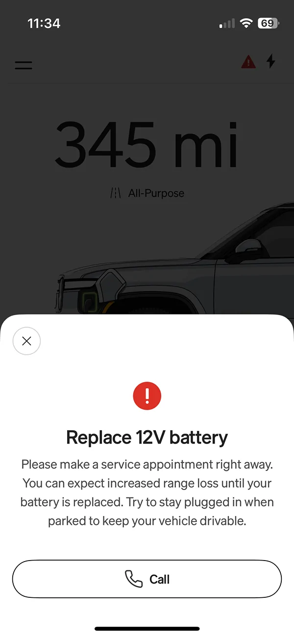

Just out of the blue, I see that Rivian was calling on 3/19. They said my 12v needed to be replaced and that it will take aprx 1 hour at the Shelton Ct service center.
I haven't seen anything unusual on the displays saying there was a issue. But I'm good with going in to get the work done.
My truck is maybe 15 months old and hasn't even hit the 7500 service. But stormbreaker has been performing well. Just wonder whether this will be a regular thing with the truck. Every year and half need to swap out those 12v batteries?

I received my 12v battery replacement needed notification, opened service ticket, they scheduled me for 30 days out, then called me back next day to tell me mobile service was scheduled for the next week.
Biggest takeaway from service on the phone with the initial call was just don't let the HV battery SoC get below 20% and things will be fine. The 12V battery doesn't hold as much charge or last as long as it used to and the HV battery may be called on more often to recharge the 12V batteries, hence why they recommend always leaving the truck on the L2 charger while parked if possible.
On a sidenote, I just pulled up my service invoice to find that Rivian billed me ($808.43) for the 12v battery replacement!!! Right off the bat, thinking about a 12v battery in a vehicle needing replaced, I expected to pay since I feel like a battery is a consumable. However when I made the initial appointment AND when the mobile tech was doing the work, both advised it was warranty covered due to the batteries being recalled or warranty swapped by the battery manufacturer. Just got off the phone and 800 Service reached out to the SC and they are going to process a refund check. Thank you once again, Rivian service for making it right.
