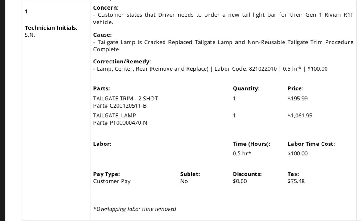

I just had it replaced on my R1T after bumping into something and cracking mine.
$1065 for the tail light.
$190 for the cap on the R1T lift gate that is one time use (all the clips break when you remove it)… and it has to come off to pull the large panel off to get access.
If you open a service ticket, they will ship you the parts if you ask them. But if you are near a service center, it takes less than an hour for them to fix it.

My invoice has the top trim. You can’t get to the screws without taking off the panel, and you can’t remove and reinstall the panel without breaking the top trim piece.
I will say, the new top trim piece is better than the original one. I still wish one of the aftermarket guys would come up with a better end piece and back panel.
