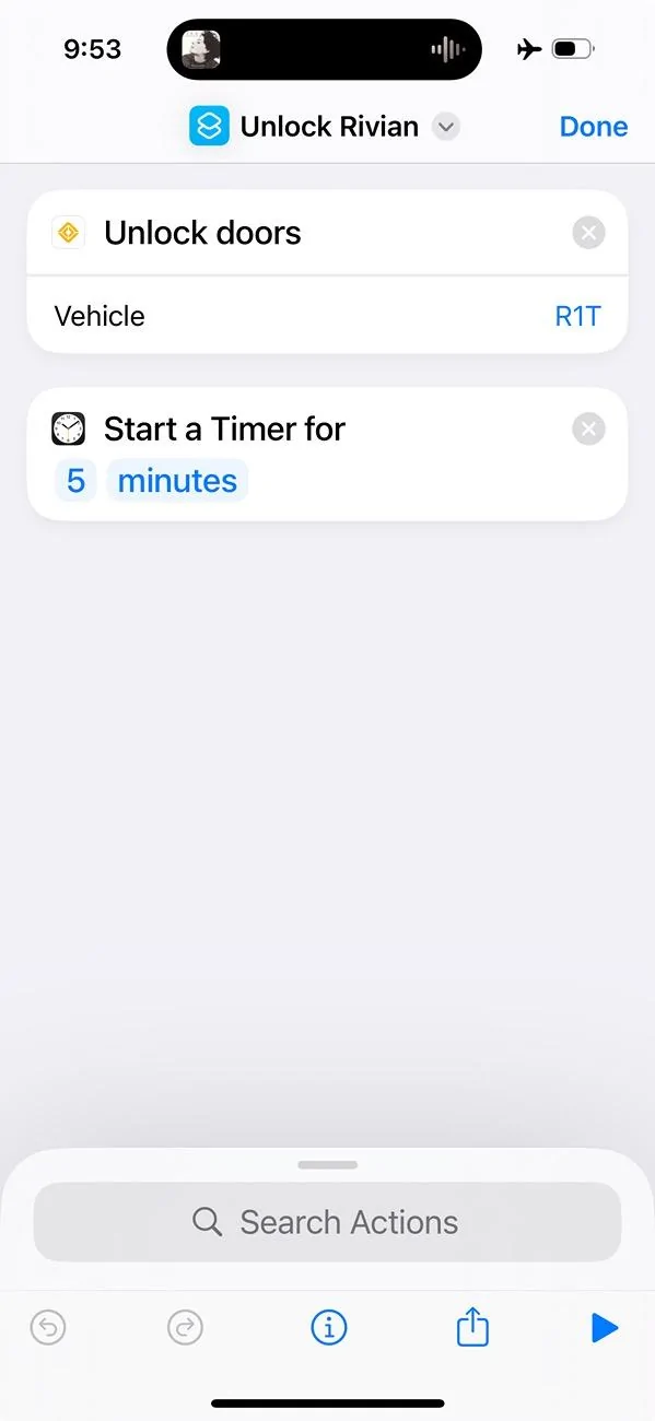

This is how I learned that I have a habit of tapping my phone subconciously in certain cases.
I use my Watch action button to start HVAC, vent windows, wait, close windows, and then tell me it's all good to go. Just unlocking would be trivial, yes. I have a voice shortcut for unlock with a timer because I'm retarded and will forget it's unlocked.
