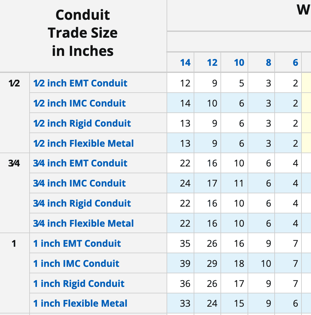

I use EMT for home projects like this. It's relatively cheap, cuts with a hacksaw, easy to install and support, and Lowes and Home Cheapo have all the fittings, including 90 degree bends, on hand. You could use flex where you have bends as well. 3/4" is fine, allowing up to 4 #6 conductors. I would pull a neutral for future proofing.
If you use flex, you should run a ground conductor. Properly installed, EMT can be the ground path. However, flex can be the ground path only when less than 6 feet long.

Yes I will likely run a future proofing neutral and definitly a dedicated ground. Conduit/flex not sure yet. My run is short but will have about 4 bends. Sub panel up then right/left/down/back of charger.
