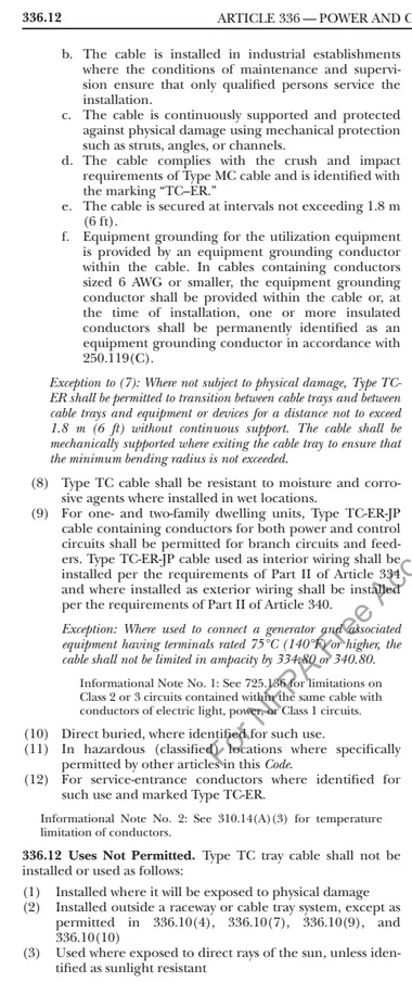

I assume you want to use this cable assembly to avoid installing conduit?
Per NEC, the cable you are looking at (TC-ER) cannot be installed exposed or unsupported . It requires some sort of supporting cable tray or raceway. See 336.10 below.
However, per 336.10(9) if you use TC-ER-JP which includes an additional low voltage wire pair, you CAN use it residential exposed, install just like NM (Romex) as per the reference to Article 334 Part II.
Yes, I know it makes little sense, but the code is the code and if you are getting inspected, a competent inspector will fail TC-ER exposed in a home.
The reason they allow the exception in 10(9) is for TC-ER-JP is that generator installers use it, and HVAC installers use that type of cable for mini-split residential installations, where the power is fed to the equipment on the larger gauge wires, with the control signal on the low voltage pair.
