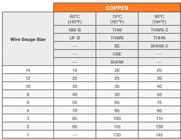

You can't run 6 AWG Romex (NM-B in the chart below) which is rated for 55amps off a 60amp breaker, as the breaker can't have a higher trip rating than the circuit wire max capacity for obvious reasons (think of a short circuit which would allow 60amps to run through the 55amp rated wire).
4 AWG Romex would probably be easier to run then installing conduit and pulling 3 or 4 THHN cables through it depending on how many twists and turns it makes.
It's a little concerning that the electrician was willing to install a 60 amp breaker on 55amp rated cable because "it will not exceed 48 amp load".. well accidents happen and that's why we use breakers in the first place. Secondly, a 55 amp rated 6 AWG Romex cable needs to be derated by 20% under "continuous load" (which is how our EVSE's are classified) so that would be 44 amps max load, not 48 amps on that 6 AWG Romex.
Mine unfortunately ran 6-3 Romex to a 60 AMP breaker. I set my scheduling at home to charge at 42 just to be under that 44 upper number. He swears I'm fine at 48 but I'm not going to risk it when I don't need the speed. The Rivian charger is set for 48 as well but should I just change the dip switches to 40 on the charger to eliminate all the workarounds? No one else would ever use my charger but me and it's my first day with it so just trying to weigh out my options.

I would set it to 40 and be done with it. That way you will not run into a situation where you forget to set it in the truck.

I just ran 6awg in flex metal cable. It should be ok at 48 A. It is rated at 65 A at 75 c . Despite that as an added precaution I may set my charger dip switches to 40 A. As many have pointed out here if it take 5 hours to charge or 3 it makes no difference to me between midnight and 6Am, and May be better for the batteries.

Romex is technically not code on a 60a breaker running 48a circuit. However, many inspectors will allow it, and the local inspector is the one who has final decision on the install. This is extremely common in CA and other EV dense areas, which is why so many electricians push Romex. It's also significantly easier to work with and cheaper.
Remember, the wires inside Romex are acceptable for the circuit, but the Romex jacket is not rated for the temps of a 48a circuit. If you are installing in interior, loosely climate controlled areas (IE, not an attic), you will almost assuredly, never have a problem. There would be enough heat dissipation.

6awg romex is not to code. I used 6-3 awg xhhw-2 that came in 3/4 flexible metal conduit. Was about $3.50/ foot. 65 amps at 75 deg C. Has better thermal ratings and flexibility than thhn. fittings are common at the big box stores.
