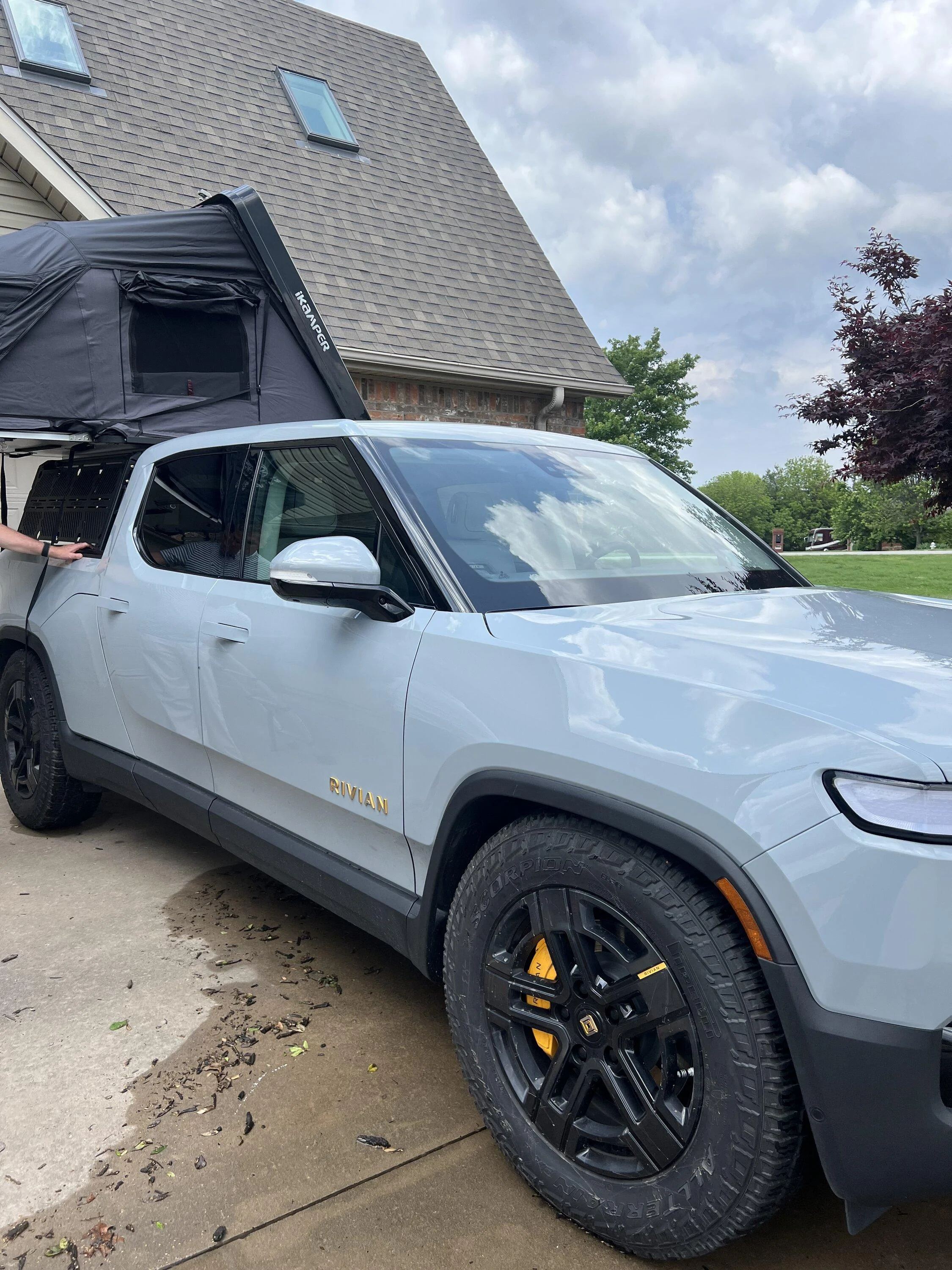

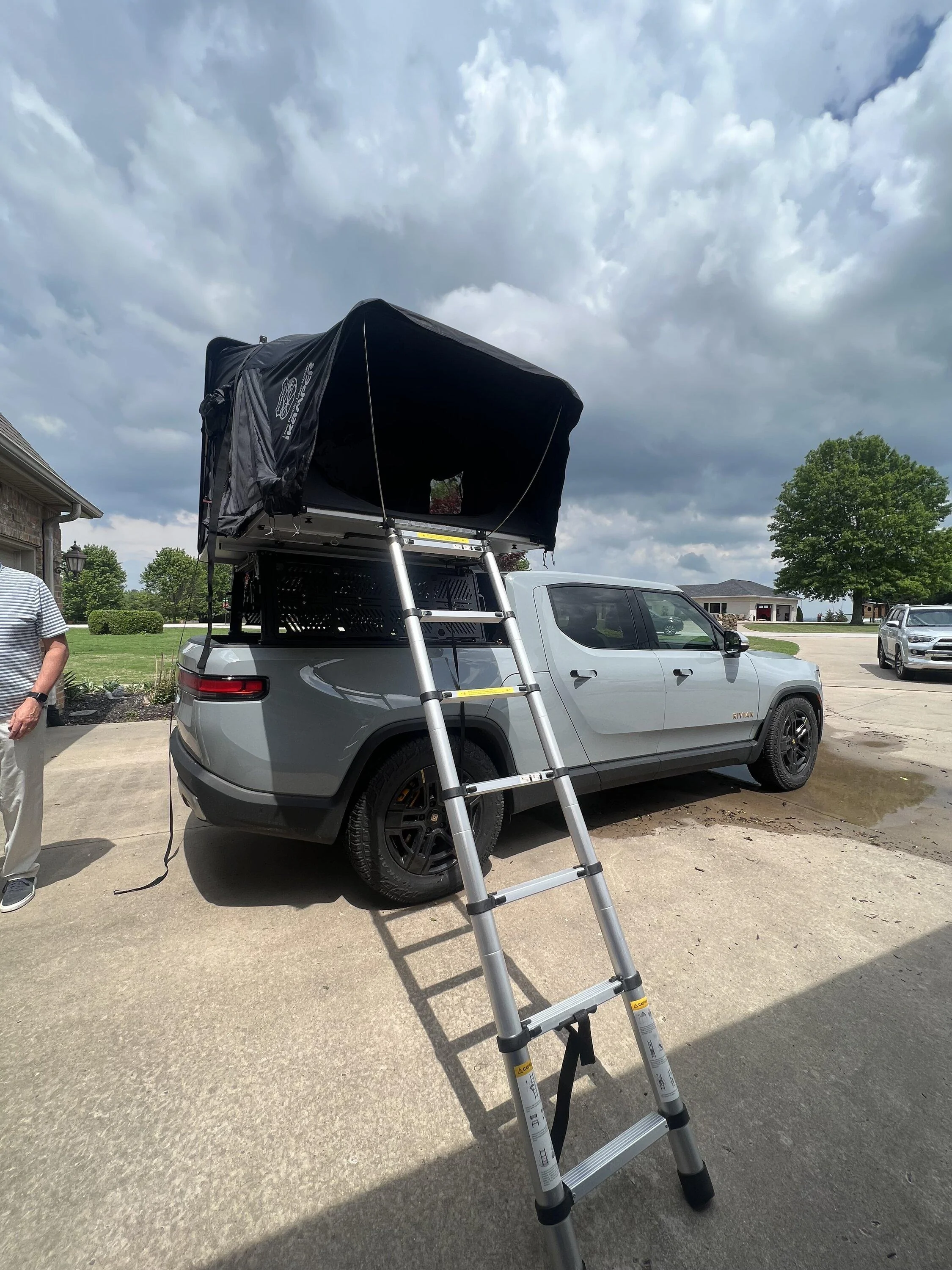

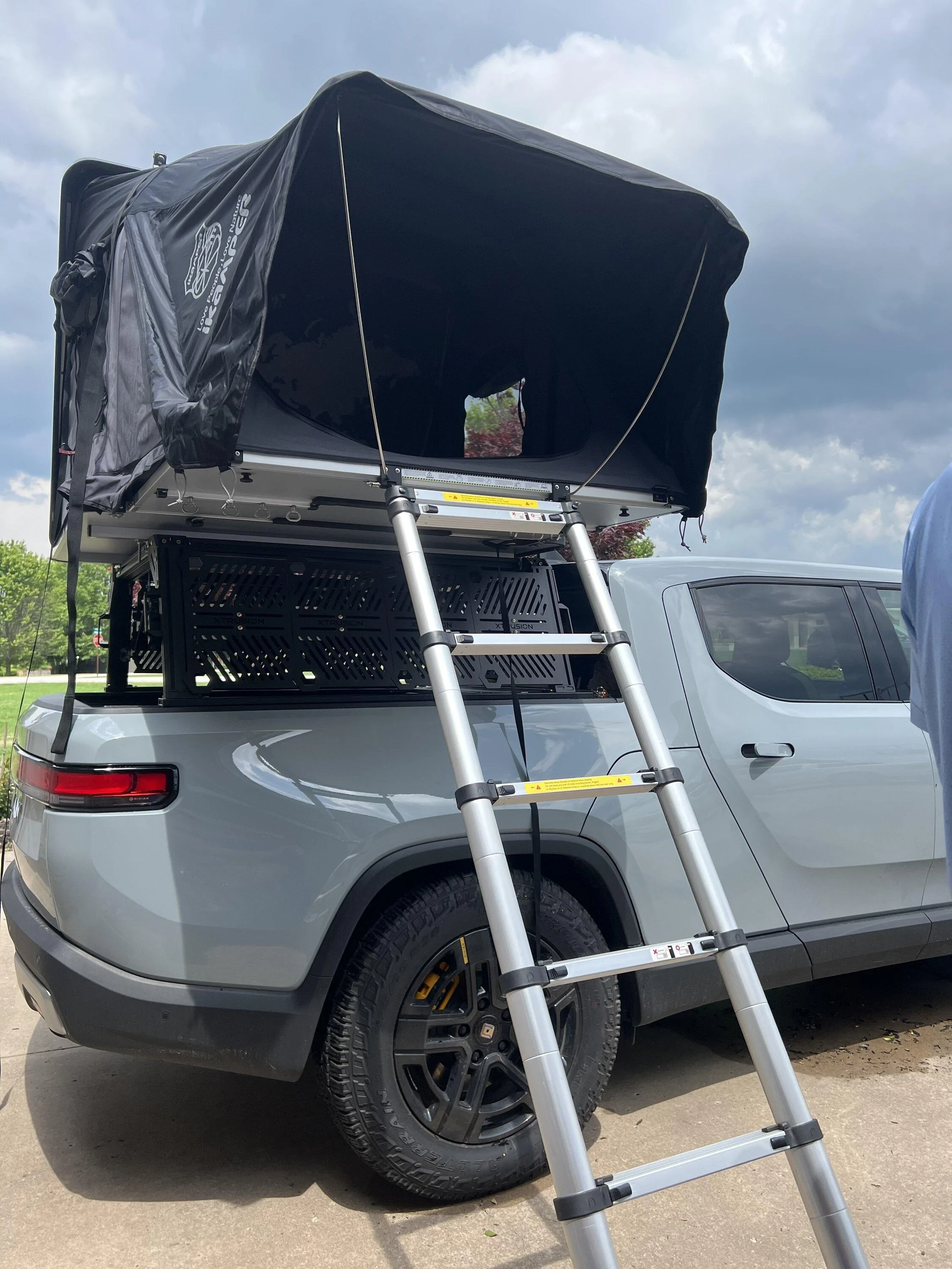

Do you have pictures of your completed (or current) setup? I saw in the other thread it looked like you had the awning mounts on now as well.
My setup is still a work in progress… but I did briefly test mount the 3.0 mini this past weekend. Here’s a couple of perspective photos
Rivian R1T R1S Xtrusion OVRLND rack install experience on R1T IMG_3039
Rivian R1T R1S Xtrusion OVRLND rack install experience on R1T IMG_3040
Rivian R1T R1S Xtrusion OVRLND rack install experience on R1T IMG_3041
I’ve slid the RTT to the passenger side of the rack trying to make room for the awning mount on the driver side. But I’m still tweaking that setup to avoid hitting the rigid back of the opened tent.
There are so many configuration options with these XO systems that I think you’ll always be tweaking your setup.
Looks great. The ability to make it anything you want is both a pro and a con, constantly changing things could be a problem.
On my stock cargo bars, I had to shift my tent ( bed mounted Condor XL) to the driver side by about 3.5 inches to not hit my 180 degree awning on the roof bars. I am thinking with a 19 or 20" XO rack I might be able to mount a 270 degree awning, and not need the roof bars (well maybe for the shower). Of course then it will too heavy to lift with my current garage hoist, so that will need upgraded, and so the cycle continues....

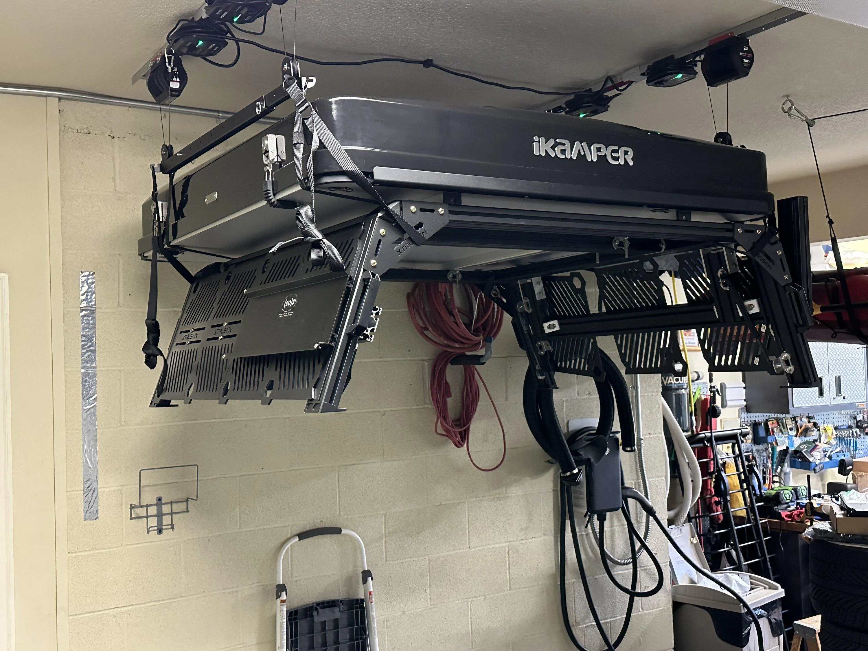

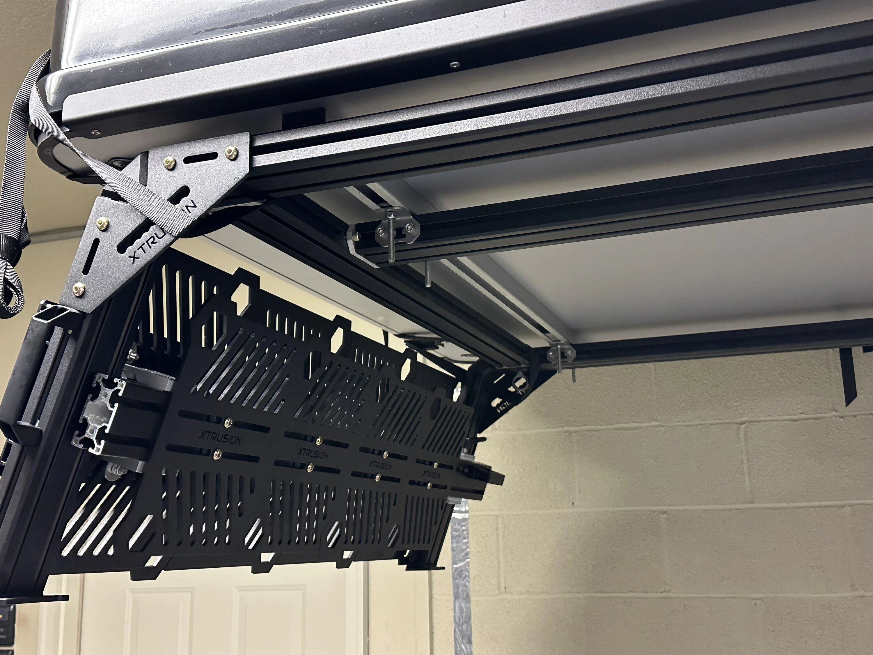

This looks fantastic. A few others have asked but I didn’t see a reply…do you think removing (and reinstalling) in the future is too cumbersome to consider? Are these essentially on permanently for you?
I bolted the RTT to the rack…then hoisted the entire assembly to garage ceiling for storage when not in use. It takes about 20-30 minutes to install or remove but the hoist allows you to do it solo.
PSA: ensure your bed rack height (with RTT mounted) will fit under the garage door header. My 18” rack with Skycamp Mini just barely fits. YMMV.
I’m curious what hoist system you are using here? I’m looking into a similar setup. Thank you.
