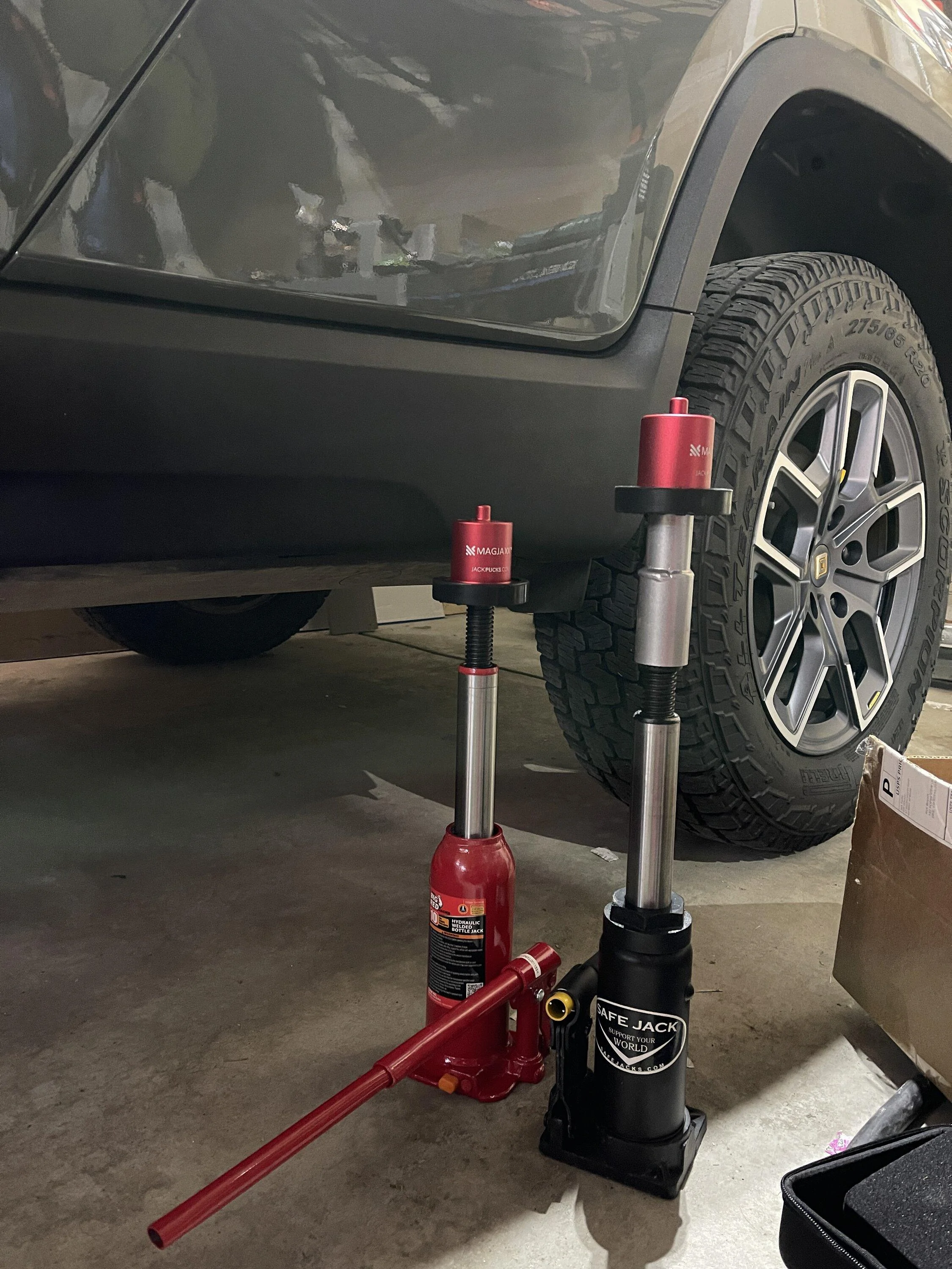

Hi Mark,
When using that Big Red jack in this pic, did you have your Rivian in the highest suspension setting? I haven’t actually tried jacking it yet but it doesn’t seem to go high enough when the Rivian is raised all the way as prescribed in the owners manual.
Just a comparison next to a SafeJack with my R1T in the highest suspension setting..

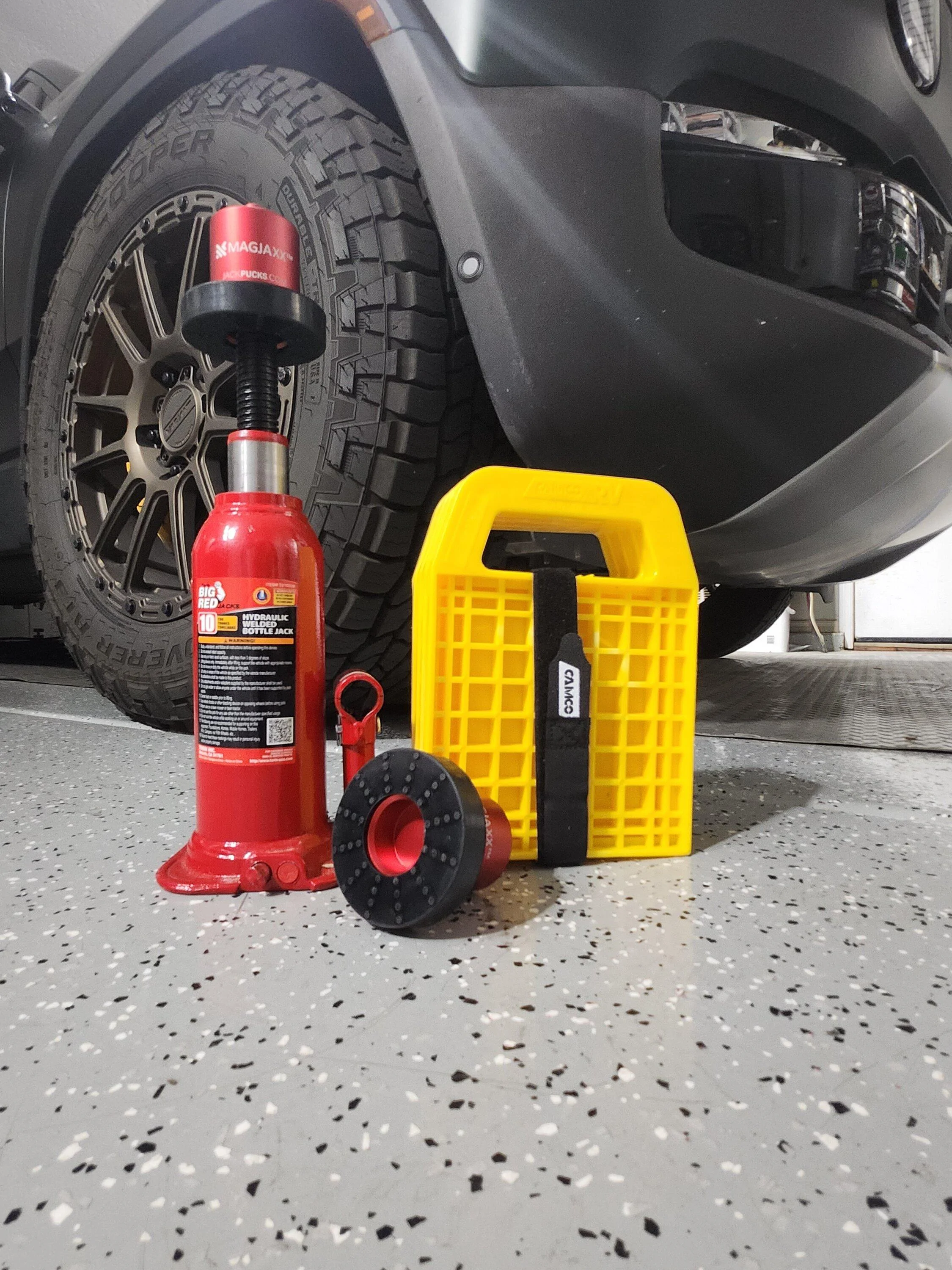

That is a great photo! I use the OEM tire change procedure. The Rivian rear suspension has a little more droop than the front of the vehicle. I will use either a second puck (stacked) or an RV jack base (pictured in yellow) for both soft road surfaces (dirt and sand) and additional height for the rear only. I find using the RV jack base (hard rubber preferred) is the preferred solution.

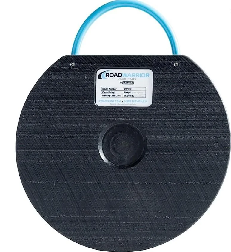

A customer recommended this RV jack base and it looks to be an even better solution (2" model) for the combination of added lift, and other road surfaces (dirt and sand). I've ordered one myself to test. People are constantly finding solutions that best fit them. You gotta love that thinking process!

Did you try Road Warrioir 2" base with 10T Big Red? I am assembling a road kit, got your pucks (they are great), and 10T Big Red. I try to understand if I need the base or not - my understanding I need one for the rear wheels, correct?

Thank you for the positive feedback on our pucks. These are all designed to be a solid interface between a lifting device and the chassis of the vehicle, yes, you do need additional lift in the rear with the combination that you have. I have the 2 inch base here, but I've been traveling quite a bit and have yet to confirm that it works perfectly.
At least two of our customers are using that exact setup and they have tested it on flat surfaces and say they are able to get the rear off the ground. 2 in is right on the cusp but I will do that myself here shortly and let everyone know as well.
