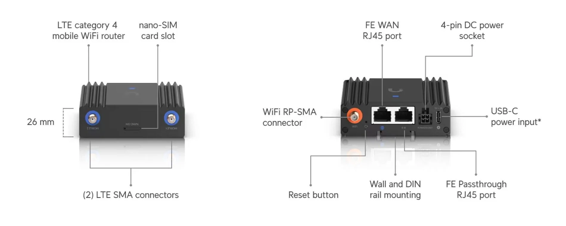

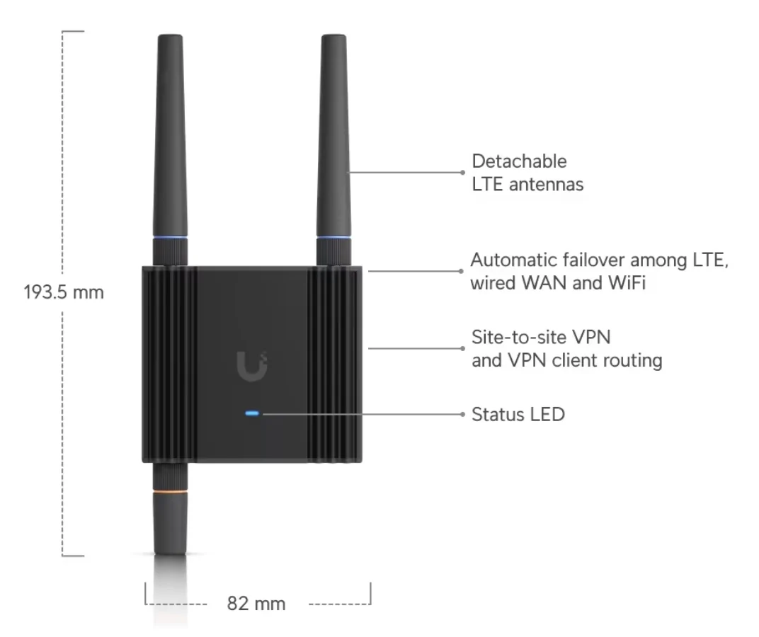

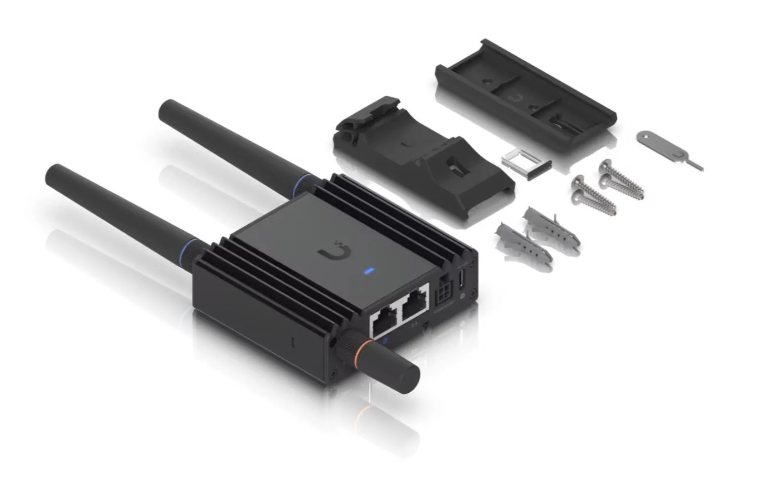

Again thank you for all the details. Given it’s so cheap I might just get one in any case.
I have been doing some more research myself and being a longtime Ubiquity customer they offer an interesting device as well:
US Version
https://store.ui.com/us/en/products/umr-ultra-us
EU Version
https://eu.store.ui.com/eu/en/category/mobile-routing/products/umr-ultra-eu
The European version supports all the right bands for 3G and 4G LTE.
A bit more expensive at €95 but with detachable LTE and WiFi Antennas and I can manage remotely through my UniFi account.
There is also a US version in the US store but it does not list B1 and B3 - everything else seems identical.
