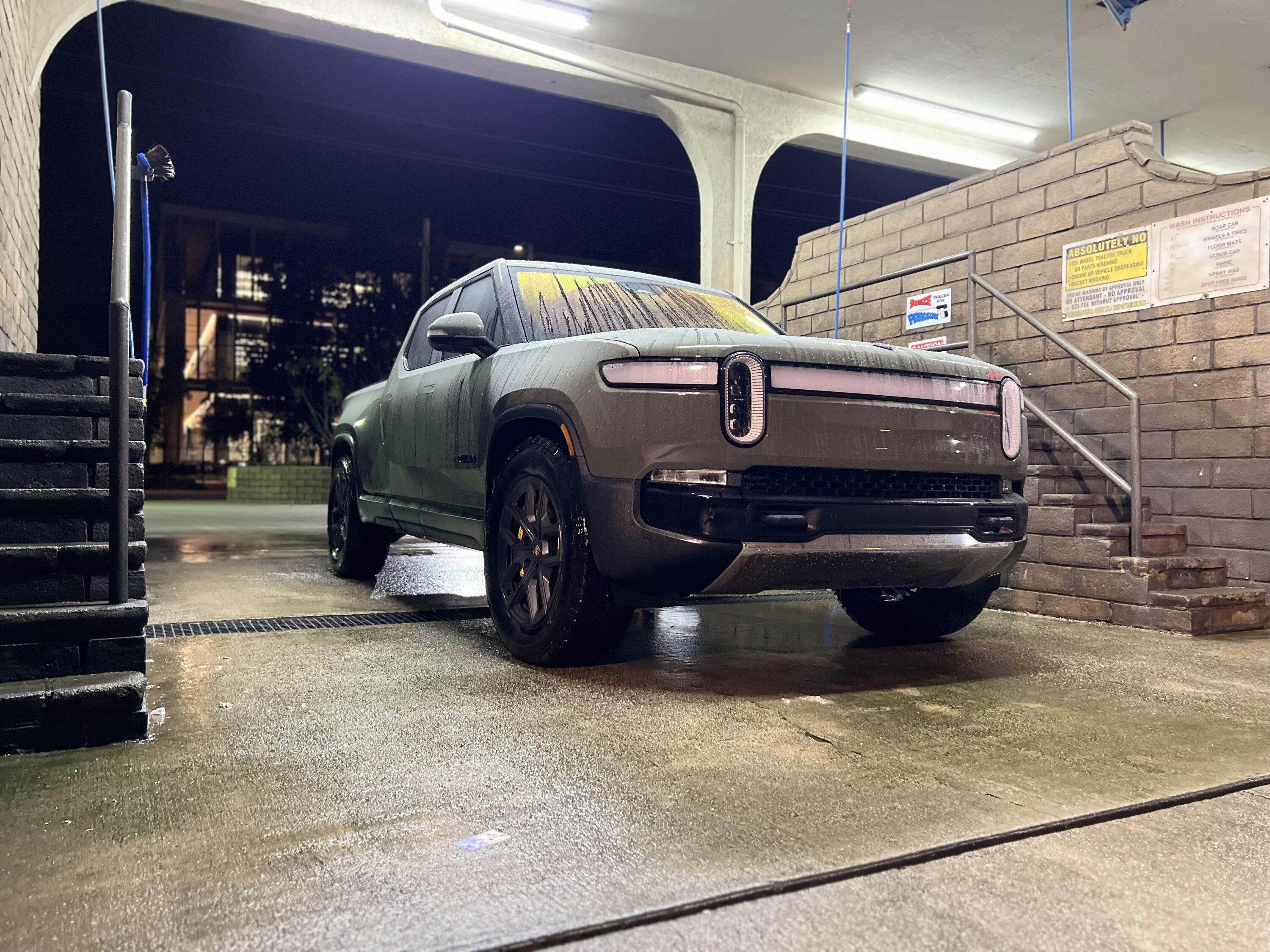

Best 20” AT Tire for Range - Please Help!?!?
It is becoming hard to wade through all the tire discussion. Getting Black Rhino Voltaic put on. In search of folks with some experience on the best AT tire for on road range. I get that there are better options for range. I am looking for best of all worlds (of course haha). Range is king.
TYIA for those who will share useful guidance and not Shame another tire poster haha
