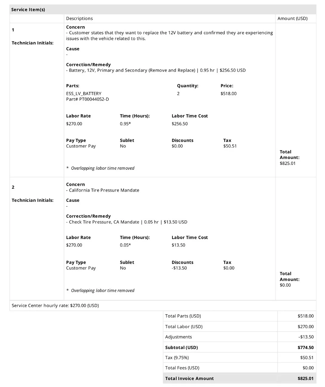

How much is total ?
For me they gave $259 discount (one free battery) total $518
They gave me no discount, even though I mentioned others were. I walked out of the service center, and I’m getting the ohmmu sodium batteries.

How much is total ?
Well, confusingly the pre-visit estimate I signed was for ~$750, but after they left I got a bill for $260 total. The parts line lists only the primary battery, but the resolution line says "replaced primary and secondary battery."
