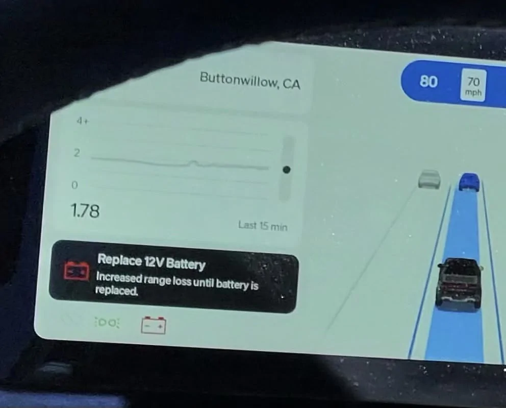

That’s funny, just got same message this morning.
My battery was proactively replaced by Rivian just this past October.
11 months life span on a 12v battery is concerning to be honest.
Interesting indeed. Is it a Dual battery or a Single one?
How often do you L2 charge at home? Daily? Weekly?
