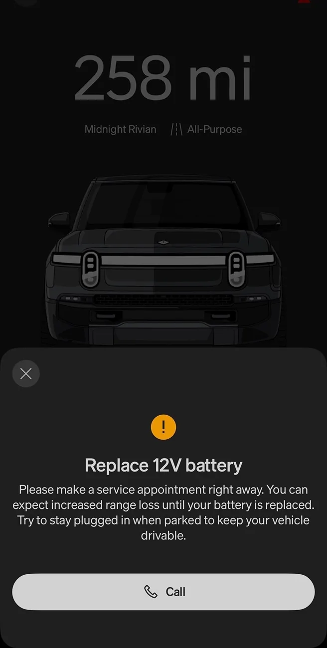

I dropped off my vehicle for the same 12v battery message. I got one last year and now within 12 months I got another 12v battery message.
It sounds like Rivian will step up and cover it under 2yr replacement battery warranty even though I am out of the original 3yr / 36k battery mileage warranty by couple thousands miles.
I like the good news from Rivian that they will provide a service option where we clear the error code after the swap. I think down the road I might look at after market options but for now I hope this replacement lasts more than a year or two.
