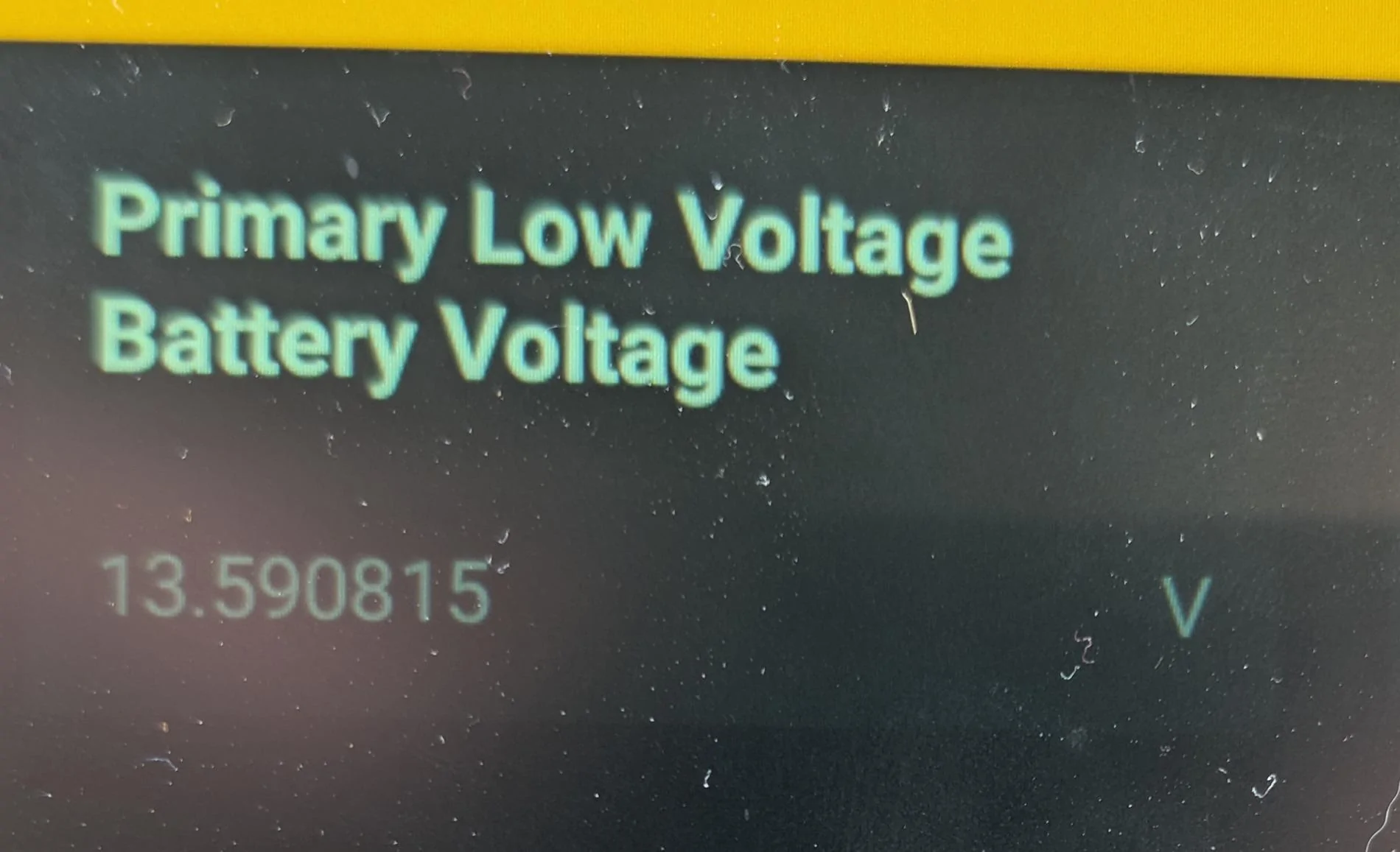

Small update, I got curious and decided to look at the RIDE menu to see my voltage (ignore the dust):
Rivian R1T R1S 12v Lead Acid Battery Replacement 5b2a47b8-bac1-4460-a47e-bcc87207a15
From what I have read, this is actually the normal voltage for the 12V. Is that accurate? If so, why did I get the replace message? To be clear, I checked this while unplugged and after a drive.
During a drive, or when the vehicle is 'Ready' - yes. Stable is ~12.6v and charge is ~14.35v.
Interesting. I wonder if this is one of the reasons Rivian doesn't seem very concerned about my issue. I suppose the real test would be to unplug it for awhile and check the voltage then, but I'm kind of nervous to do something like that. I'm also curious to know what metrics cause the alert to trigger, like is it charge/discharge rate, voltage, maybe both, or something else?
The tell tell point is the frequency of 12v recharge. My voltage (brand new batteries) is the same-ish as yours, but it can go 16 hours in sleep without a charge (wake event)

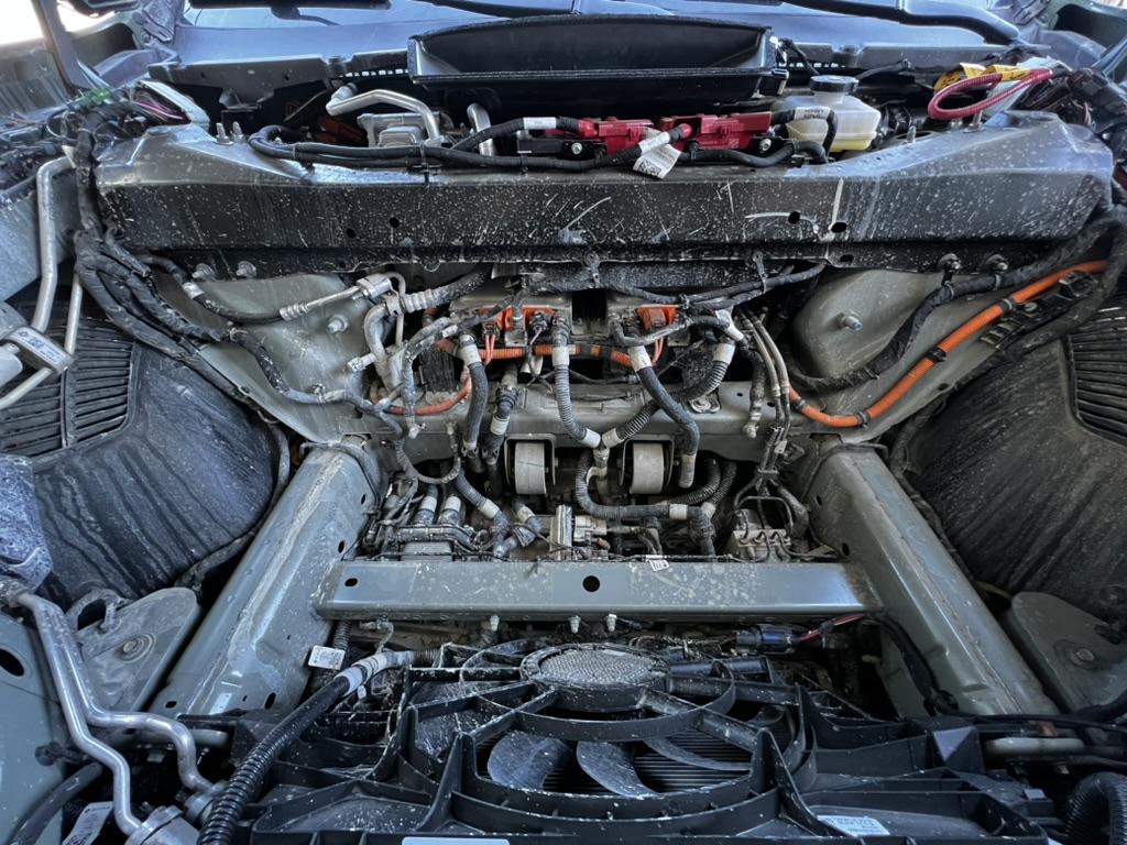

The first thing the technician did was disconnect the 400V cable.
I'm looking again at the photos I took with my frunk tub out, and I don't understand why they would need to touch any of the HV connections. There's none in the direct area of the 12v batteries, unless I'm missing something. Which one did they unplug?
Rivian R1T R1S 12v Lead Acid Battery Replacement 1729910820911-38
That thingy I think is the one they unplug. Purely for safety and no other reason. I might assume that it's also to avoid the DC-to-DC charger to try to supply voltage to the 12V when swapping them out, but just my imagination.

Yes, it is the red cord which carries 400v, this wire is positioned for easy access by firefighting personnel. The yellow labels indicate where is cable can be sheared in an emergency.
I believe the HV cable was disconnected as a safety practice by the technician.
The red cord does not carry 400v. It carries 12v to the giant relay contactor that connects the battery to the rest of the HV system. So pulling that loop disconnects the battery from the HV system by way of a relay.
Bingo. Sounds like a safety step to make sure the sudden drop of 12v doesn't kick the contactors closed to charge the 12v battery they're in the middle of unplugging.
