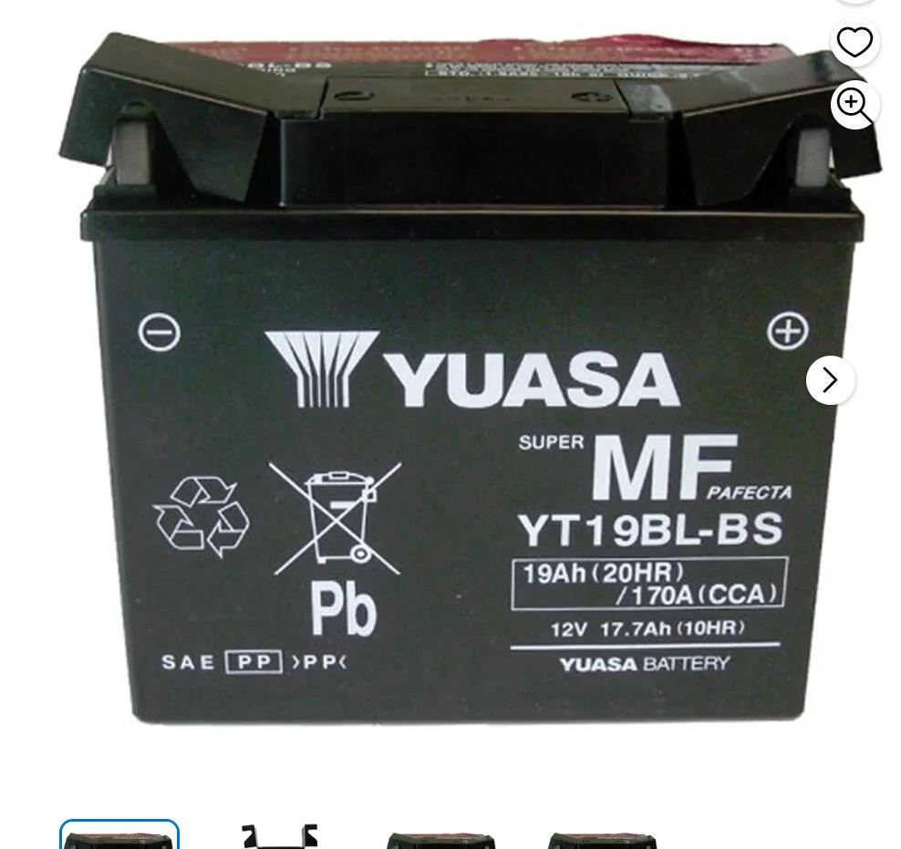

That Walmart link to the Yuasa YT19BL-BS looks to have a different style of terminal.
Yeah, the Rivian OEM batteries use a top post with the bolt hole running on the vertical axis. That Yuasa battery has the mounting holes running on the horizontal axis. You would need to make some sort of 90deg elbow to adapt the Rivian cable tabs to the Yuasa battery tabs. It's pretty tight in there with stiff heavy cables. Not easy to make mods in that particular location unless you're very motivated.
