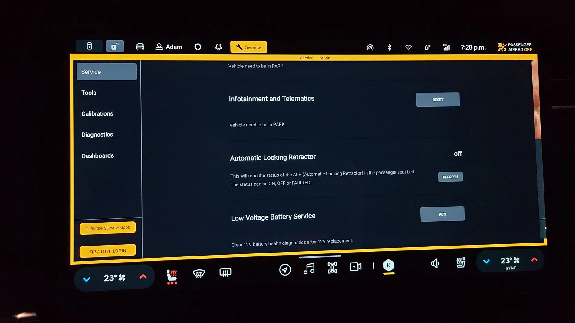

My LVMS was displaying a value of 1.0 when I dropped it off at Rivian for regular service when, shortly after dropping it off, I got a notification via the app that my 12V was in need of replacement.
Since getting my truck back with the replaced battery, the value is at 0.0. To be honest, I don't remember if anytime I was in the service menu previously over the last year or so, if it ever read anything other than 1.0 until now.
Thanks.
If I can't get that resolved on my own, I have a service appointment on the 20th and they can look at that as well.

There is a 12v reset in the RiDE menu, I've seen it under the calibrations menu I believe, I'll take a photo of it when i get to my truck in a bit.
Thanks.
All I have in the Calibrations menu is for internal sensors and seat positions.
2024.11.02

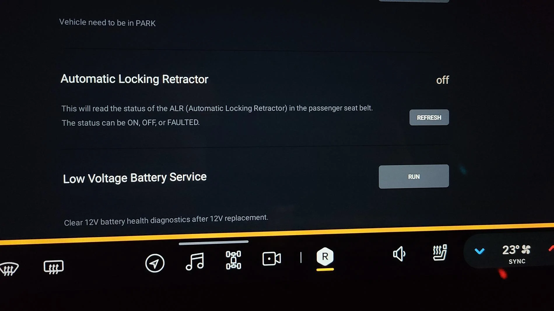

As soon as you login to RiDE, it's at the very bottom of the main page. This is on 2024.43.01 however.
Thanks for that screenshot. Yep, such a thing does not appear on mine with 2024.11.02 software. Tried doing the software update and it gets about 2 minutes into it before aborting and complaining "Not ready for updates. Your 12v battery needs time to charge. Try again later."
Guess I'm in a catch-22 situation. I'm sure they can resolve at my service appointment next Friday. In the meantime, the truck seems to run fine.
If you manage to get Rivian to mark it safe for an update (doubtful with a 12v warning), you should kill two birds with one stone.
So you went into the RIDE Menu and no 12v reset is present? Or you could not get into the RIDE Menu?
It wasn't there on earlier versions. I actually remember the first time I saw the button was on a recent-ish version (August maybe?).
