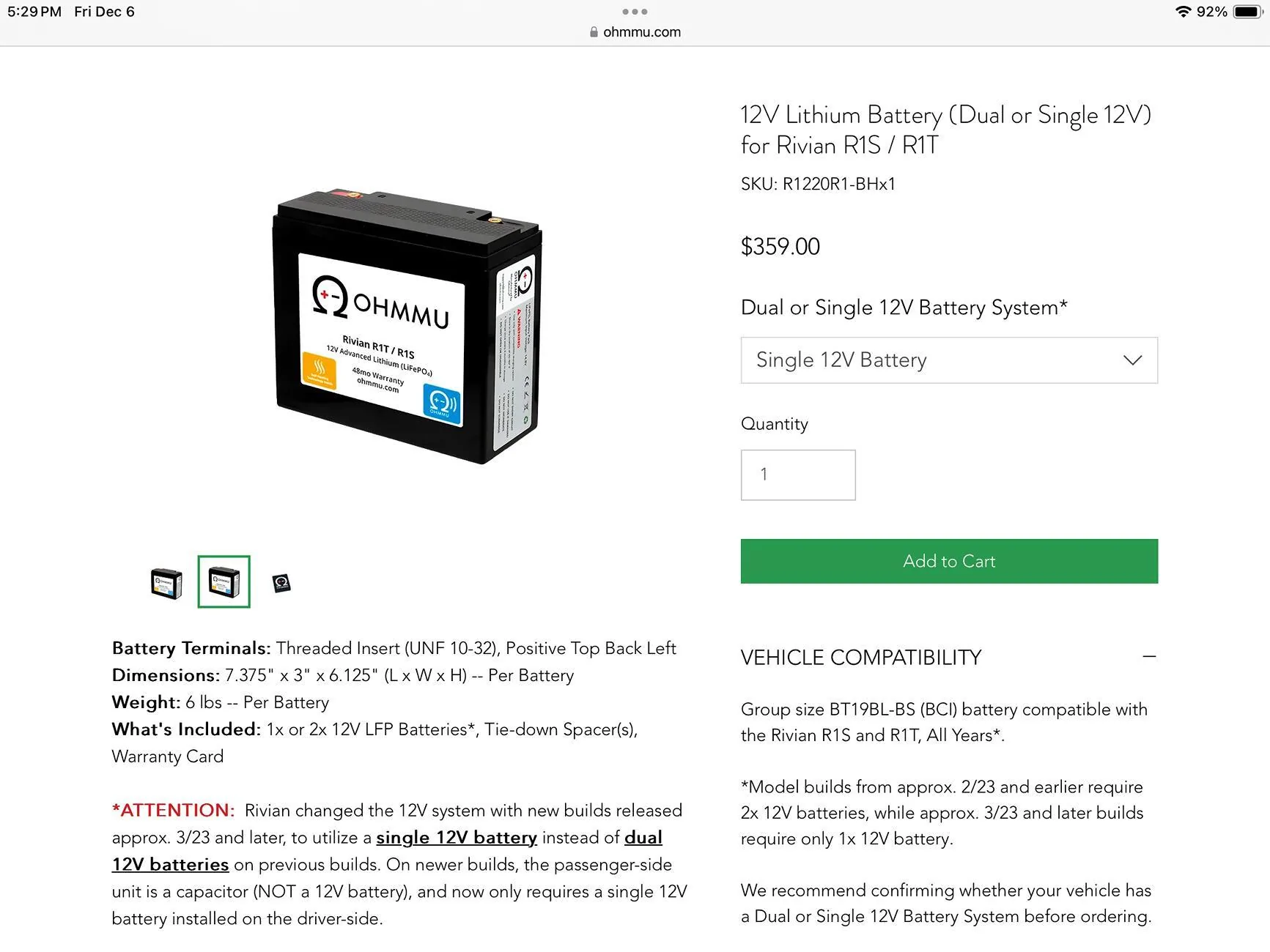

I would definitely replace the original 12v battery with the light-weight one from Ohmmu.
“Upgrade your Rivian R1S or R1T 12V battery or batteries with our Lithium Iron Phosphate (LiFePO4) batteries from Ohmmu!”
Ohmmu 12V LiFePO4 batteries are lighter, more efficient, eco-friendly, have a higher usable capacity, and last 4x longer than traditional sealed lead acid (SLA) batteries.
• 4 Years Full-Replacement Limited Warranty
• Replacement to OEM Battery
• Lithium Iron Phosphate Battery Chemistry (aka LiFePO4 or LFP)
Self-heating technology inside warms battery during charging in extreme cold conditions as an extra layer of protection.
• Proprietary 12V Lithium cell and BMS technology that is a drop-in replacement to your existing battery (no firmware changes needed)
Compatible with the Ohmmu App, a monitoring and diagnostic tool
Battery Management System (BMS), Bluetooth-enabled - manages cell balancing for a long service life and protects your battery from high/low voltage, overcharge, high/low temperatures, and short circuits.
https://www.ohmmu.com/product-page/12v-lithium-battery-for-r1t-r1s
Why are you recommending this? Did you do the replacement, and can you confirm it works well over multiple seasons? If you have, please share that information.
If you just have Ohmmu marketing material, it is not convincing to me. I would stick with a factory compatible AGM battery. A 12V failure is not a pleasant experience, and most people don't want to risk that happening.
