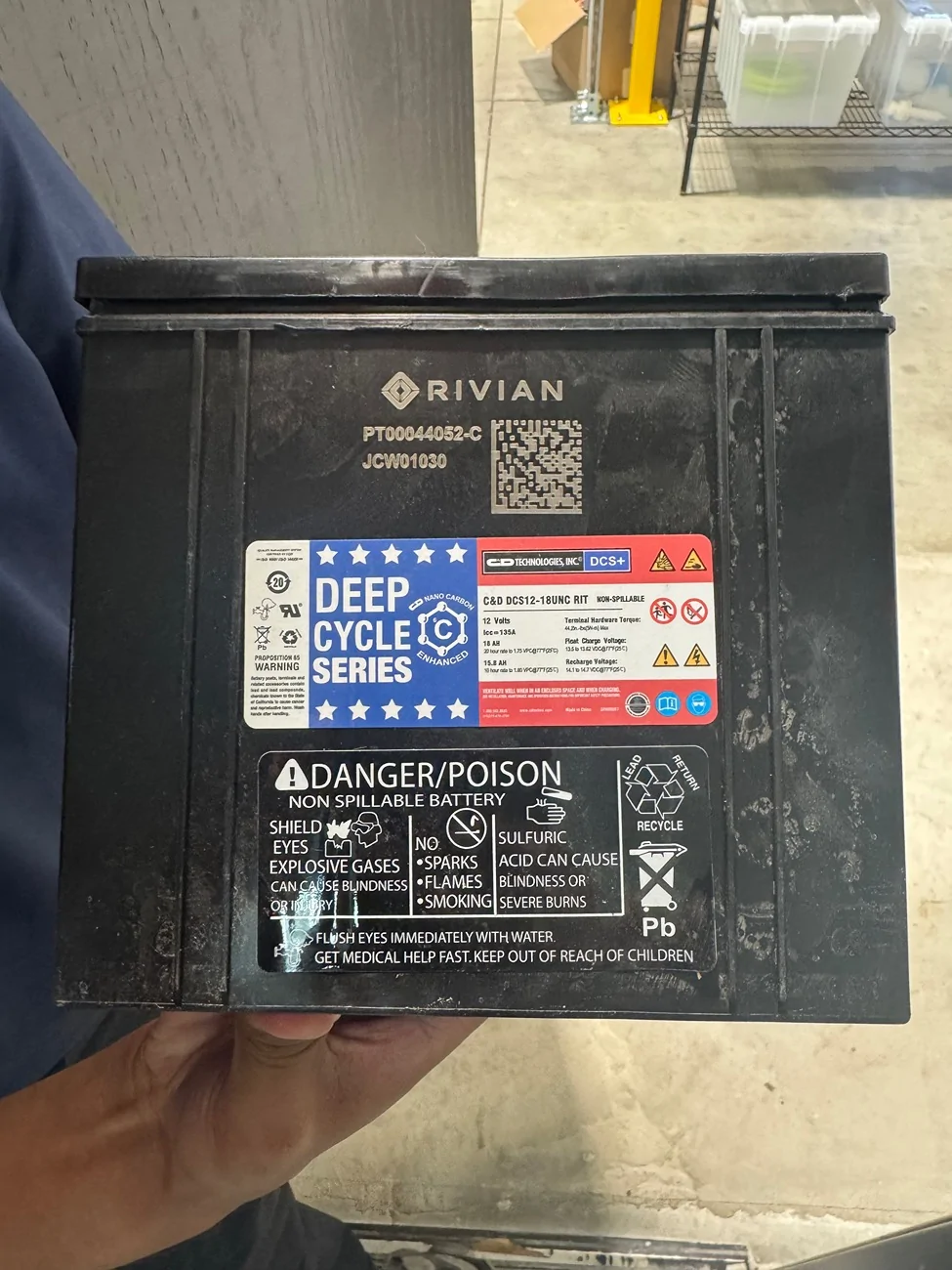

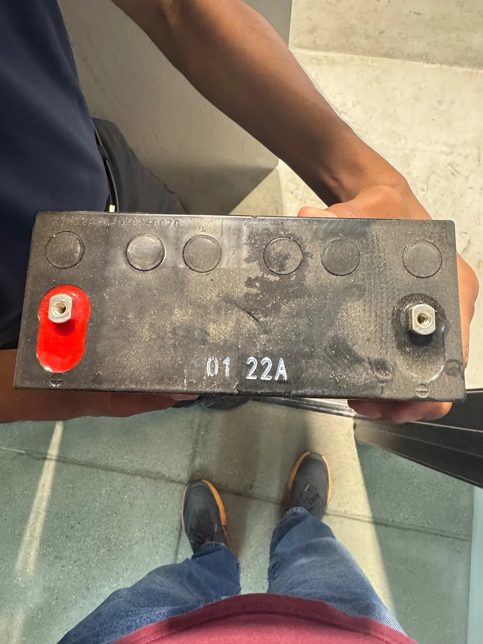

2 new 12 volt batteries installed @ Fresno Rivian Service Center this morning. Here's what the old ones looked like.
This service location is only 2 months old and very nice. They could have sent a mobile to my house (2 1/2 hours each way) but I would have had to wait until after my trip next week. **** I didn't want to take a chance driving with the battery warning light for 3 weeks total.****
Icing on the cake was free level 3 charging @ CalTran corporate maintenance yard.
