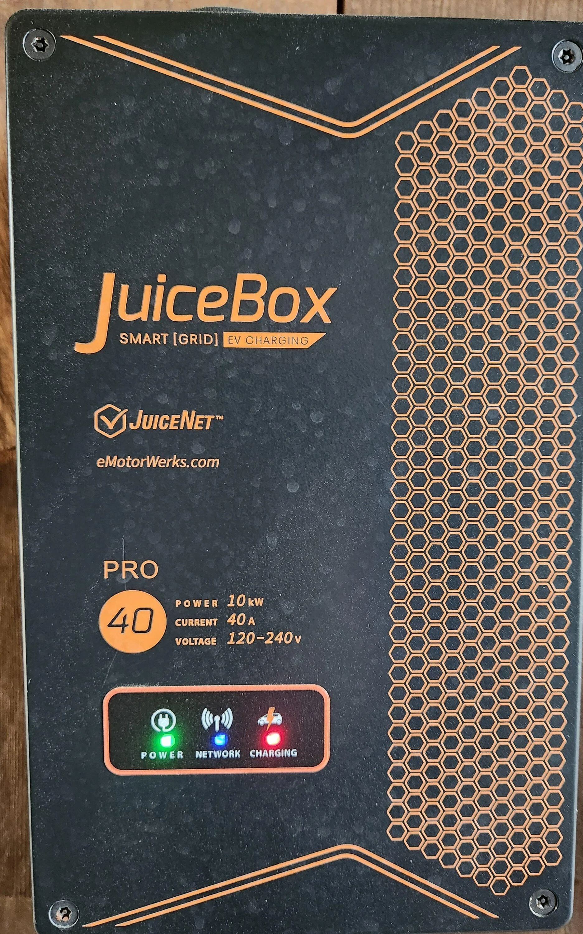

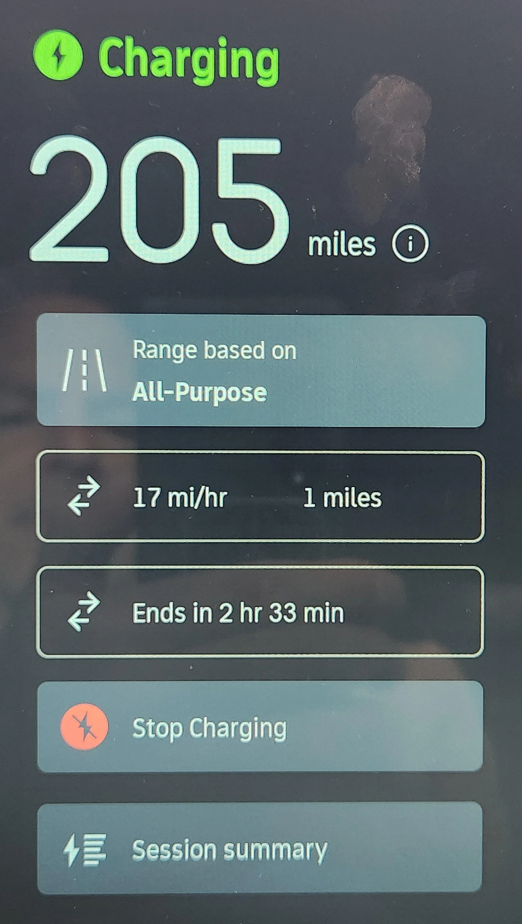

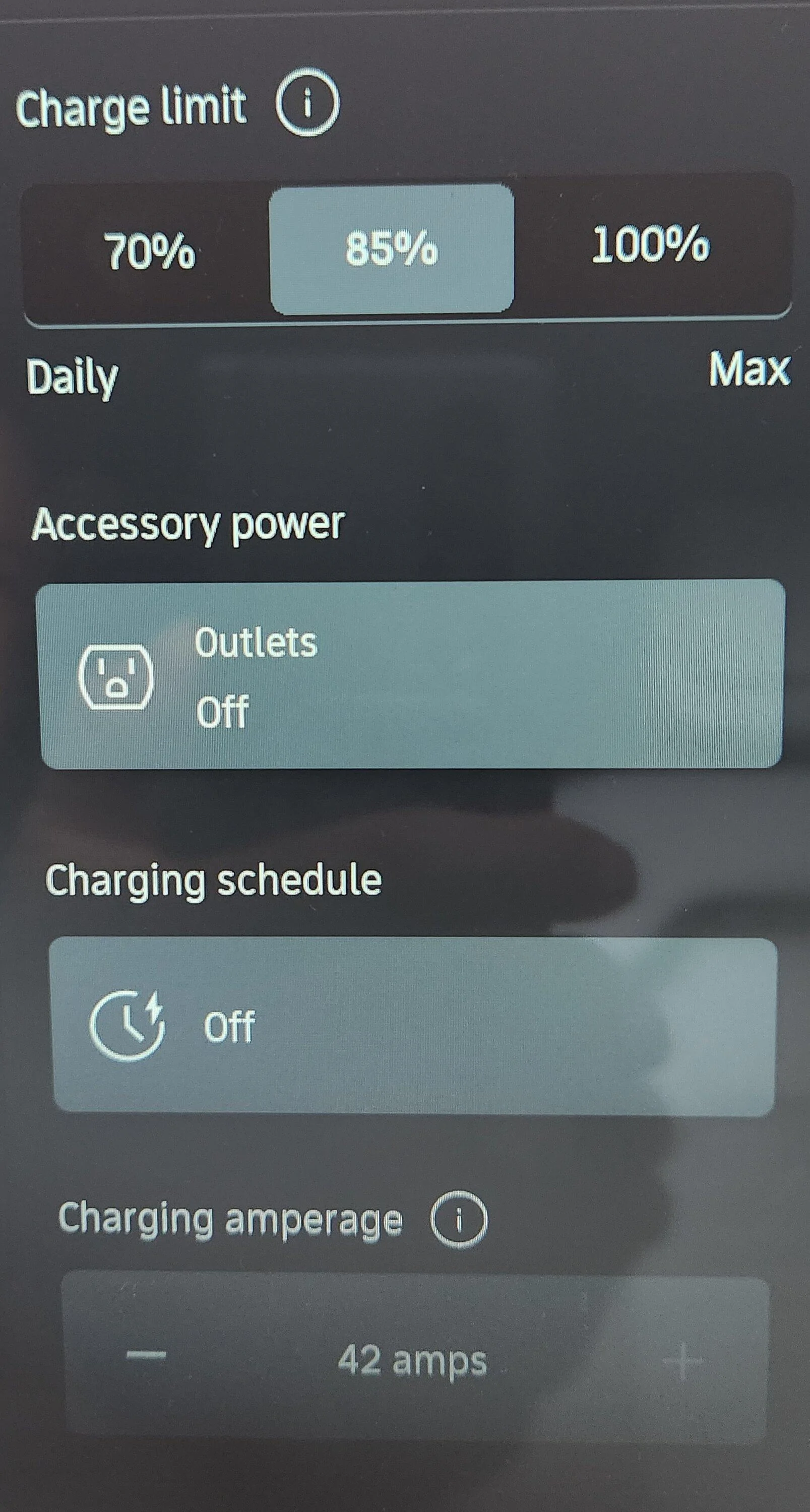

Disappointingly S L O W Charging Speed on My Juicebox 40
17 MPH
My Taycan and Model Y Charge at nearly DOUBLE that speed
Am I missing a setting to allow faster at Home charging?

That’s about right for the power you’re putting into the truck. It’s less efficient than your other cars so it’s going to add less miles per kWh.
That’s why the Rivian charger is 48a

Yep - Rivian's battery is way bigger, so it's going to take longer to fill up. Just like a truck with a 30 gallon gas tank takes twice as long to fill up as the car with a 15 gallon gas tank when using the same gas pump.

It's only 40 amps, so the rate of charge you're getting is correct. Your Taycan wasn't charging at "34 MPH"; it has a smaller battery, 80 kWh?, so obv the 135 kWh will take longer to charge.

As others have mentioned, for the amps available, that is the correct number of miles. With our Rivian charger at 48 Amps we get 21 mi per hour.
