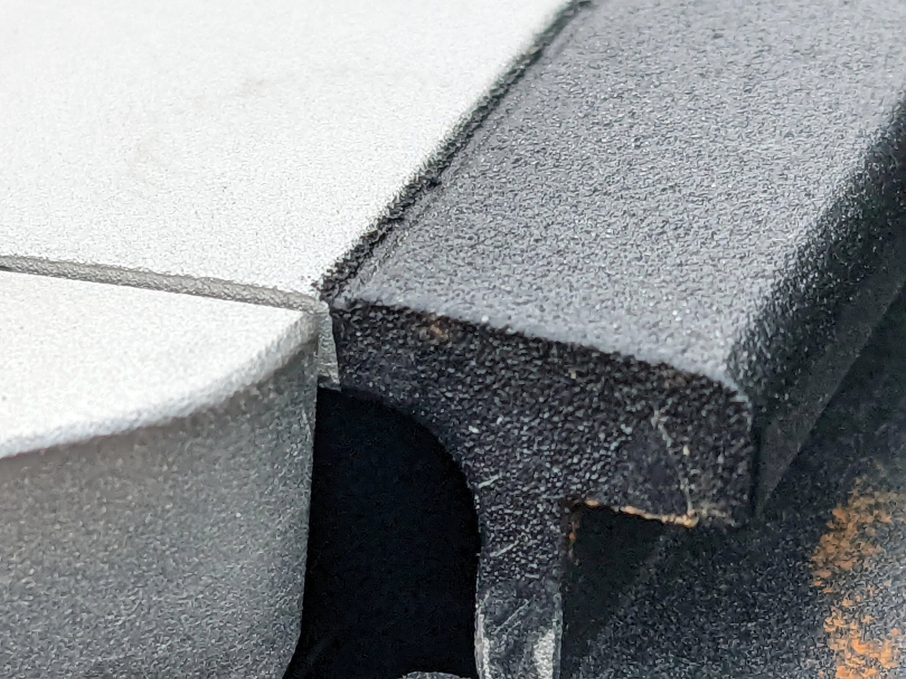

I it's actually coated aluminum, continuous with the rest of the bar.
Wow! I actually didn't expect that it would be one piece and painted.
It looks like it was engineered specifically for T-slot mounts. I wonder why Rivian even went with the Yakima HighRoads with the strap mounts as standard instead of selling the HighRoads with the T-slot. The T-slots make it a much cleaner looking install.

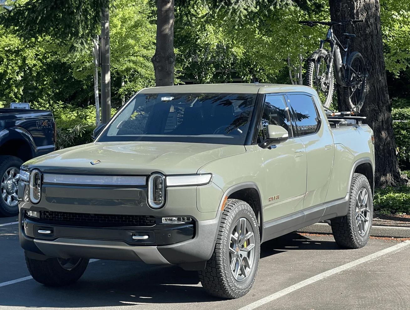

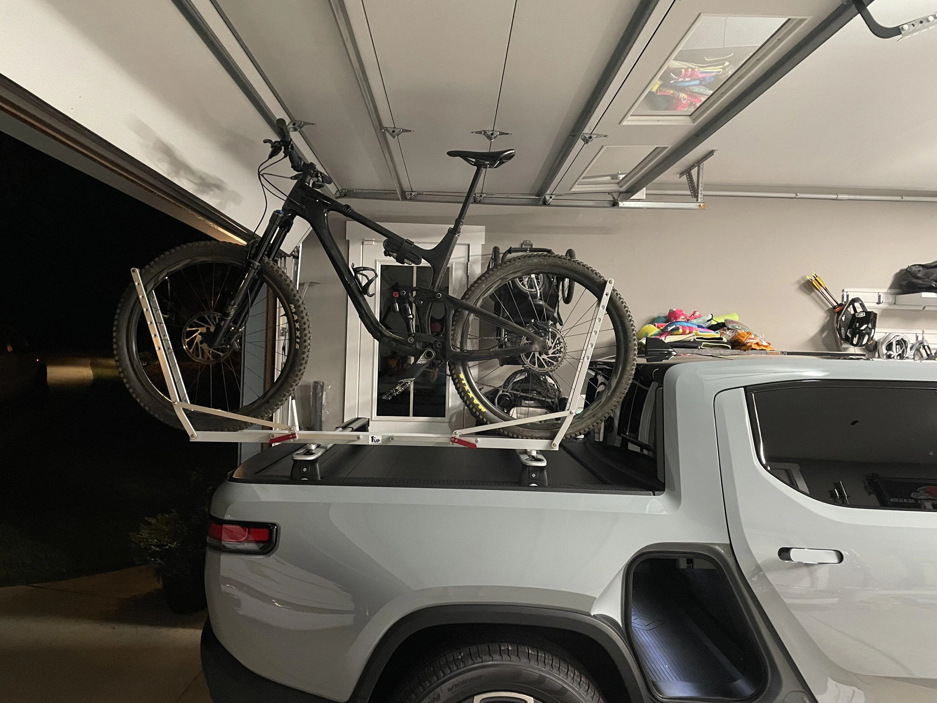

Finally got my 1up crossbar mount installed and I’m really thrilled with it as it’s pretty much the only option for those with wheelbases over 48”. The beauty of the 1up is it doesn’t require you to center over the crossbars. With this you can mount the rack with rear bias to accommodate longer bikes. Wheelbase on this bike is 49.5” and I’ve got about 3” of clearance behind the aero thing above the back window and I could offset the rack even more if I decided to(currently have the end of the rack flush with the bumper as to avoid any OOOPS when lowering the garage door). I’m loading the bike by not opening the forward mount all the way but limiting it to a point that I can load from the rear and still not touch the aero thing.

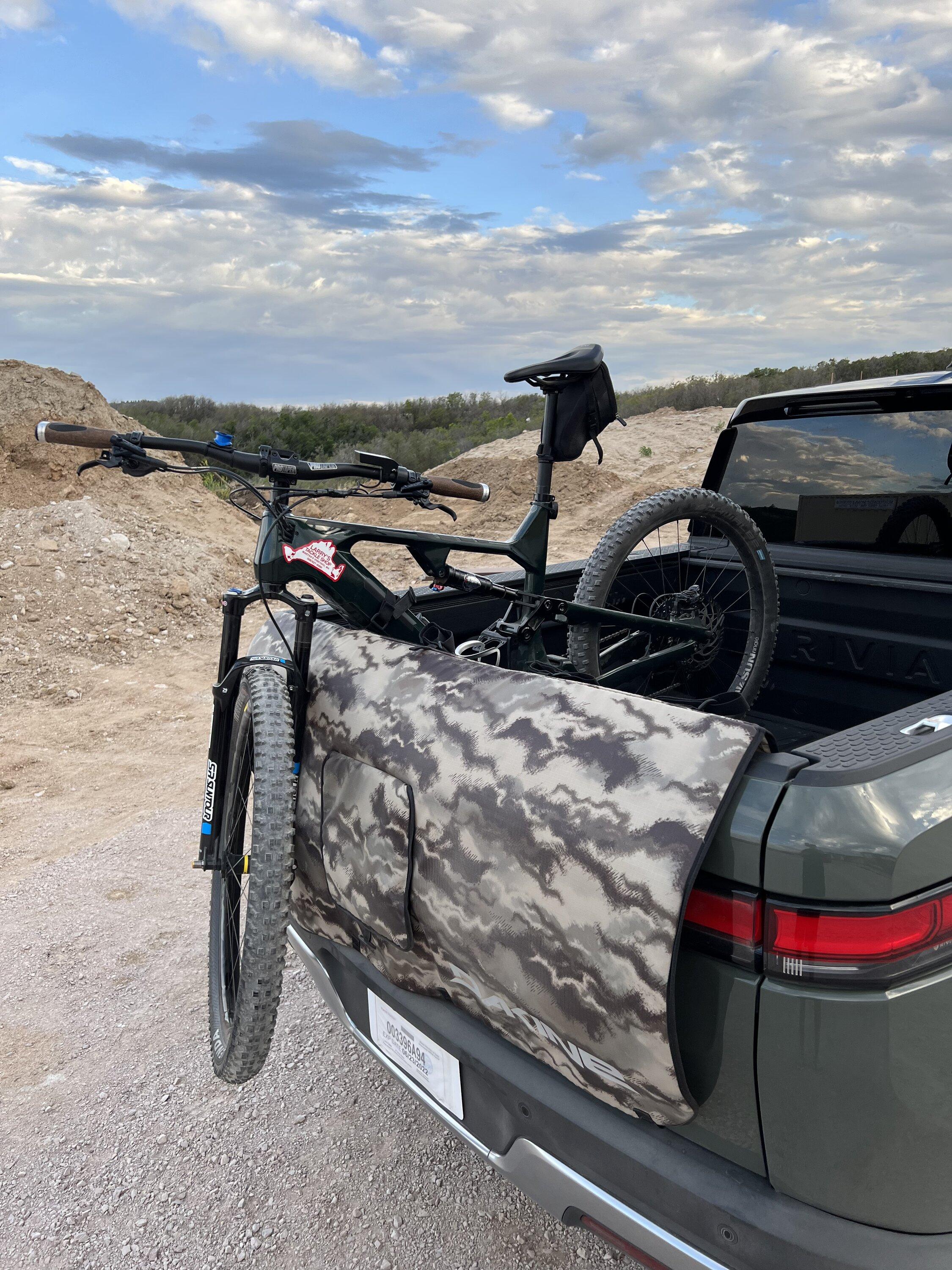

I really like the 1UP option, but have been happy in the meantime with this fix. No 4x4 rock crawling but very stable so far.
Rivian635
Feb 24, 2022
MN
BMW X5, Acura MDX Hybrid, Honda CRV
This is exactly what I am hoping to do for quick trips to the local trails... Cant tell from the pic - about how much room is there behind the bach tire of the bike and the bed wall (bheind the cab)??
How is this setup working out for you? I have an XL MTB and just unsure if it will hang too far off the back... and those are the flush mounts, correct?
Not OP but I have the same setup with two bikes (XL 29ers) and it's working great. The bikes do hang out over the back a little bit but it's not an issue.
Only one pictured here but it's a great way to carry bikes without stretching the footprint of the truck:
very cool. Thanks! I do have the 1UP hitch racks, but the hitch extender I had to get makes it more wobbly, and backup cameras/sensors go nuts, so I wanted to try the bed rack option. I would guess the hitch rack is better for range, but not positive about that.
