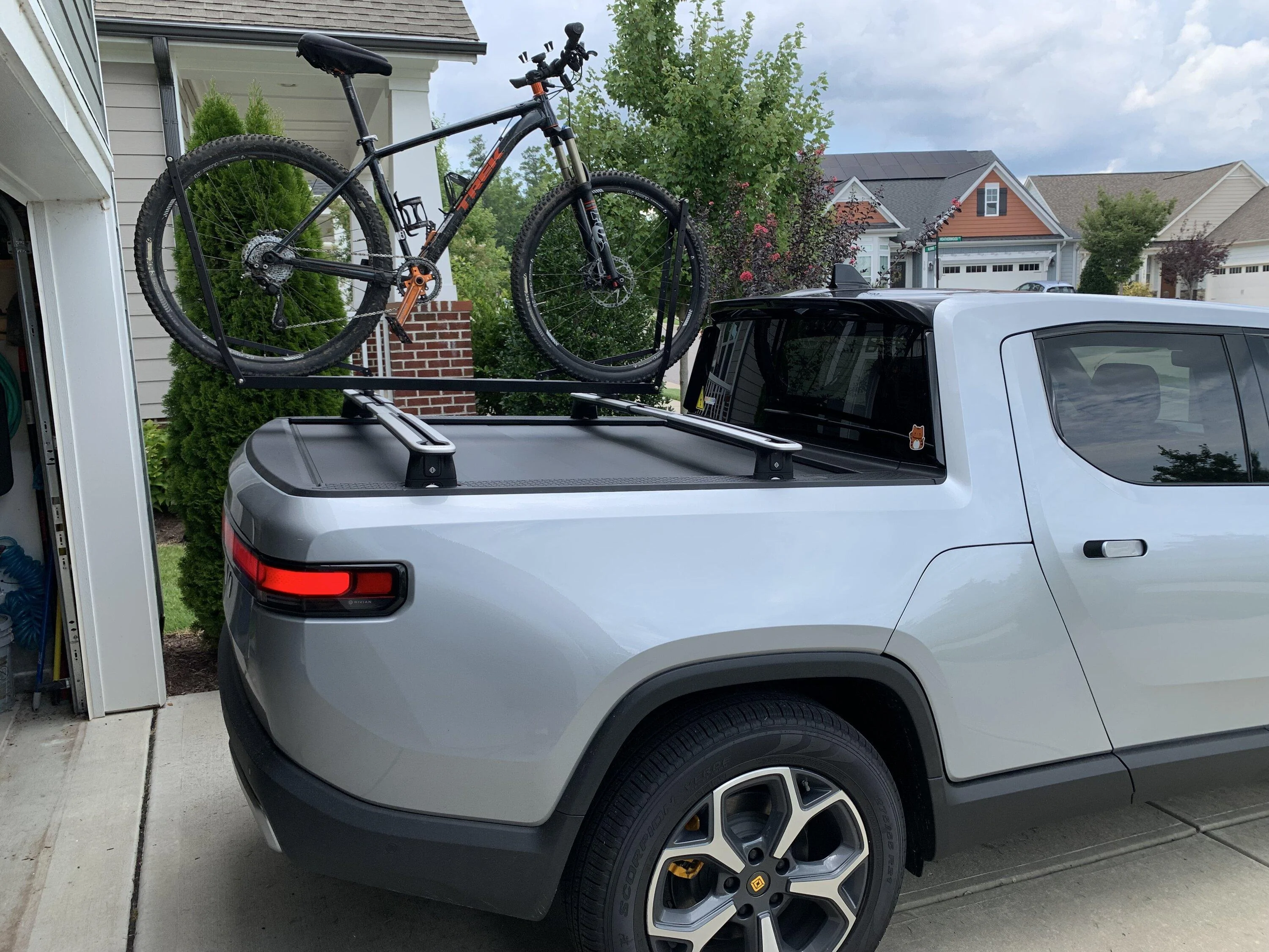

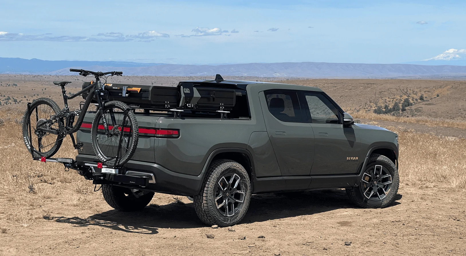

we ended up with these too after our Thule racks were not working for carrying above the bed. Large and medium 29ers fit, definitely have the racks biased towards the rear but they do not stick out further than the rear-most point of the truck.

Nice! Looks good! Those are the flush mounts right?

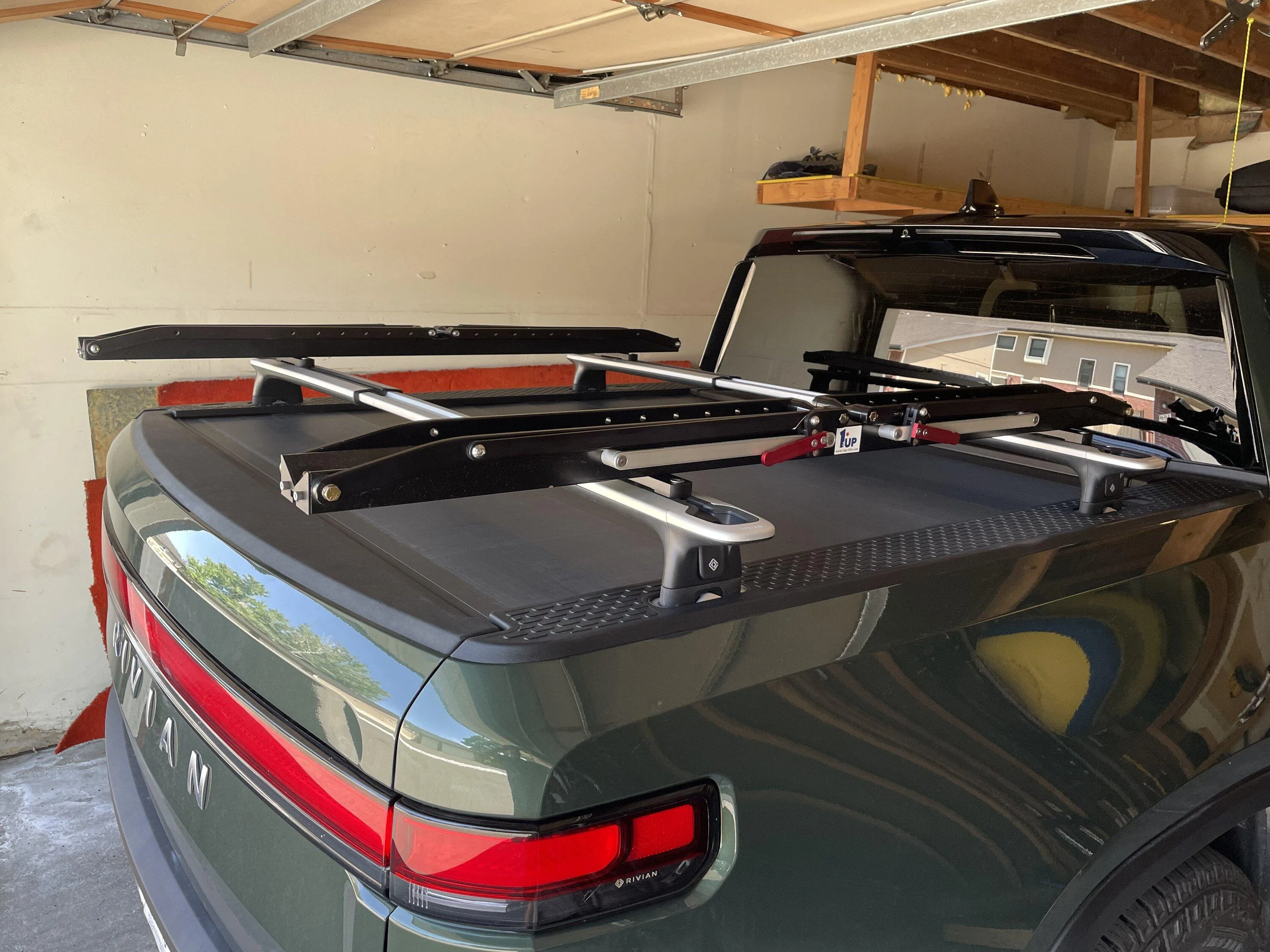

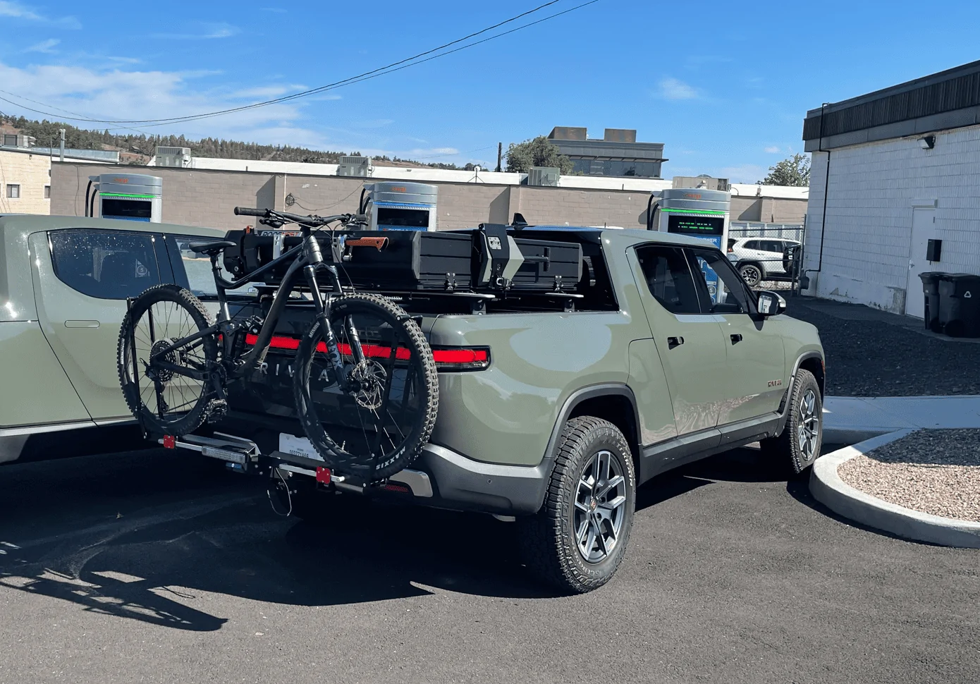

Add me in the 1Up roof rack camp. I'm completely satisfied. Quality product and a reasonable price. The only downside is the bike is pretty high and I can't pull into my garage with it on the truck... But all things considered, this is the best way to carry bikes with a R1T, imo.
They are. They fit nicely. I don’t know about the other attachment method (and their site warns you about this in advance) but it is only attached with some Allen bolts, so easy to remove, especially since you can slide in and out of the Rivian crossbars without fully unscrewing the bolts. Nice for quick removal but not too secure.
These were also their bargain garage models, I’d rate one a 9/10 and the other a 7/10, looks like a year of two or use as a demo model. Worth it to me to save some cash.

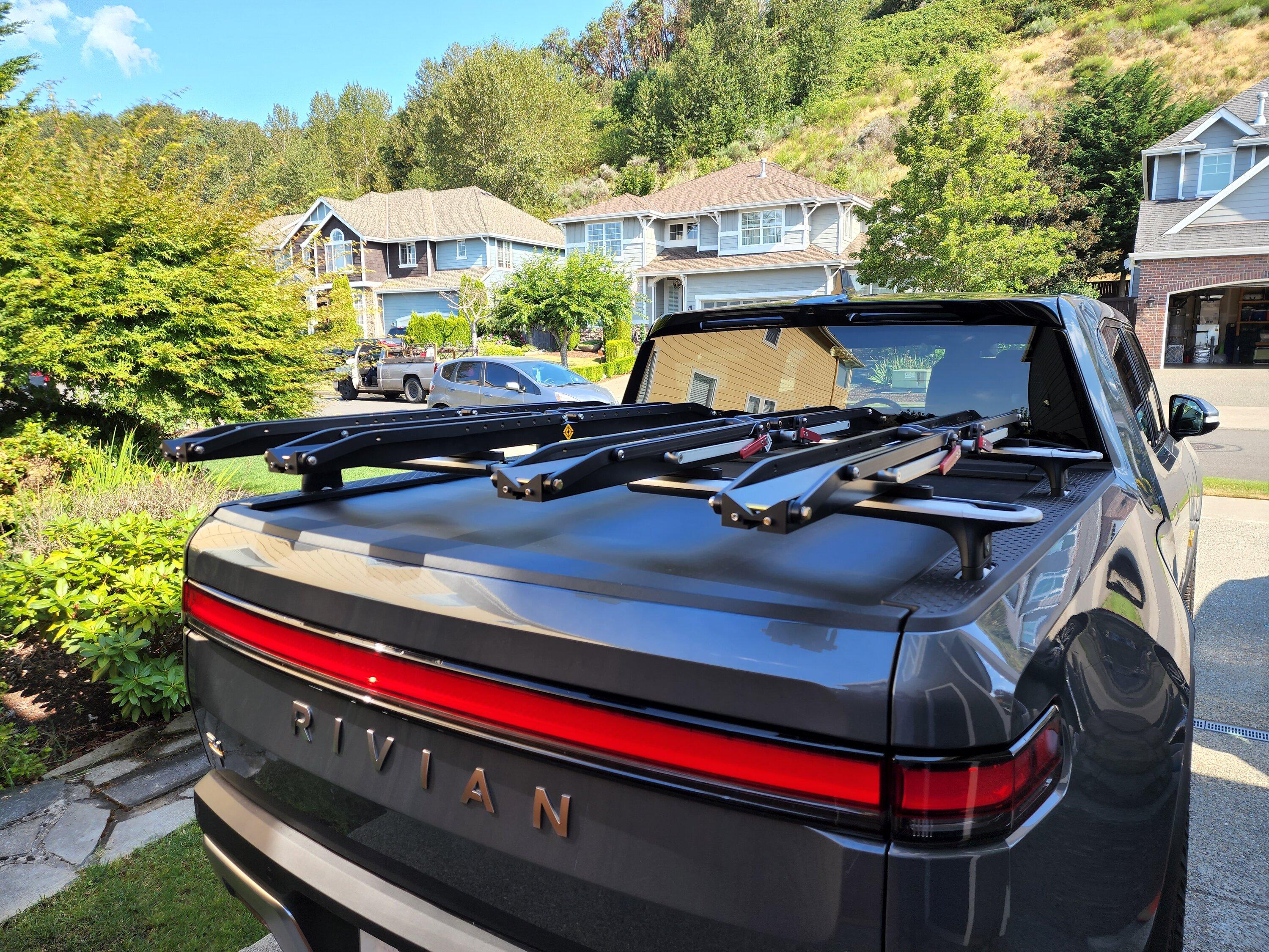

Before swingout:
Rivian R1T R1S 1up rack fitment on bed crossbars 1660165284753
After swingout:
Rivian R1T R1S 1up rack fitment on bed crossbars 1660165315981

Before swingout:
After swingout:
Oh, I see. I have the Heavy Duty Double so perhaps the hitch is longer on Equip-D?

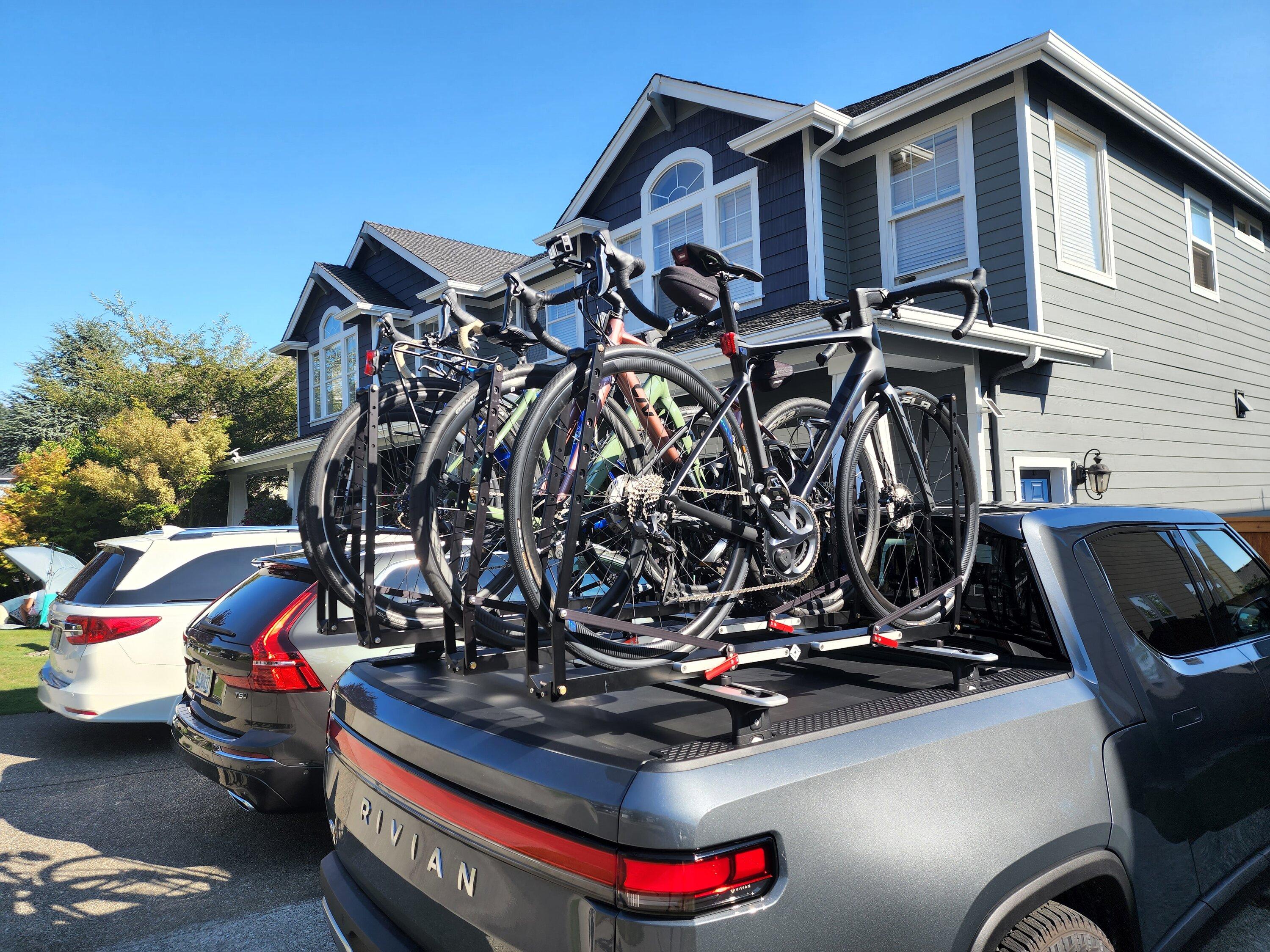

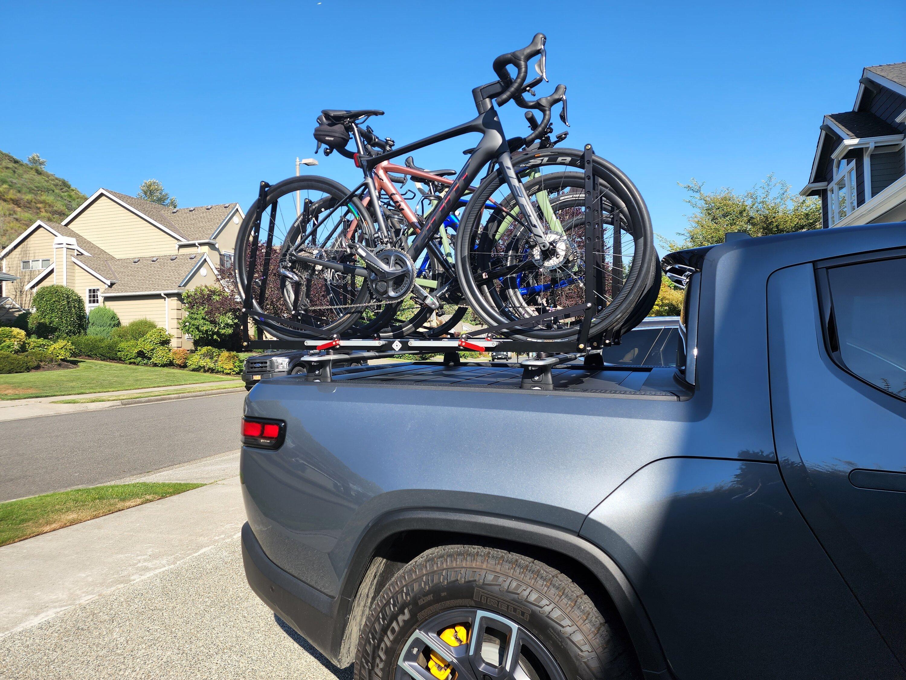

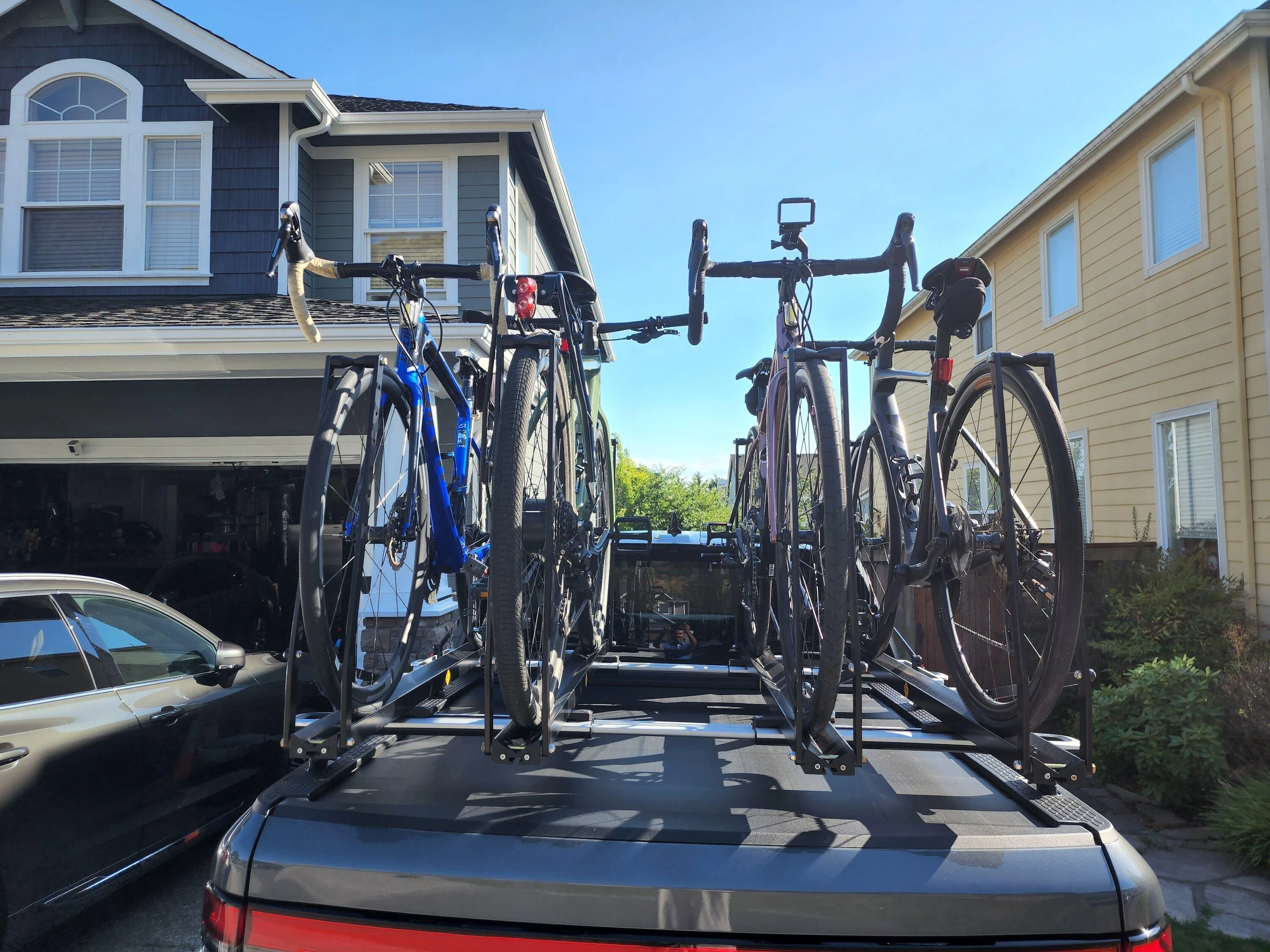

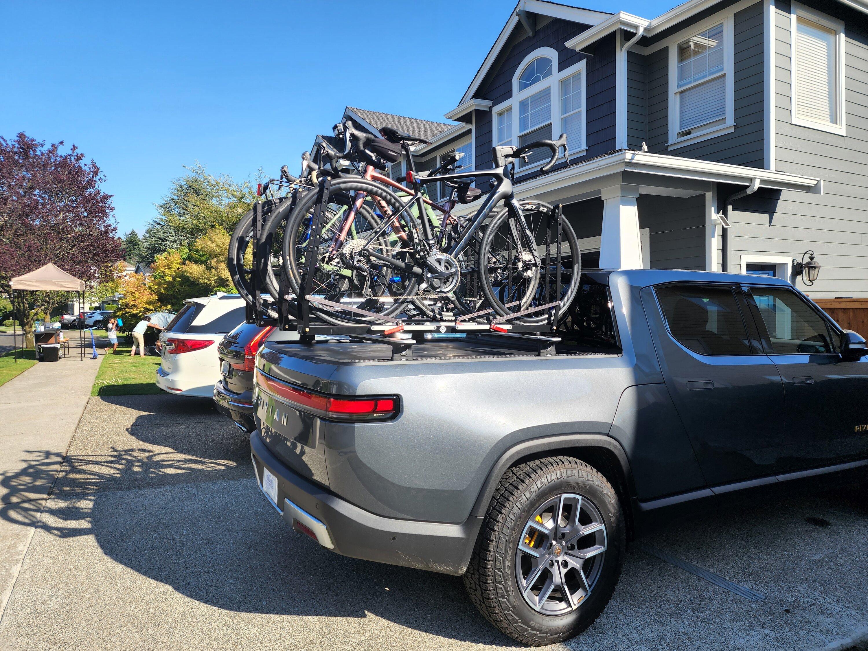

This is my setup for 5 bikes, 4 on cross bars and 1 (my 8 year olds bike) inside bed.
Can you fit size L 29er bikes on there? Our bikes are about 75 inches tip to tip. Nice color on your truck I have the same. Those 1up racks are amazing.
I have carried two XL 29ers on mine no problem. You can move the 1up rack back and forth on the crossbars to make sure you have clearance at the cab.

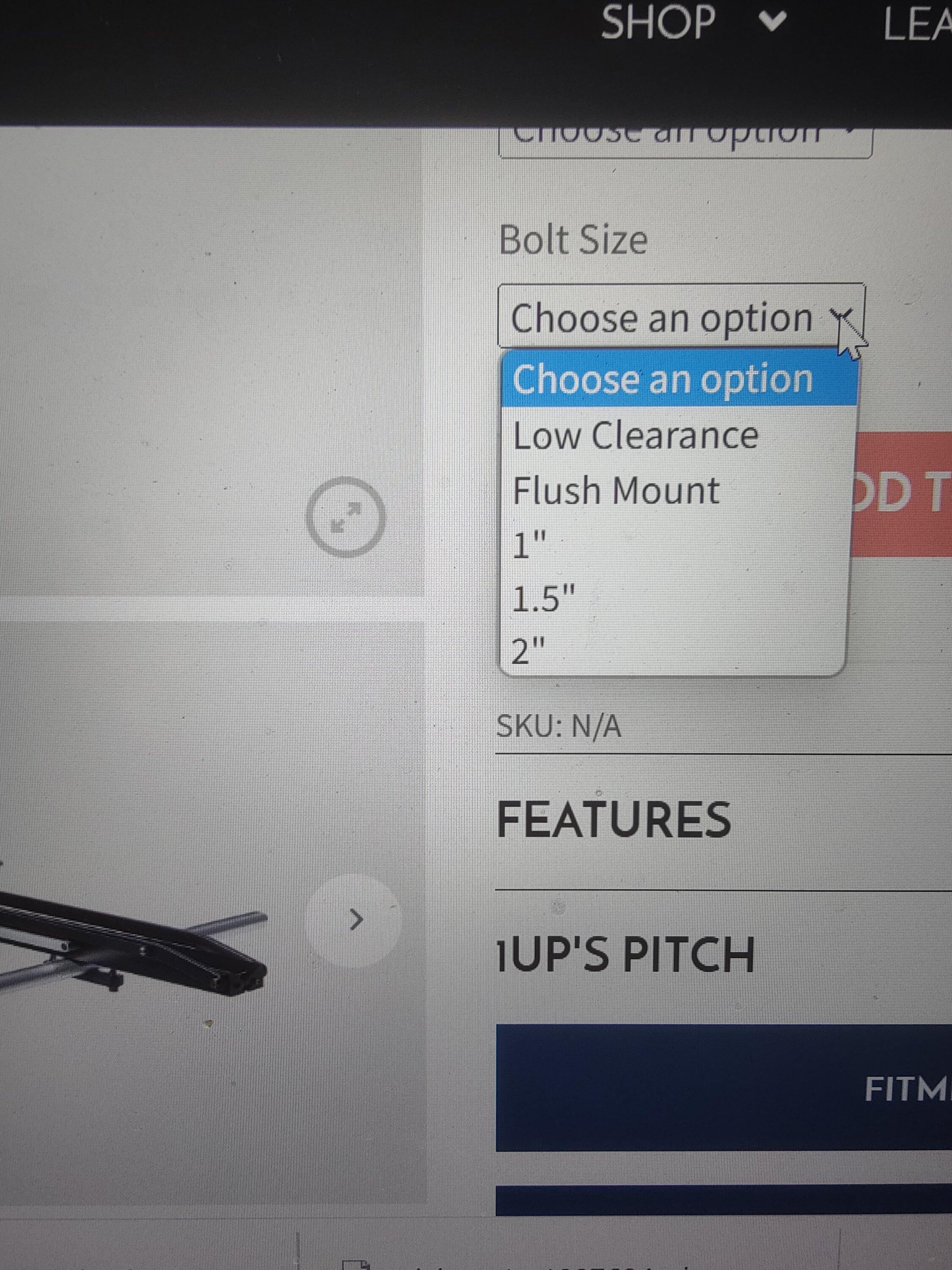

Which bolt size option on the 1Up cross bar mount do we order? (lazy I know)
Rivian R1T R1S 1up rack fitment on bed crossbars IMG20220817165757
