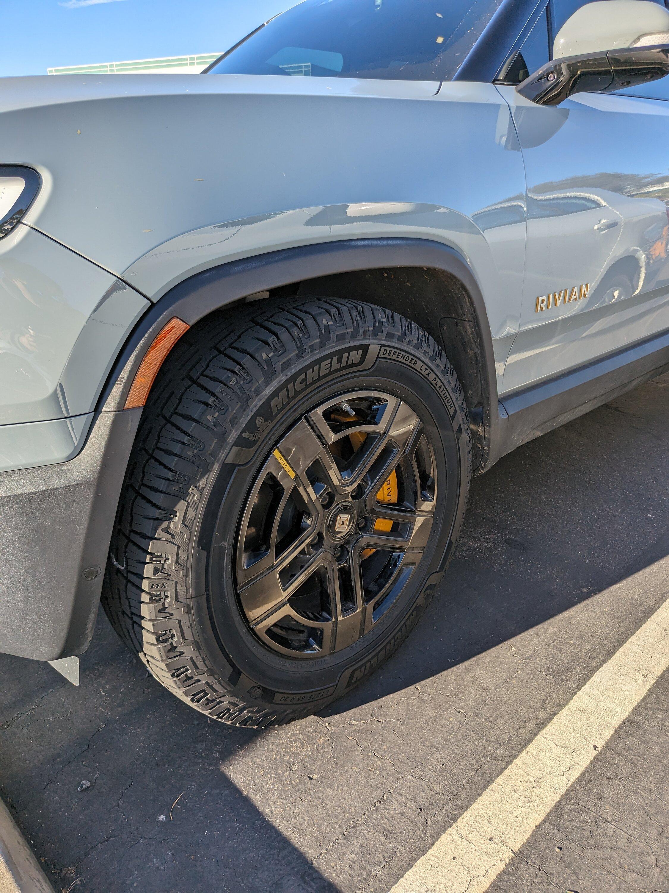

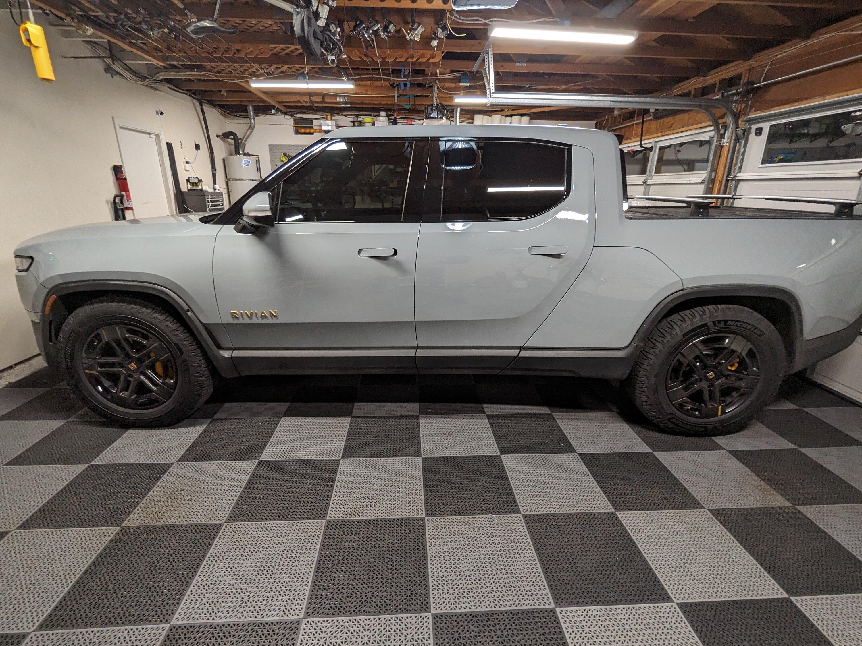

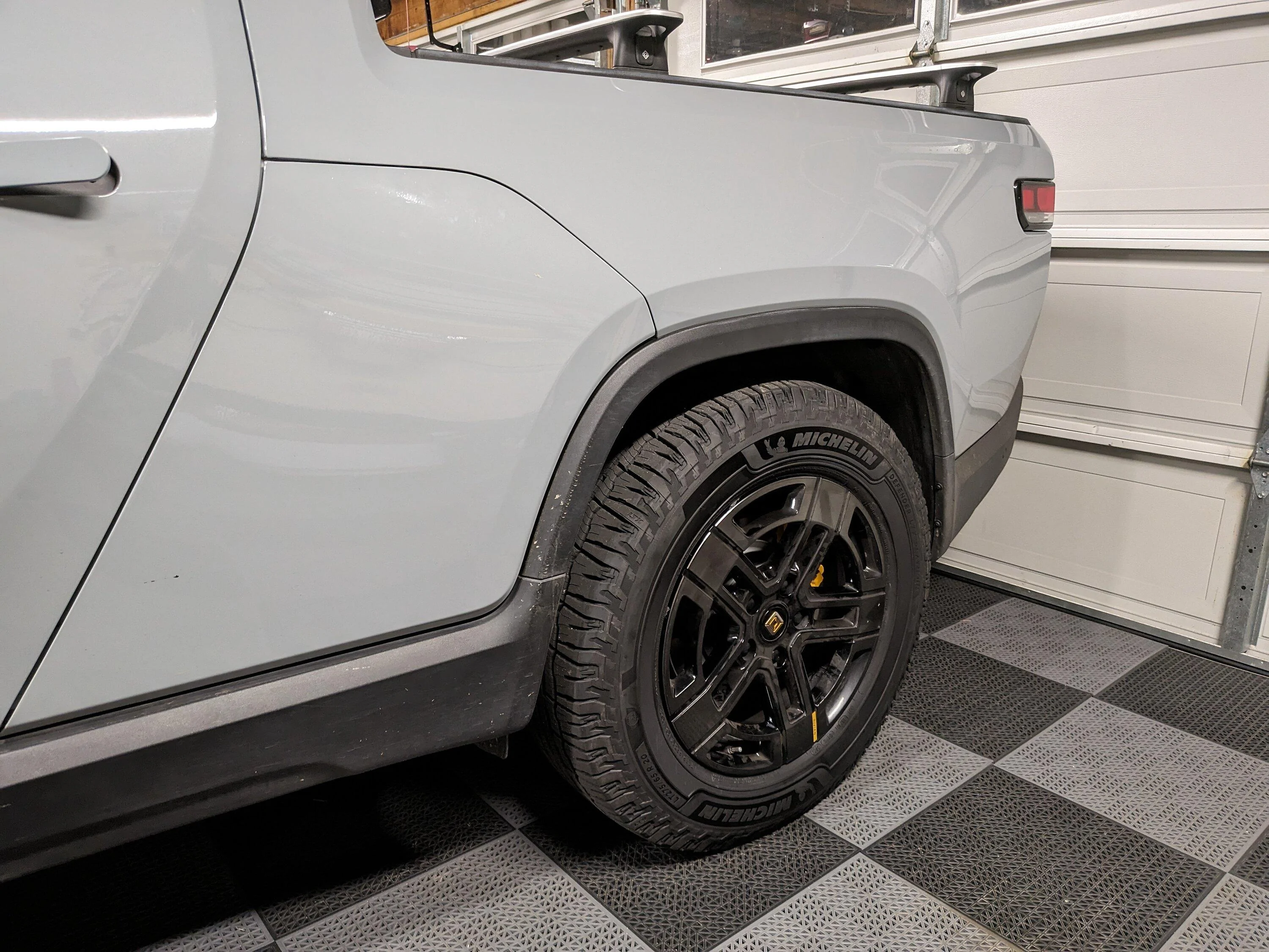

I just changed out the Pirelli to the Michelin Defender Platinum (275/65/R20) LTX based on recommendation from this thread. Had Discount Tires price matched what Costco had (basically installation fee waived). DT set the tire pressure at 48psi, I'm pretty sure I should increase the tire pressure but not sure what to set it at yet... the Pirellis lasted only 23k miles for me. with these ones rated for 70k, i'm hoping i get half my money back as credit when i'm ready to get new ones again :)
This is the first picture I've seen where it shows the stock tire size and black 20s fully. It looks great! I think you may have sold me on my next tire. Please report back on efficiency!

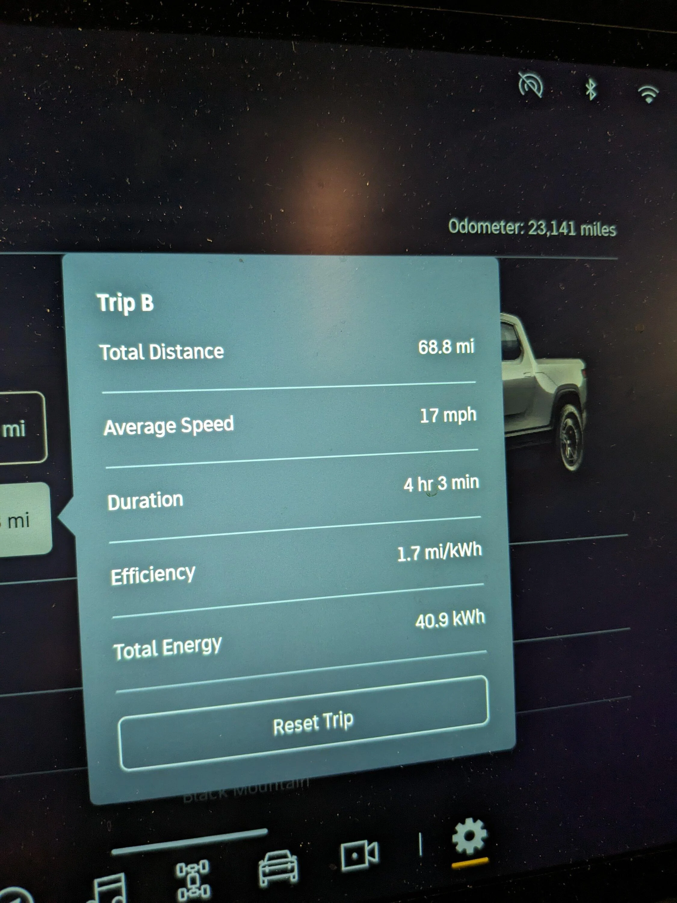

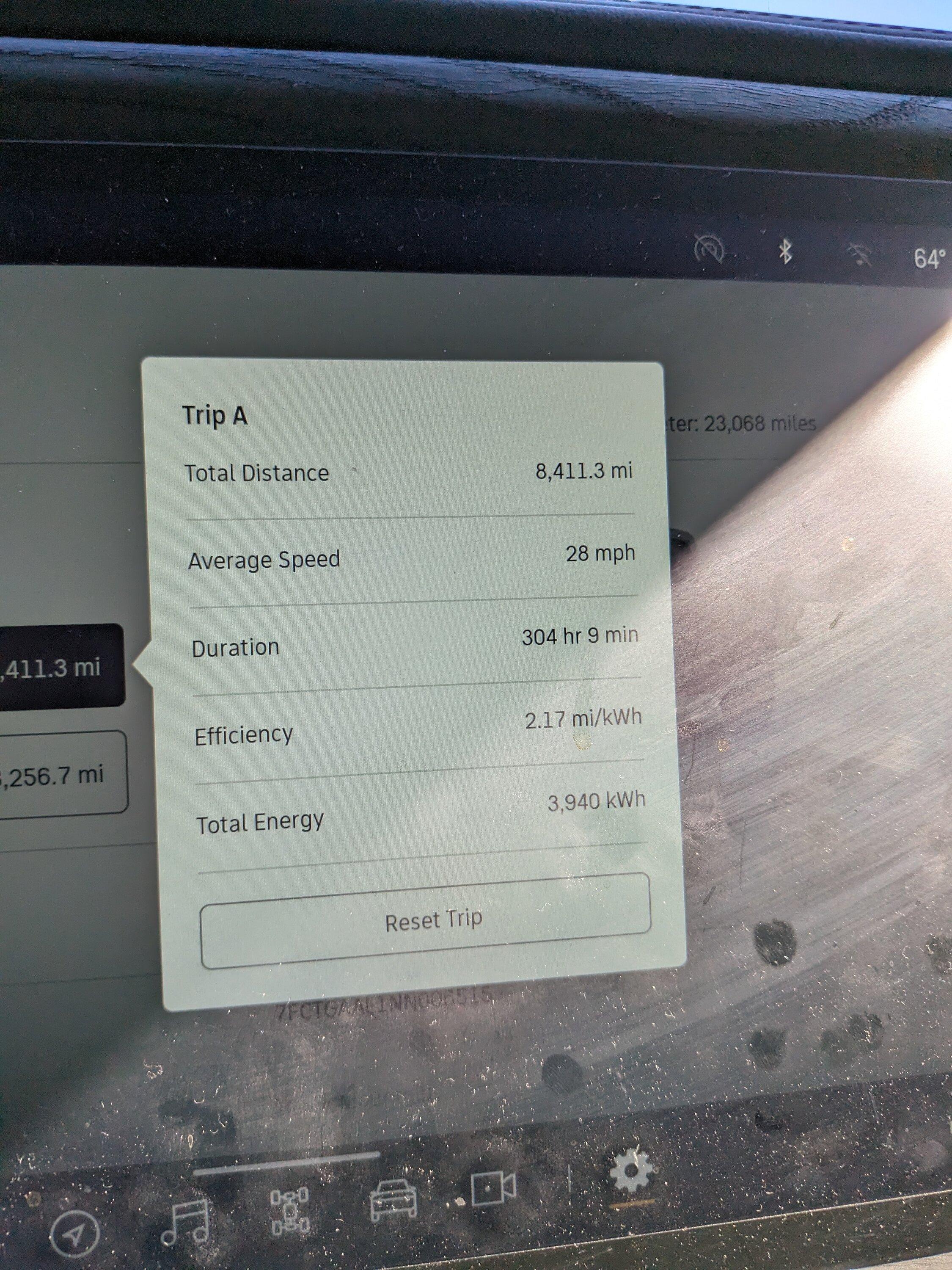

Efficiency will need a little more data but I think it's not as good. I've only driven for commuting in local roads with the new tires (3 days old), I'm getting 1.7 mi/kWh (w/ Pirelli I was at 2.17 mi/kWh), let me report back in a couple of days after some weekend driving on freeways. See pics Trip A is with Pirelli. The new Michelin tires is Trip B. Keep in mind I'm still using 48psi. Have not attempted higher psi's yet.

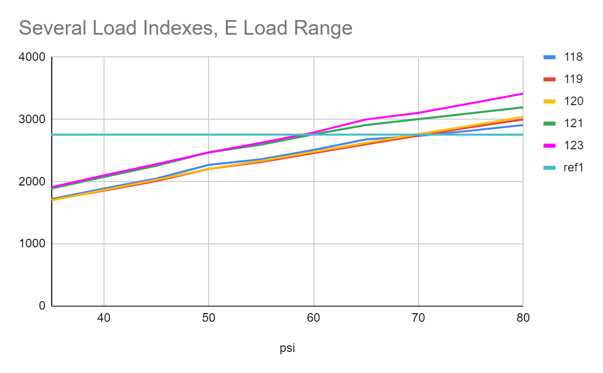

I think so, it's all based on load rating, load range and psi. I found this other dataset (Discount Tire Load Inflation Tables), slide 3 has E load Range (Presume that is same as "E1", which the Michelins are ), it does not have all the details for 126 index, but when i plotted the load index by psi for all the other load indexes and put a reference line at 2756 load index (i.e. the Pirelli load index), roughly around 55 psi is what Michelin should be inflated to. (the reference line intercepts at around 58 psi for load indexes 121 and 123, so ~ 55psi if it was load index 126).
