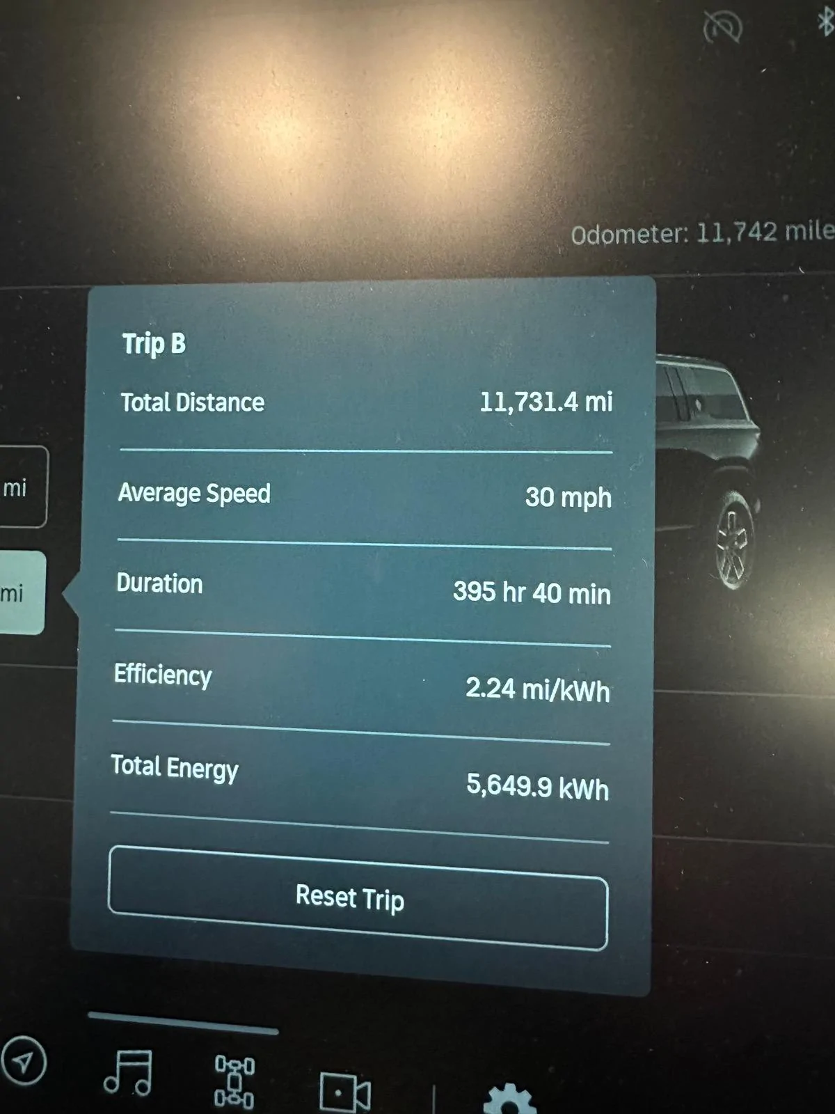

Iā€™m at 2.24 for 12,000 miles 100% AP mode. I live in NH and have had the vehicle 1 year (so majority cold driving). Mostly short distance drives but I floor it all the time and do 75-80 on the highway.
OEM AT 20s. The noise is now unbearable so I need to switch tires.
These seem promising. That is a wild gain in efficiency claim. But iā€™d be happy with equal efficiency as OEM so I might try them out.
