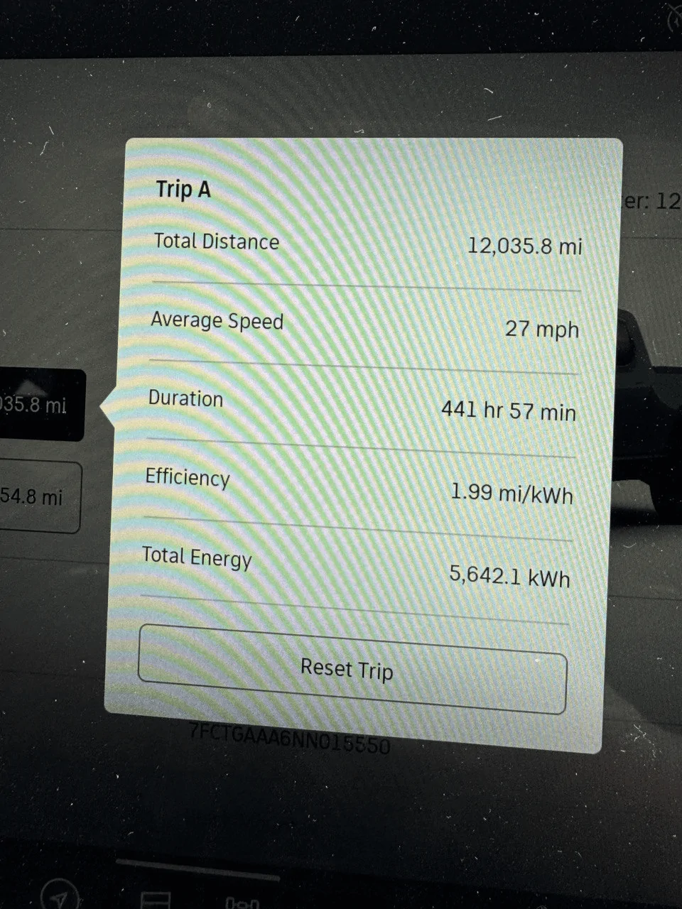

My lifetime average on OEM 20s is 1.8. I mostly drive in AP like a grandpa; 60 percent city driving versus highway. I can't imagine how people are getting 2.0 and over on OEM 20s.
Agree. I thought anything over 2.0 was deserved for Mrs. daisy

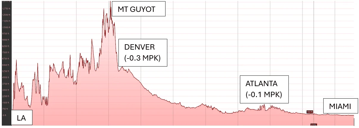

Your benefits from high elevation almost cancel out the lower temps, try a 15-minute test at 65 mph on flattish ground on 70F day, should be very high MPK….my average at sea level in SoCal:
Rivian R1T R1S 20" Nitto Recon Grappler AT tires 25% more efficient than Pirelli OEM AT! The holy grail! 1711467045598-35

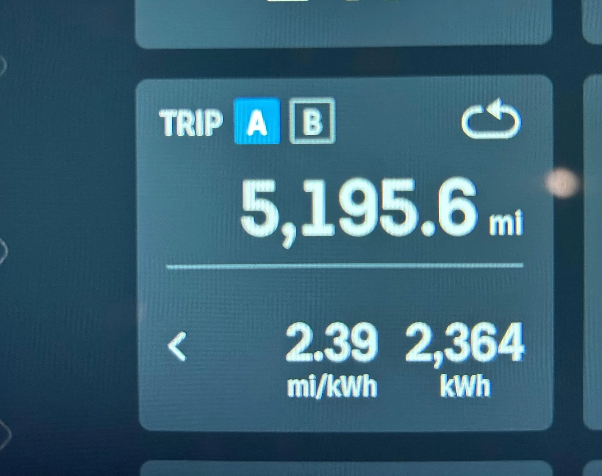

Another R1T DM here. 8900 miles on 20 AT and my average is 2.3 and I don’t drive slow.
What’s your elevation? Want to see if everyone with higher than 2.0 are still j high elevations….
