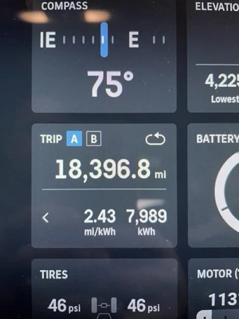

I’ve been noticing this for a while and just haven’t gotten around to posting, but our Rivian’s seem to be terrible at math. According to my calculator 18,396.8 miles divided by 7,989 kWh = 2.3028 mi/kWh. That’s a pretty big miss (more than 5%) and more than a rounding error. I guess we’re all comparing the same system but sometimes mine shows correct math and sometimes it doesn’t. Seems weird to get such a simple calculation incorrect.
I think the conclusion should be that they are calculating something different than what you assume, NOT that they can't do long division correctly.
In this case, kWh probably refers to the amount of power supplied by the chargers. Some of that goes to loss in the charging system. Some of that goes to battery warming. Some of that goes to you playing Nickleback at volume 25, or running the A/C at full blast, while sitting at a charging station. Etc. If there is 5% loss from all the sources that use some of the charger energy before it goes into the battery, that's not really surprising is it?
Yes, I understand your point. But it’s pretty silly to have a display with an obvious long division equation that doesn’t add up (pardon the pun). I would also point out that there are photos in just this thread where the display has a mistake in the other direction. Mpk is higher than display is showing. Sometimes the math is correct. Display is wrong in both directions so there's just something funny about it and we should all be careful quoting the displayed number. I’m not saying with certainty that I know what’s wrong, just pointing out the uncertainty in what it is even displaying.
Yes, looks to be all over the place, showing 1.99 but calcs to 2.12.
Mine shows 2.4 but only calcs to 2.2...
Yes, there are consistency problems all throughout the Rivian UI / Rivian App. There are places they do rounding, and places they don't. There are places they use the actual kWh delivered, and places they use kWh delivered to only the battery. Etc. I'm not defending the sloppiness of their numbers, I'm just saying to be aware that a simple division does not necessarily give you the number you expect. I expect the consistency of these numbers to (continue to) get better as time goes on. I'm just saying don't jump to conclusions because you may not be aware of exactly how these numbers are calculated and you may be assuming the wrong thing.
I do wish there was a way for me to report issues directly to the Rivian software team, as there are many inconsistencies like this which I could point out to them. I can understand exactly what they are reporting in each case, but it's clear that in each case they are reporting something different. THAT is a problem from the customer point of view, even if it is technically correct from the software developer point of view. (I am both, BTW.)

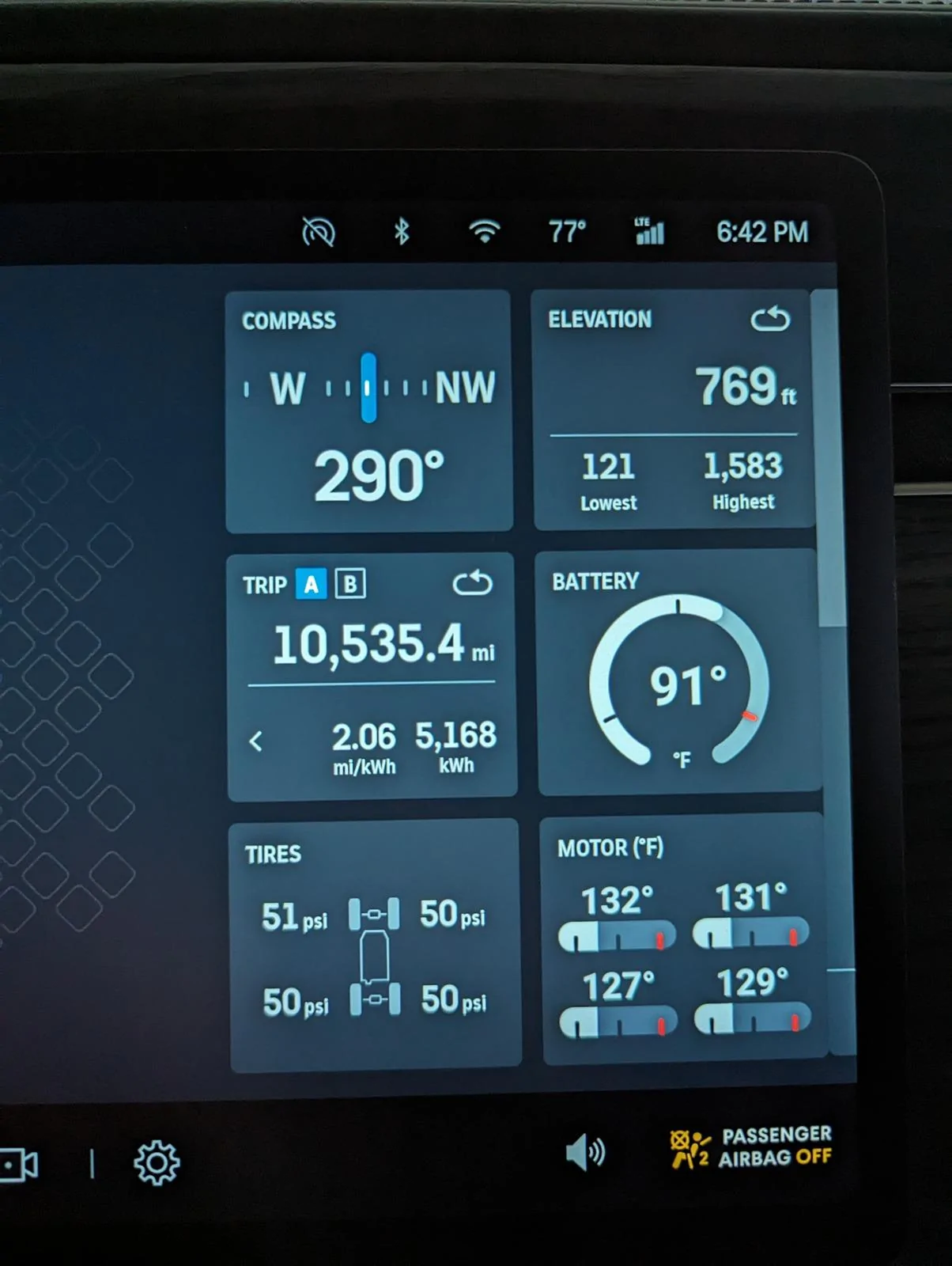

My stock Pirelli A/S stats after 10K miles, pushed hard = 2.06

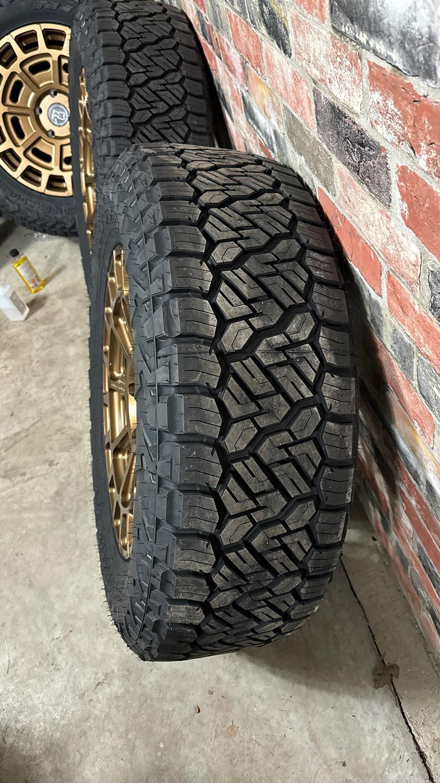

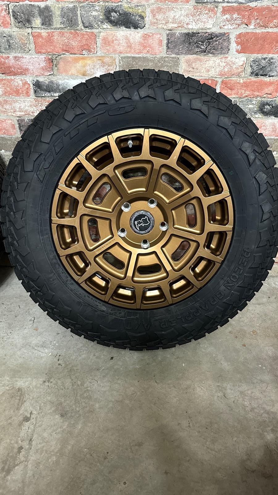

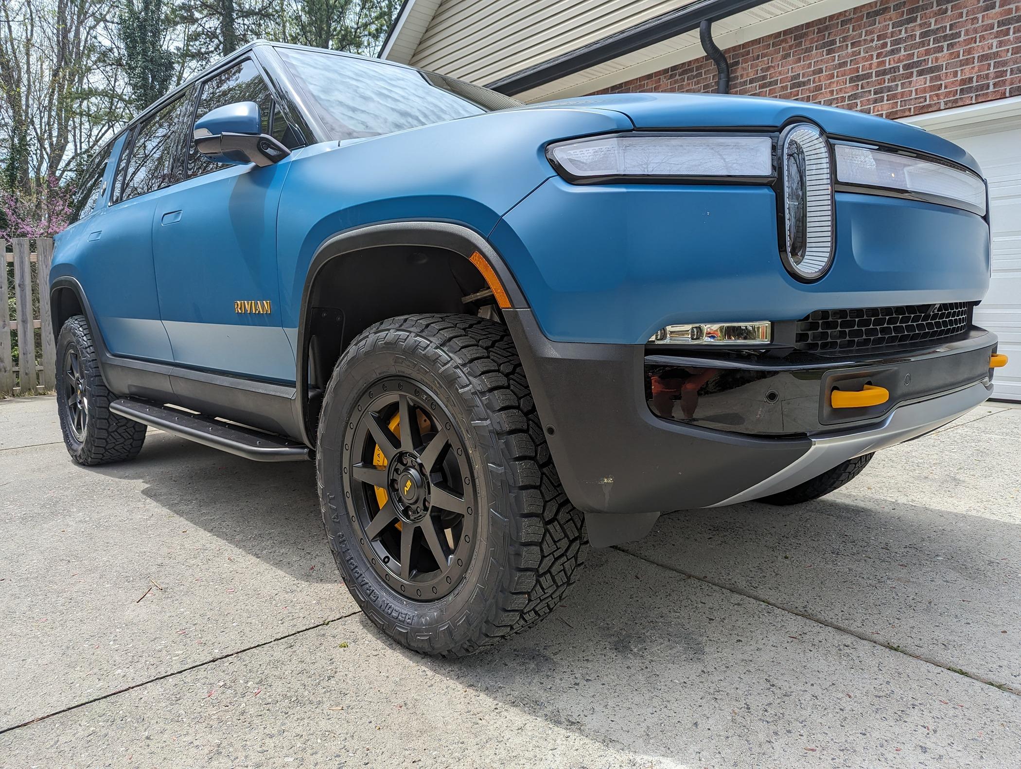

Got my voltaic ready with the recon grapplers! Just waiting to get my R1T back from service so I can mount them 😁😁😁
Looks awesome! I just ordered a set of the tires for my grey Black Rhino Voltaic wheels. I'll post them up as soon as they are installed!
Wow, I didn't know they made them in 33" Let us know how the efficiency runs on those!

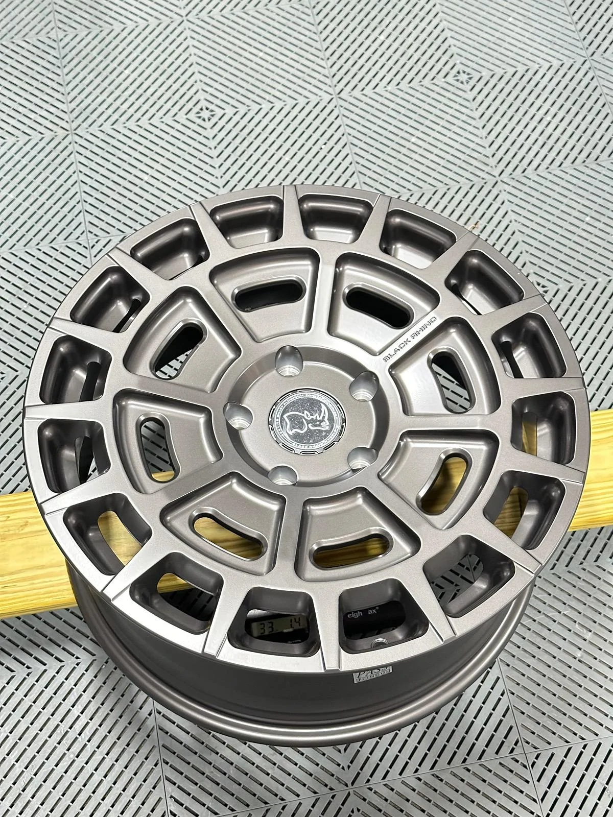

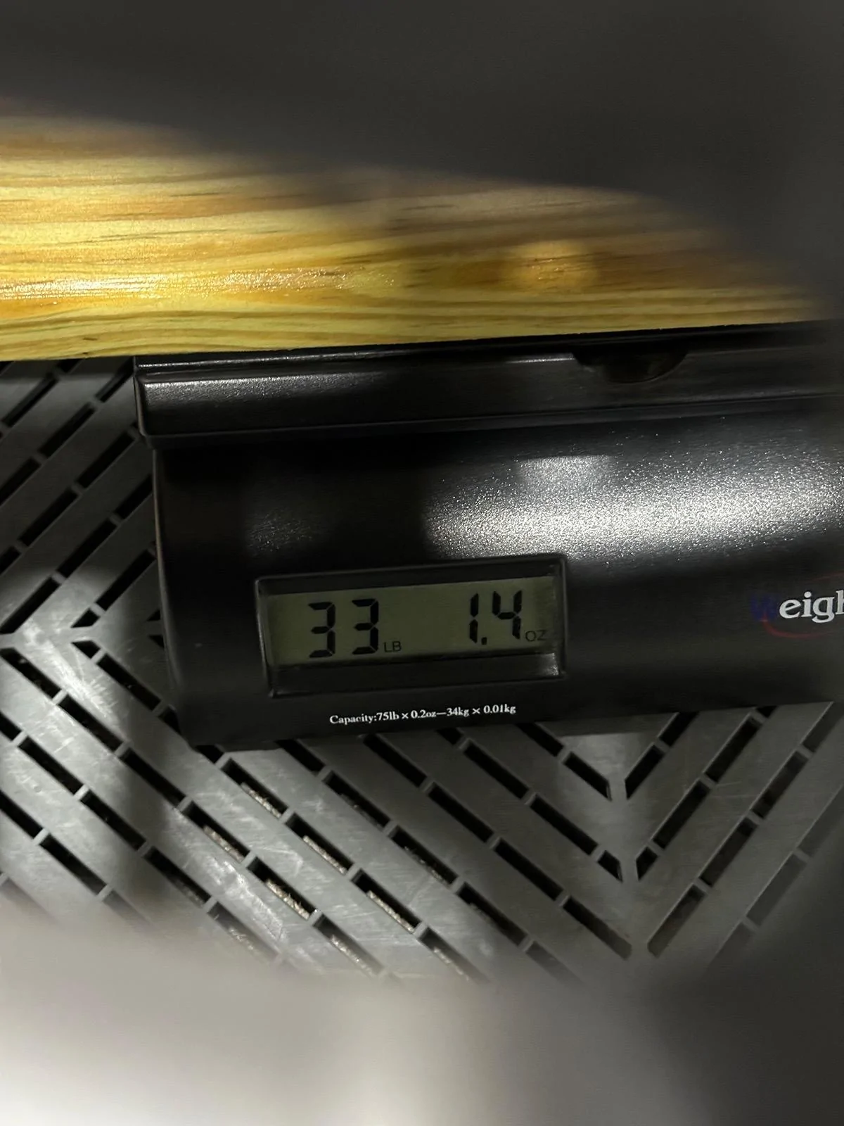

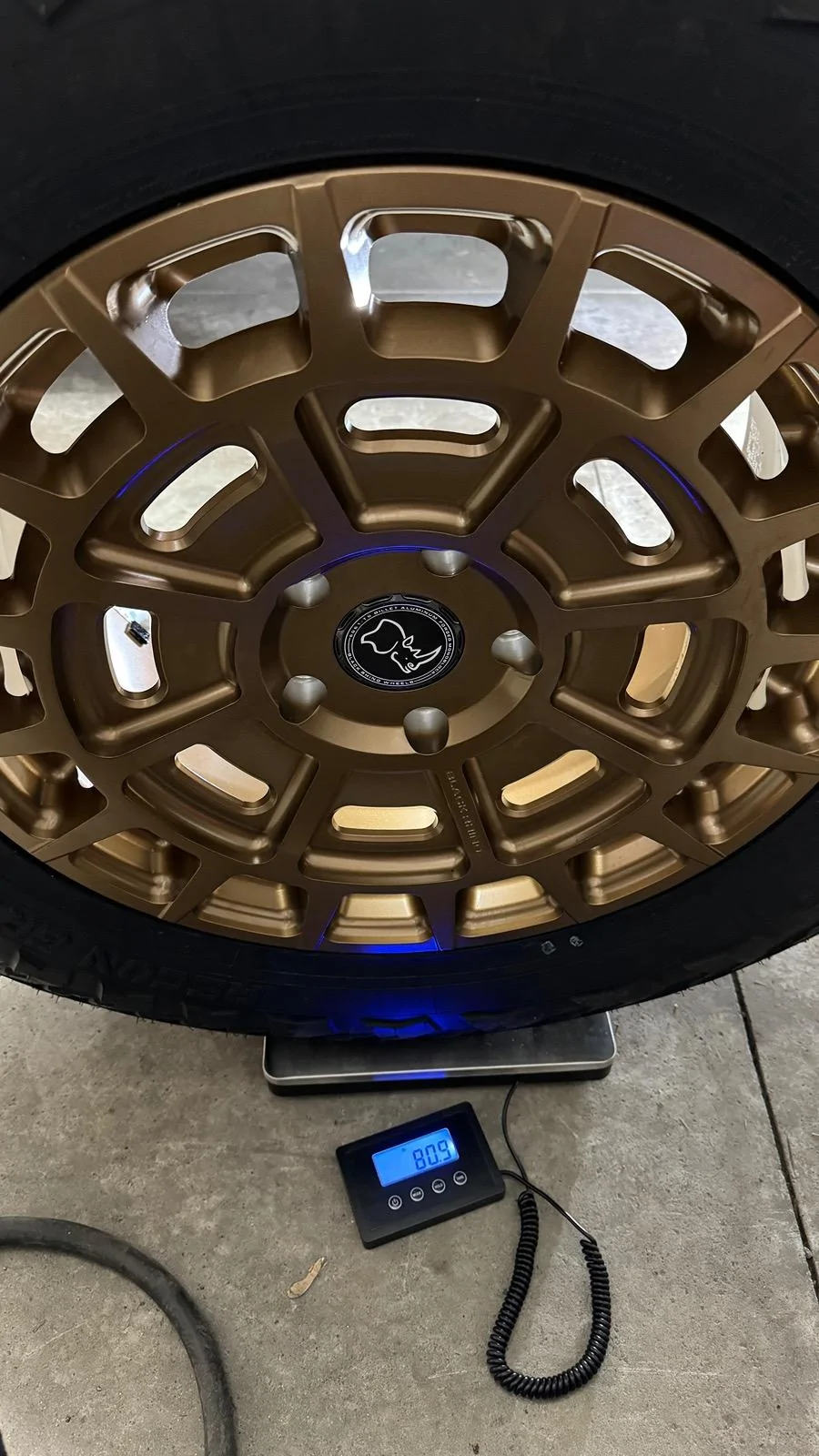

What do the wheels weigh? Let us know how the efficiency does!
DoubleTake
Banned
Anthony
Oct 8, 2023
142
175
New York
2022 Rivian R1T
Military
I didn’t weigh the rim by itself but the combine weight is 81lbs. I posted a image above with them on the scale
