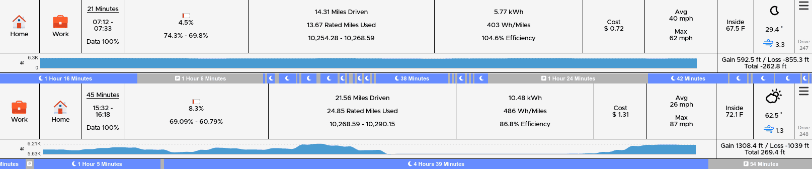

Mine will sleep at home, for the most part. But the extra sensitivity to support the PaaK enhancement away from home is going haywire at the office for me. The top sleep bar is at the office and is constantly waking/sleeping because the truck is "too close" to my desk...which is still probably 75-100 ft away and through several walls. The bottom is at home, which is in the garage, but also almost always plugged in and I have Lock Only enabled.
what app is that?

what app is that?
https://electrafi.com
It's a derivative of TeslaFi which has been around for years now. It tracks a ton of data including location that if you're the tinfoil hat type you won't like it, but I love data...soooo. Efficiency and charging data is the big reason I like it so far. On the off-chance you or someone else sees it and wants to join, here's a referral code: https://www.electrafi.com/signupRivian.php?referred=zefram47
They seem to only hit the Rivian API rather than polling the vehicle directly, so this service isn't contributing to keeping the truck awake. Prior to the 2023.42 update I wasn't seeing this behavior either. If you do use it, I'd recommend creating a new user with Rivian that's authorized on the truck rather than using your primary.
