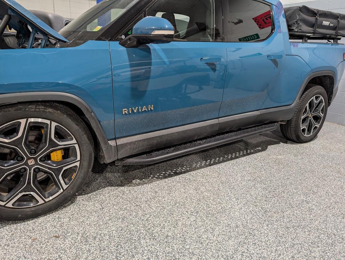

I recently noticed that the front right corner of my Rivian sags... Has anyone else seen this issue?
I had a home visit for noise issue and Rivian guy said he saw fluid leak under compressor attachement. He said this is common and to expect a sag but I have not noticed any. Likely a gasket fail? I have an appointment in couple of weeks. Will update if anything needs repair.

Thanks for all the comments and input folks!
1) I followed the thread which mentioned testing, and double checked that kneel mode is still turned OFF. So the behavior or lowering this much while parked is unexpected.
2) I took the nudge of several suggestions here and called Rivian service... and (mild shock) the first available appointment isn't until March 24, so hopefully it can limp until then.
Until then... Lowrider will be my theme song. ?

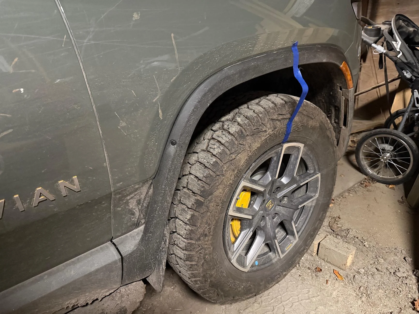

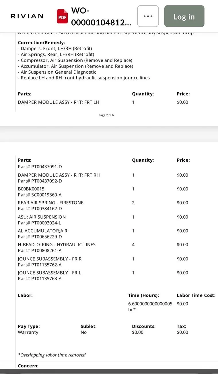

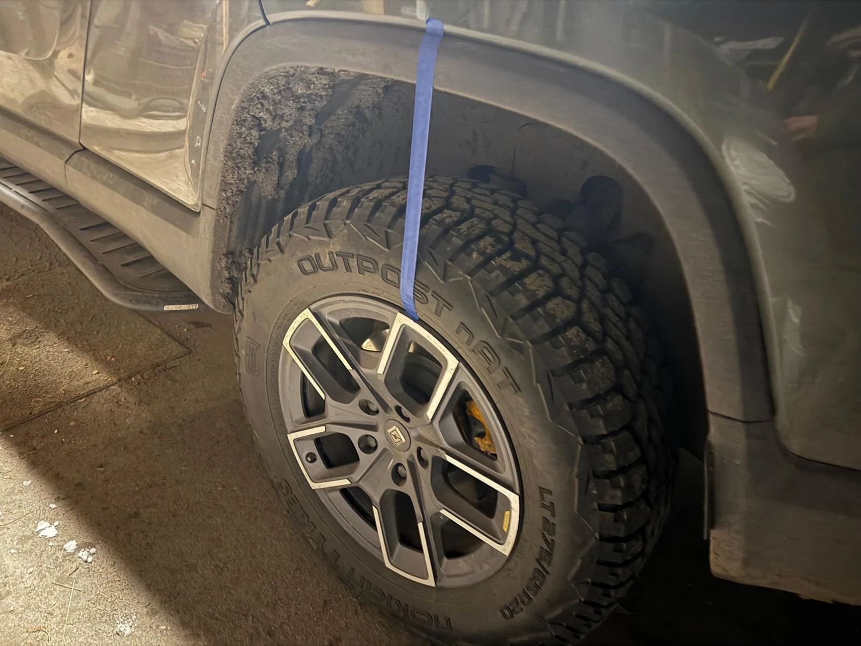

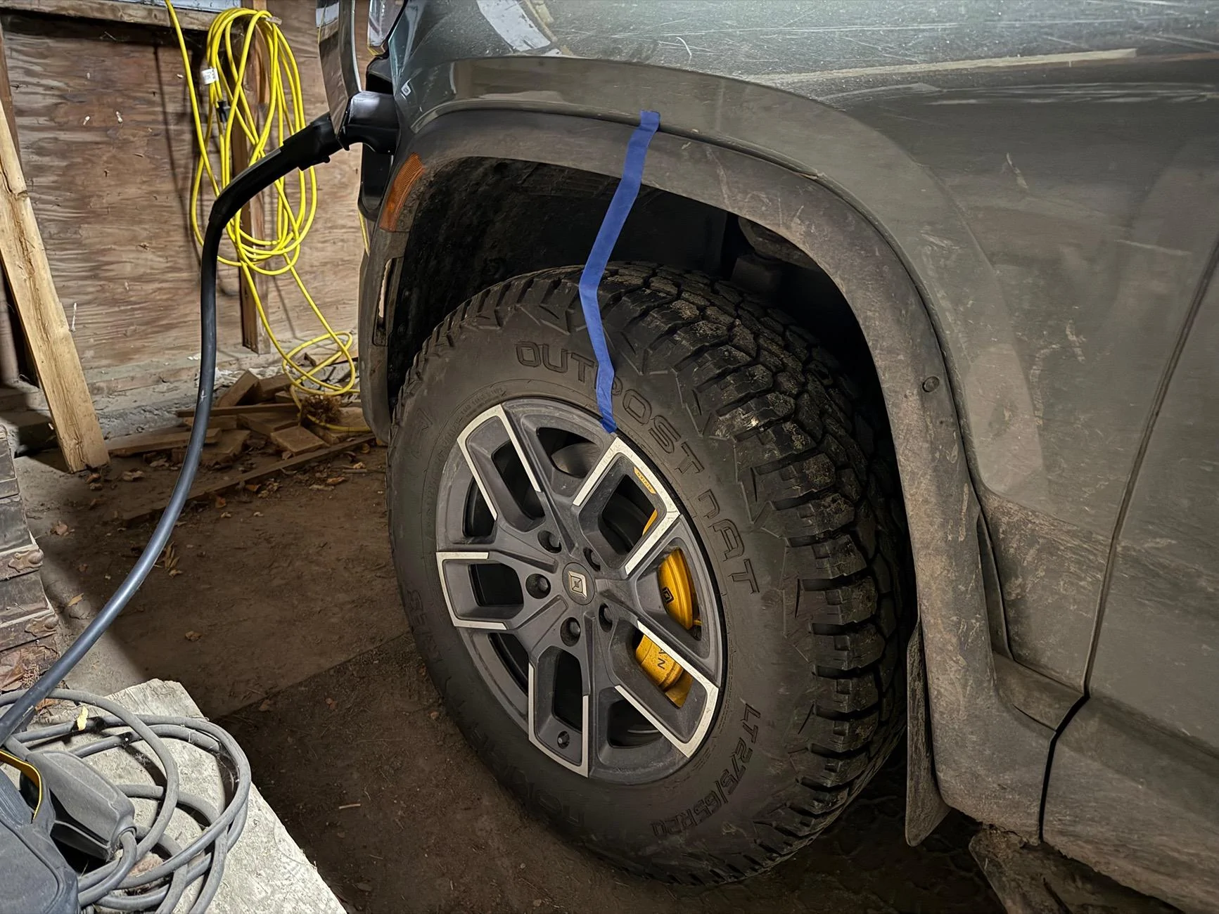

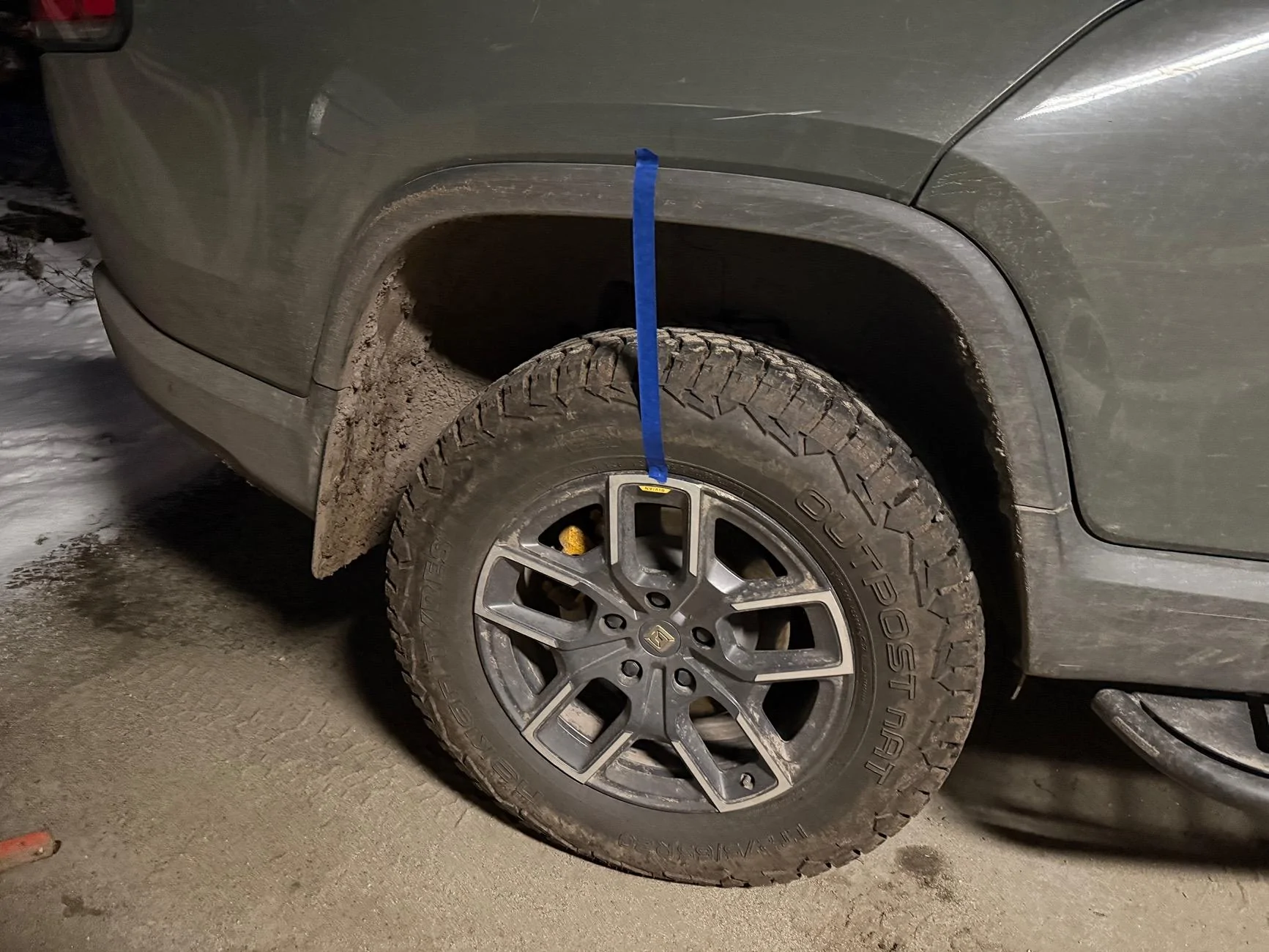

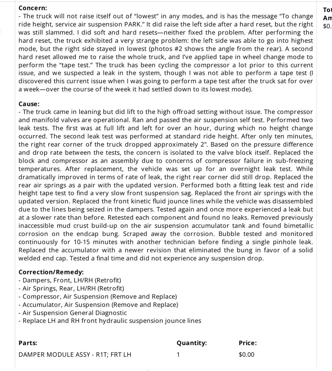

My father’s 2022 Launch R1T (VIN5852) just got back yesterday from the SC for the same issue, though his was bad enough that we would observe it cycling the compressor and adjusting itself multiple times in a 10-15 minute period (if we were near enough to his ā€œsleepingā€ truck to see/hear it).
They first asked us to perform a ā€œtape testā€ which consisted of putting the truck in highest height and wheel change mode (this locks out the suspension in whatever height you’re set at), then tightly stretching tape from the fender trim edge to the tire on all 4 corners, then wait 24 hours to see if the tape was slack anywhere.
Rivian R1T R1S 2023 R1T - Sagging front end? IMG_0857
Rivian R1T R1S 2023 R1T - Sagging front end? IMG_0856
Rivian R1T R1S 2023 R1T - Sagging front end? IMG_0854
Rivian R1T R1S 2023 R1T - Sagging front end? IMG_0855
There was obvious sagging, so they brought it in and replaced almost the entire air system. He just got his truck back yesterday, and so far so good. I’m excited to see if his clunky front suspension has quieted down with the new damper/air-springs—and hoping to find a way to get mine done too to add to my revised rear dampers ?
I’ve noticed my air compressor cycling an awful lot lately, which I was attributing to the cold temps, but mine is also an early build (VIN10264) and I’m going to perform a tape test on mine, because I’m of the notion that especially with the early builds, it’s worth getting any and all warranty work done proactively since they have much improved parts they replace with when issues come up with the suspension and some driveline components (and elsewhere, perhaps, but we’ve mostly experienced it with suspension/deiveline).
The technician wrote up a very detailed report of the diagnostic process that resulted in so many replaced parts, which I appreciate, since it seems that they were very thorough. Hopefully the issue will stay fixed, and the improved parts will be less prone to developing leaks.

Yes - I did get it fixed in warranty. It took a super long time (3+ months) to get into the service center, and the truck was there for about a week. They replaced both front shocks and it has been good since then.
