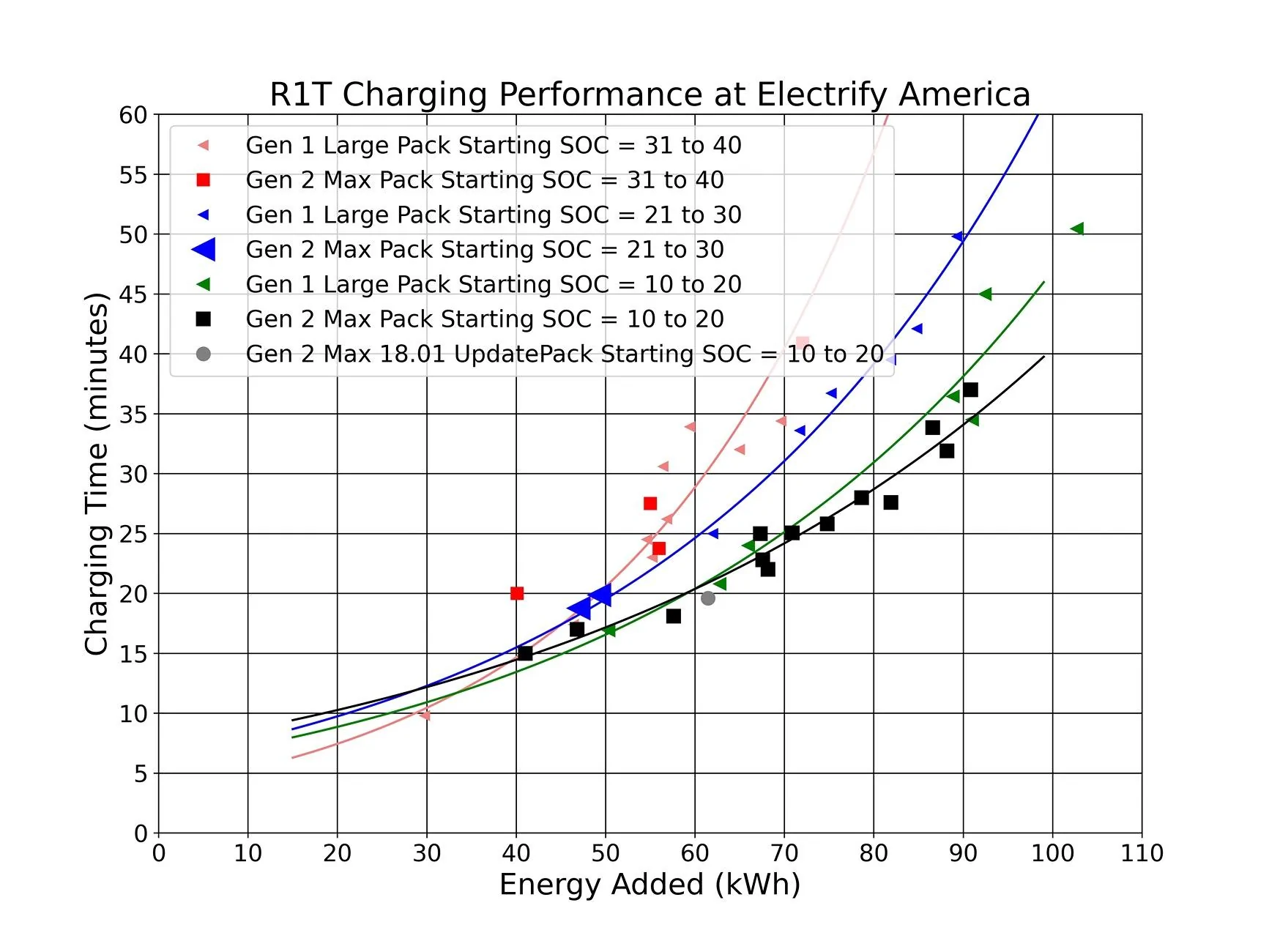

I've had a Gen 1 Large Pack and now a Gen 2 Max Pack R1T. I've recorded all my Electrify America charging sessions over the last 3 years and the data is summaries below. The different lines are for different levels of initial state of charge of the battery. I try to do my charging sessions starting between 10% and 20% state of charge.

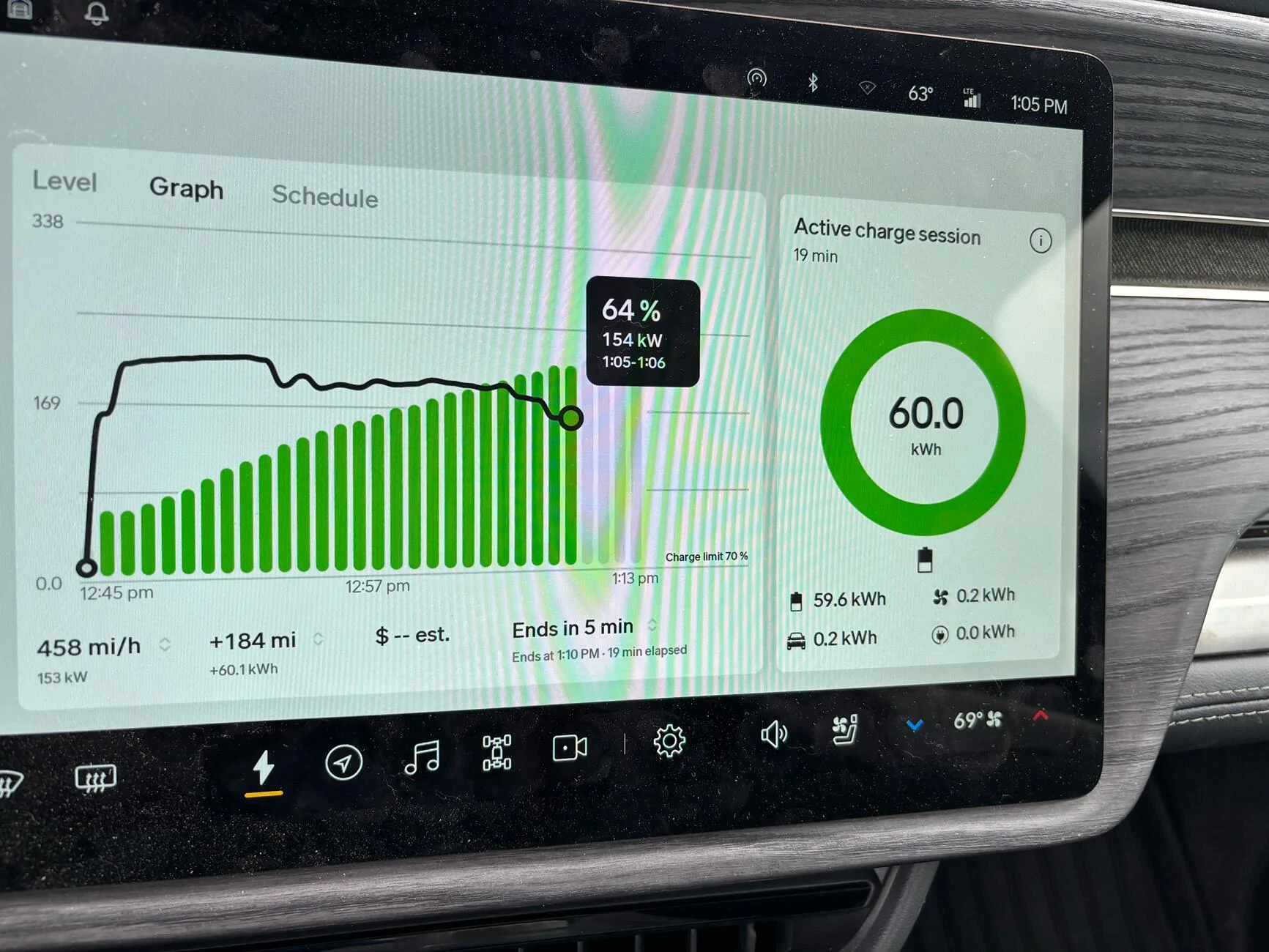

I have one charging session with the latest update which the release notes say have improved fast charging performance. This session was done starting at 20% state of charge with a fully preconditioned battery. I've always seen good charging with the Gen 2 Max pack and this session was similar. About 1 minute faster to onboard 60 kWh of energy. 20 minutes vs ~21 historically. (see grey circle in plot below). Not nothing and I'll take it but not that noteworthy either.
In this session it held at over 200 kW from 20% to about 55% state of charge. Stayed over 175 until about 60% SOC.

Charging curves are one way to quantify charging performance. For me, I like energy added in a given amount of time. That's what's really important. Charging curves don't really capture that for me.

The biggest issue pre update for Max Pack, was it would thermal de-rate too quickly, specifically on deep, high current charges, or back to back DCFC stints. The improvement I think was shown to be 3-6 minutes overall, which isn't insignificant, especially in those repeated charging road trip instances.
Also, in the Outofspec video from the Rivian California office, they showed the Max Pack charging at nearly 50kW mid 90% which is fantastic and opens the vehicle up a bit more for consumers trying to eek out the full capacity of the battery.
