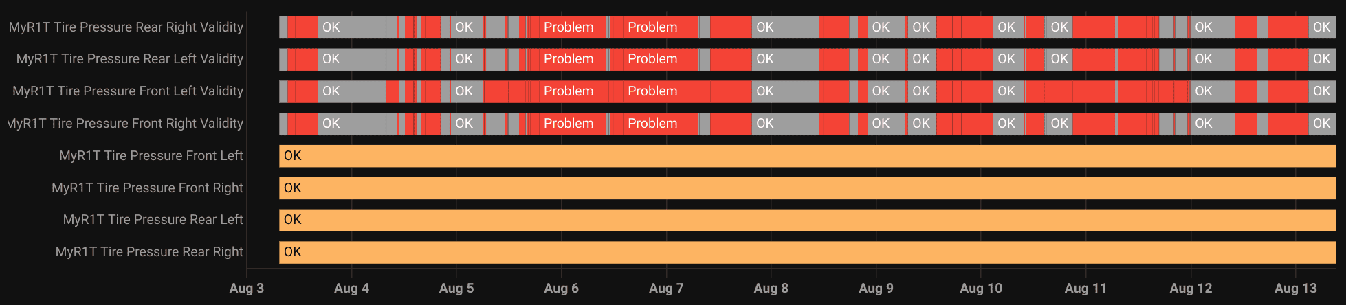

It's been several weeks since I rotated them and they have not re-registered. I'm 100% convinced this is a software issue.
