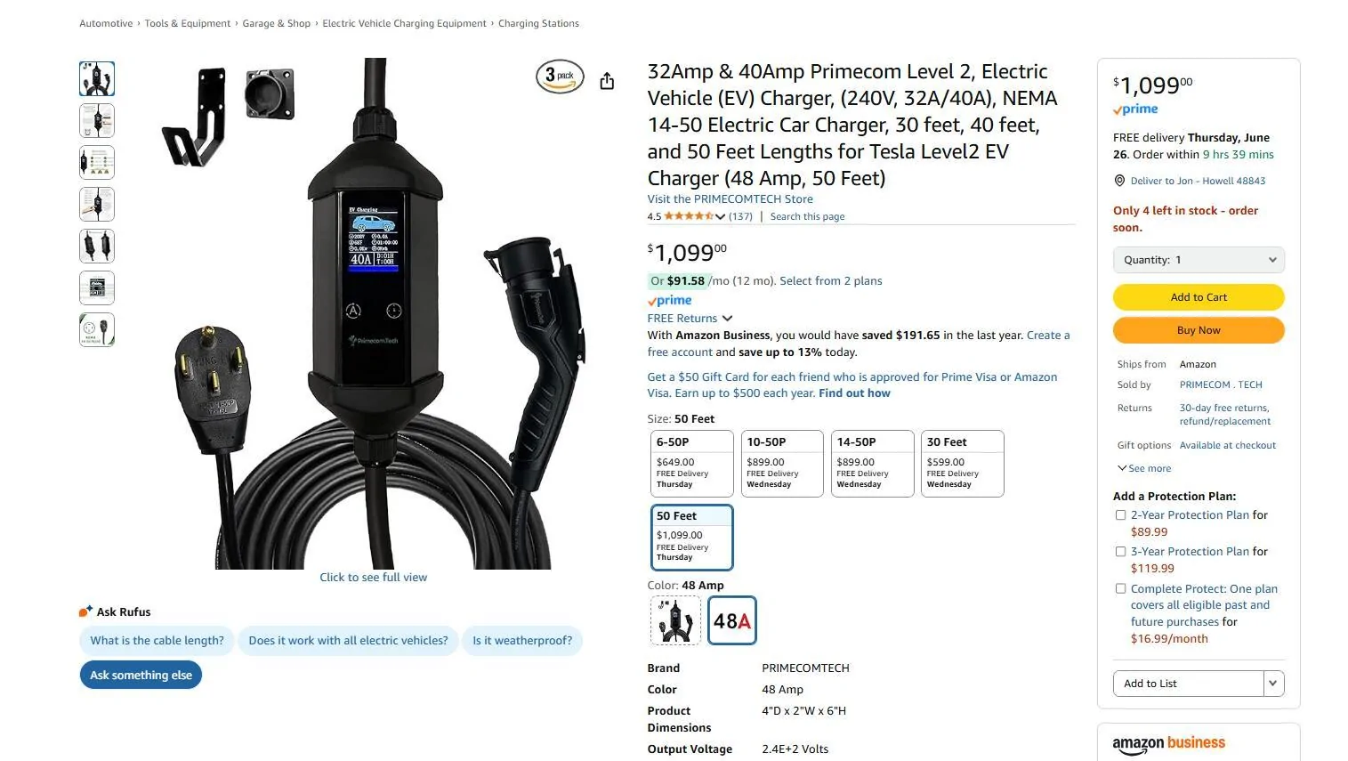

Has anyone located a 50 foot 48 amp charger other than this?
